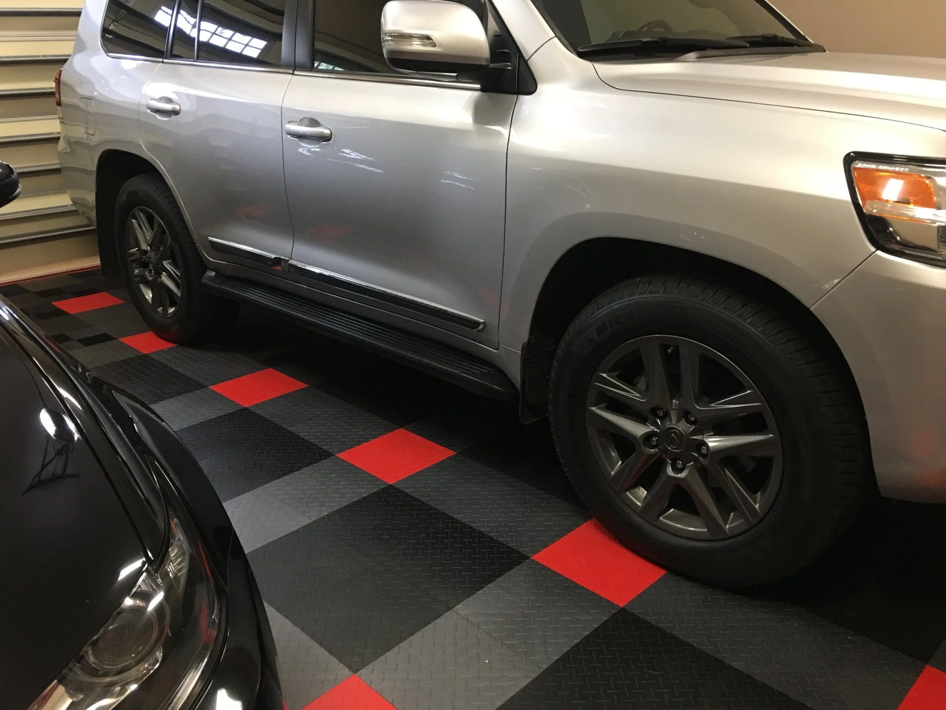

All done. Unbelievable what the difference in LC looks running on 20" wheels with 33" tires. Now it looks proportional. Don't get why Toyota/Lexus put smaller tires either on the 18 or 20 inch wheel.
All done. Unbelievable what the difference in LC looks running on 20" wheels with 30" tires. Now it looks proportional. Don't get why Toyota/Lexus put smaller tires either on the 18 or 20 inch wheel. View attachment 1796813
33" tires - NOT 30" tires, right?
