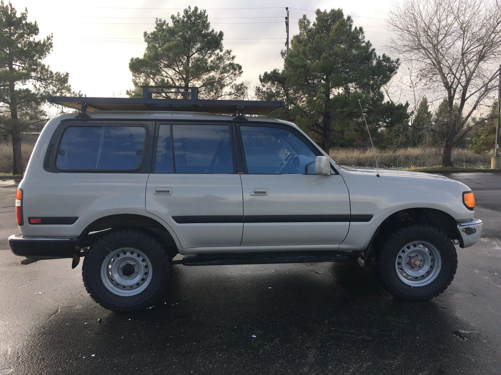

went with the coopers! Thanks guys! Super stoked. Will be taking them off pavement this weekend to grab a load of wood. So far they are super smooth around town and look excellent. Tread is deeeeeep on this tire
