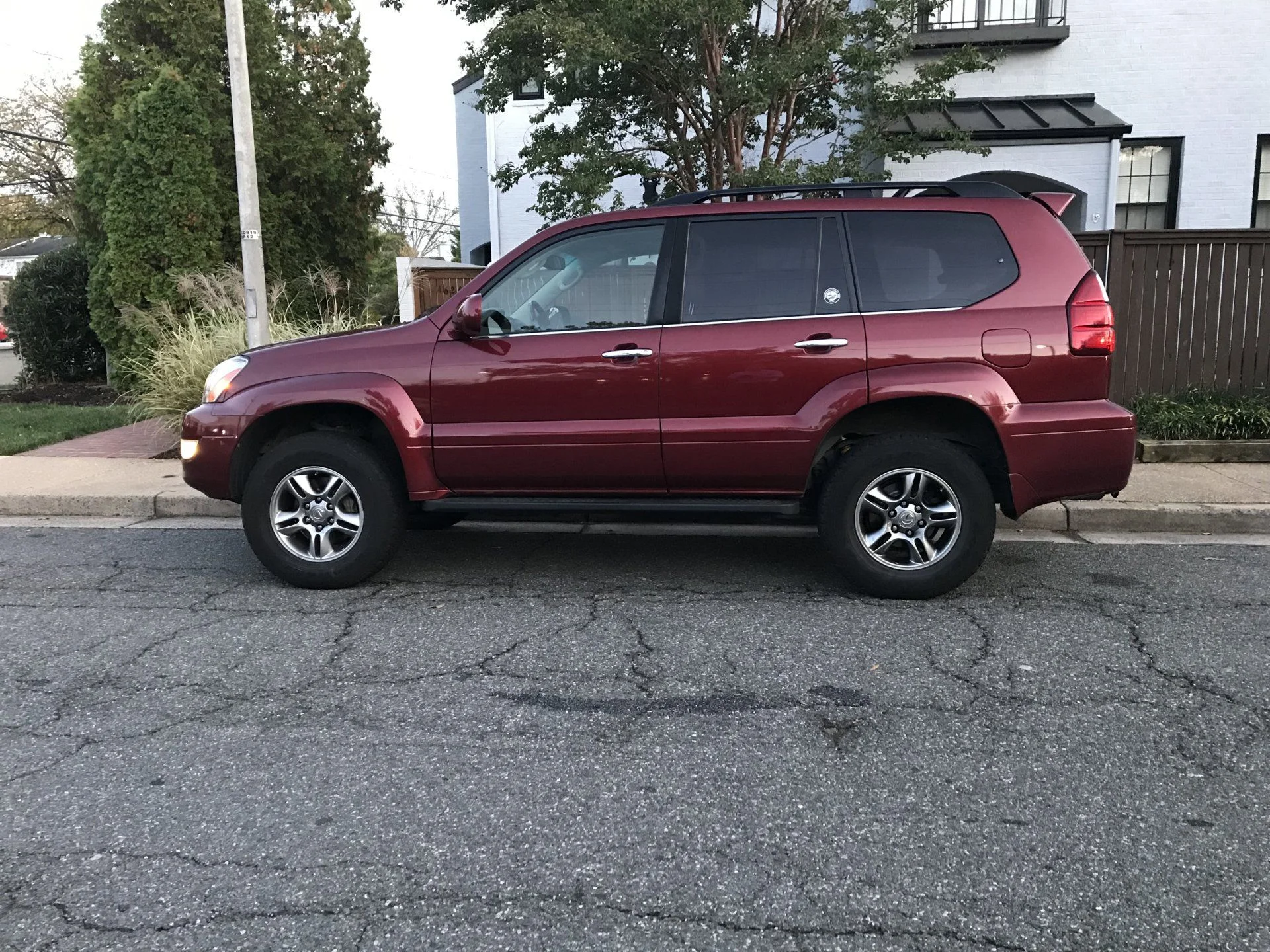

I run 245/75r17 Goodyear Silent Armor. Theyve been awesome in more than 20k miles. Off road parks with other toyotas several times. 20mpg. Awesome in normal mud. Awesome in snow. Awesome on the highway. And $140/tire when I bought them. Perfect without a lift as they are 31.6” so an inch taller than stock
After my 2” lift they look fine but ill be moving to bigger tires soon. I put 255/80r17 km2s on for a day but they were super loud on the highway, kinda bouncy and rubbed the liner a bit.

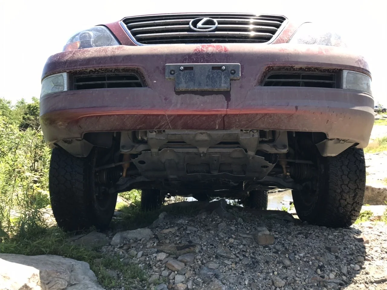

Nice! you wouldn't happen to have a photo if it from the front would you? Have you aired down with 245s? i was looking at 255/75/r17s too but i found a great deal on a set of Cooper S/T Maxx's at around $140 a tire.

Get the coopers at that price. I have aired down to about 20psi and maybe lower and drove all over trails and rocks. Never had any issues.

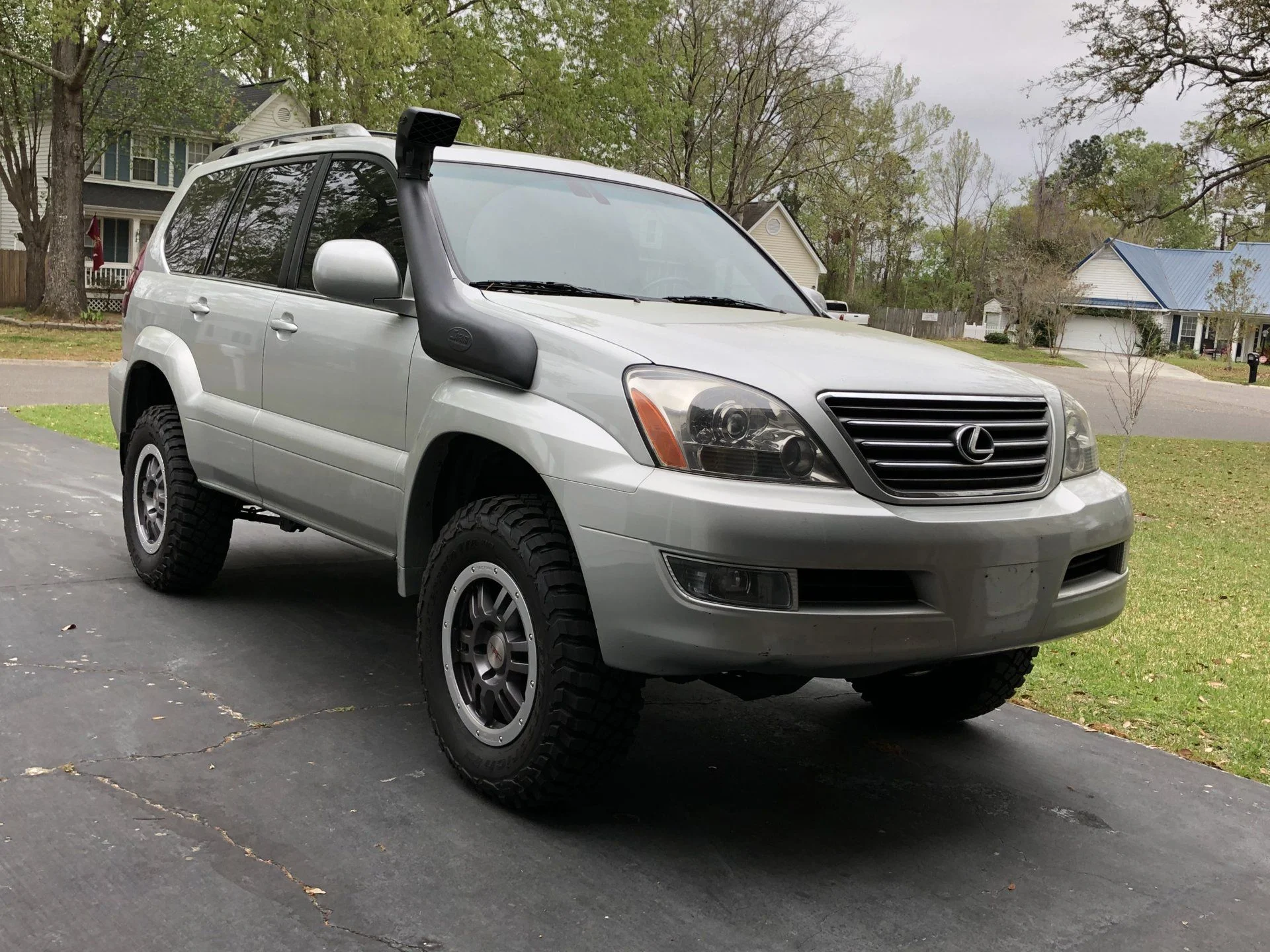

255/75R17 KM3’s, I have an OME medium lift. 17x7.5” wheels with a 6mm offset. Running boards removed and I rub a bit on the inner liner by the front bumper, will massage with a heat gun this weekend.
