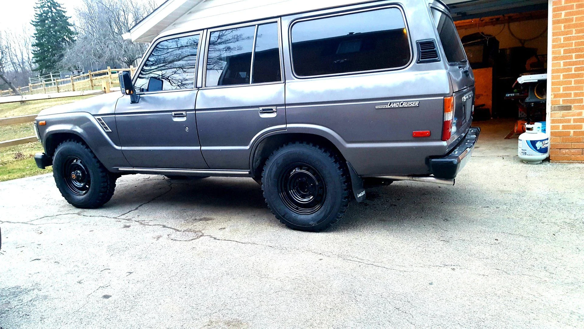

Choosing wheels and tires was a lot more stressful than I thought. Since I'm not really a fan of the 15" stock chromers, I had to make some big decisions. Thanks to mud, I had a lot to go on.

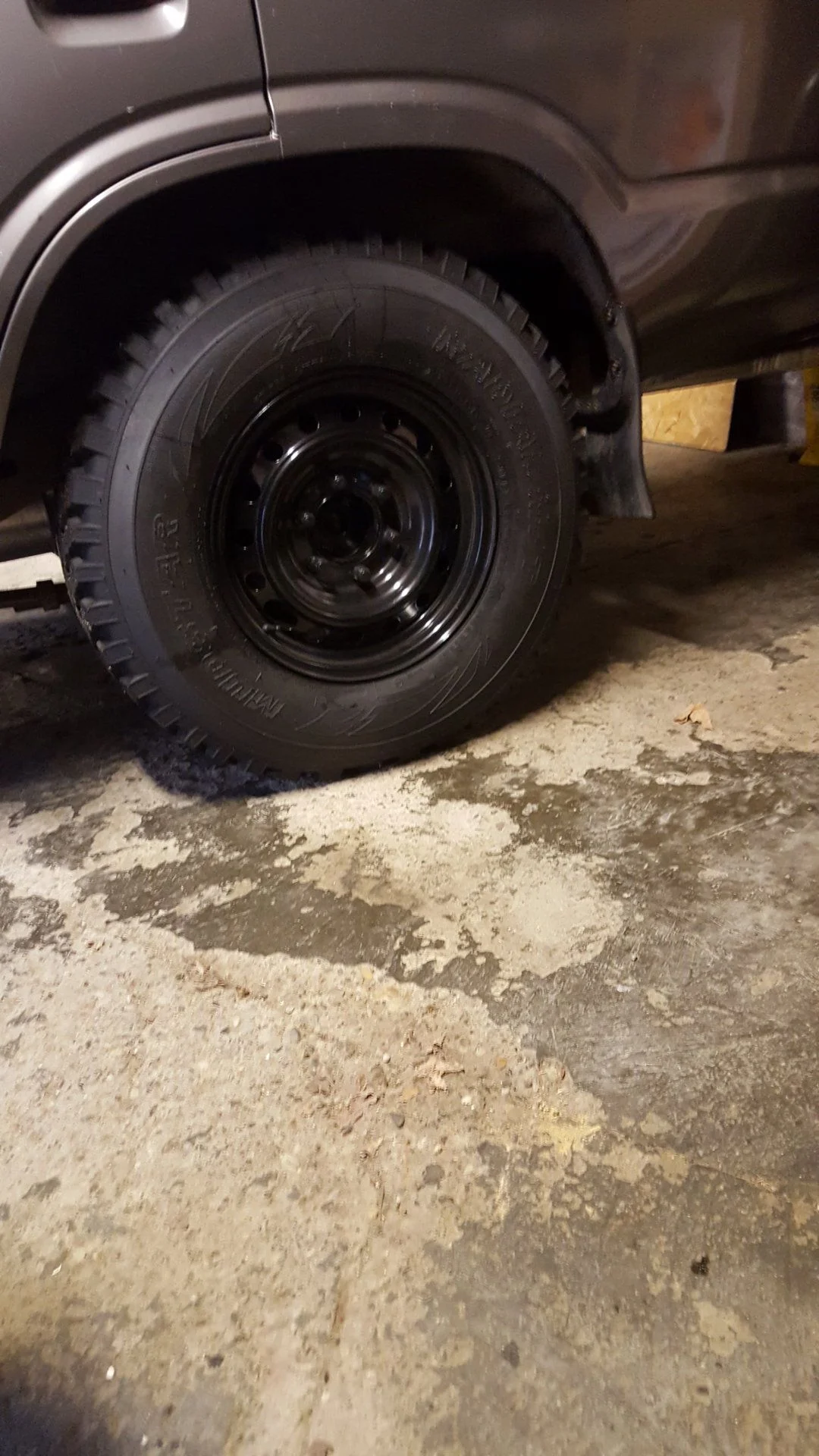

16x7 tacoma steel wheels $221 from Wheels Tires and More.
1.25" spacers $80 (Note: the TRD hub centric spaceres work on the rear but don't fit over the front hubs, have to use none hub centric spacers up front). Torque spacers to 90ftlbs.

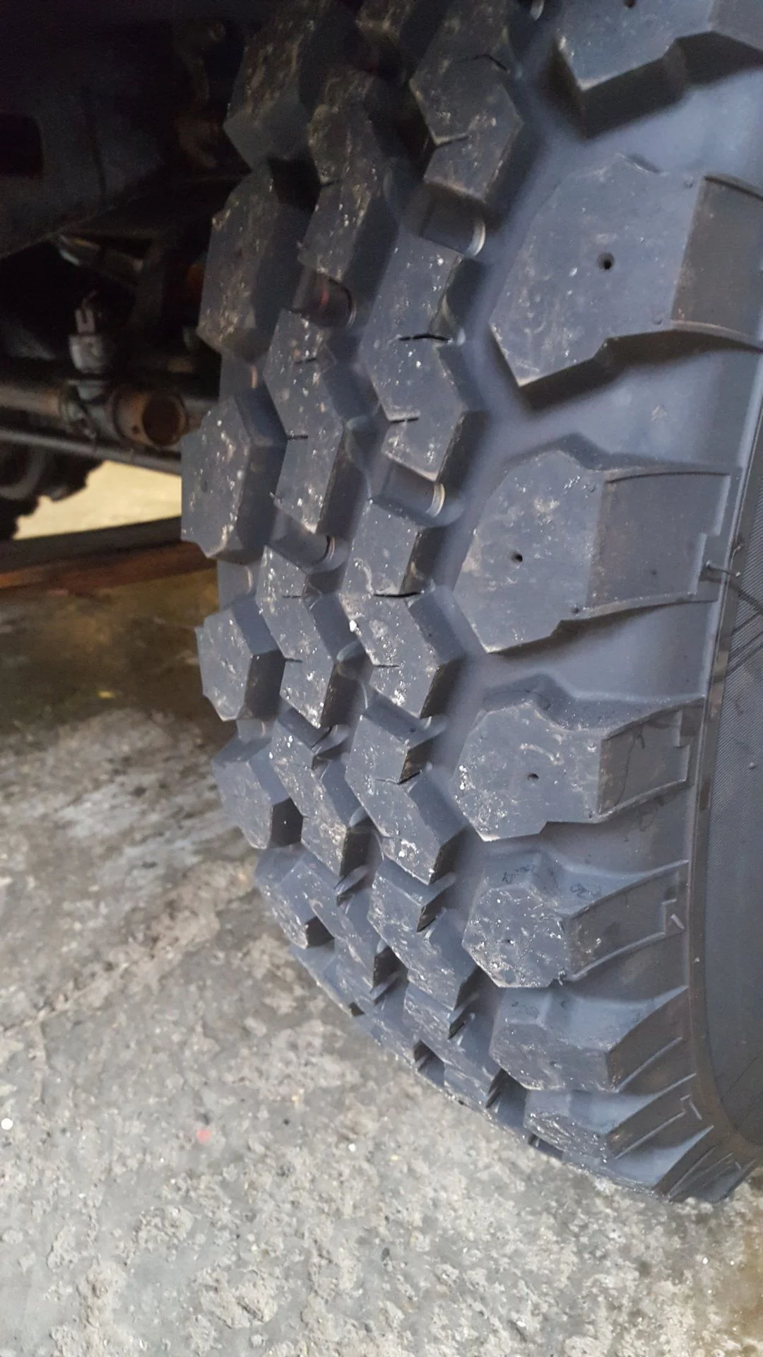

235/85/16 Nankang n889 Mudstar tires $500 from simple tire. gonna try these out, I really love the look of them. I will review these in some time.
Mount and balance $80.
Barely clears the TR but does!

I second narrow. My wife says "looks like a big beast with chicken legs". I do like the tall skinny look on land rovers and 40's, but the 60 has a modern grunt to it that seems to accept fatter tires. Unfortunately, It burns to drop another $700 on tires...so I'll rock these for a while.
On to the tires themselves. The Nankangs are impressive. I took them on a 250 mile highway trip cruising 70-75 and they worked great. Can't hear them at all, but then again the 60 isn't quiet at 70mph. I'm impressed with how well they balanced out. Even with spacers I felt no noticeable vibration. I gotta say, for the price, it's a fantastic mud tire. I like the old school agresive look w/out the ugly sidewalls of moderns mudders. The ride is just fine, I notice no differnece over my A/T tires on the stock 15's. They are set at 38psi which seems perfect.

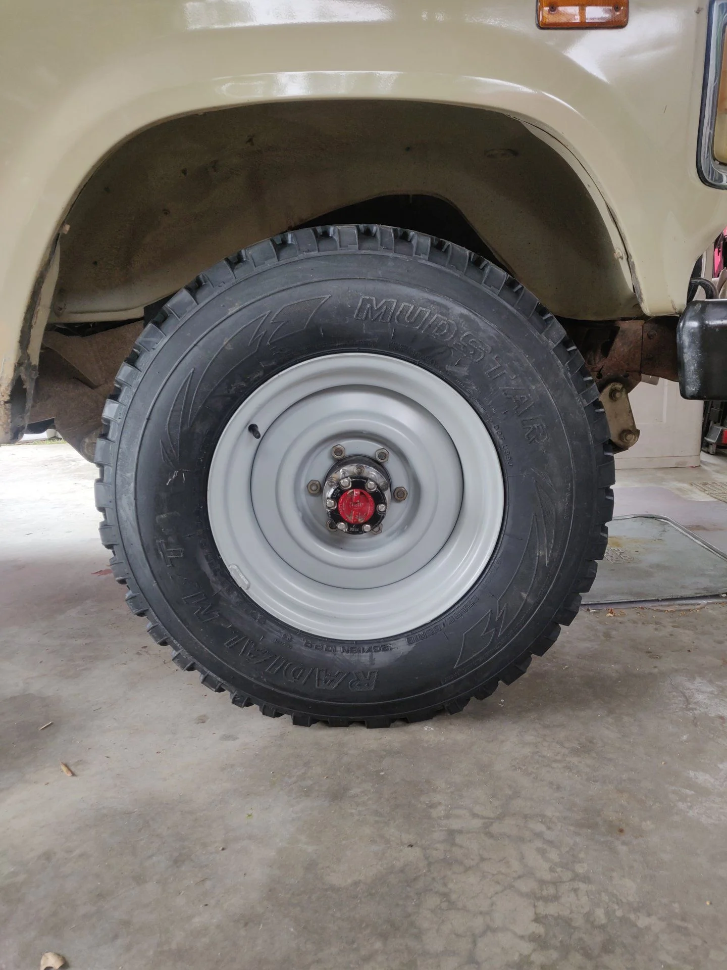

If you wouldn’t mind, could you measure the true height?
They are 10 ply E rated w/3 ply sidewall in this size.
Looks good. Could you measure to the top of the tire, and actual tread width and post the numbers? Just trying to get a real read on their size.
Andrew
Sorry have been meaning to do this. Tread width is 7.5", overall width is 9", height is 31.25" on 16x7 rims @ 38psi.

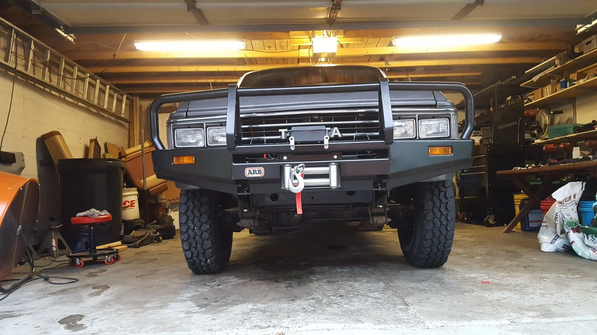

I don't have enough miles too give any fuel economy numbers yet as i have only filled up once. I was running 30x9.5x15 and was getting around 16 on the highway. However, I have added an arb bumper and winch since putting the 235s on and haven't got it running until today (coolant hose replacement). I too like the narrow tires, wife doesn't but it's my cruiser soooo.... 🤗. They have very little road noise considering and seem to be fine at 70mph.

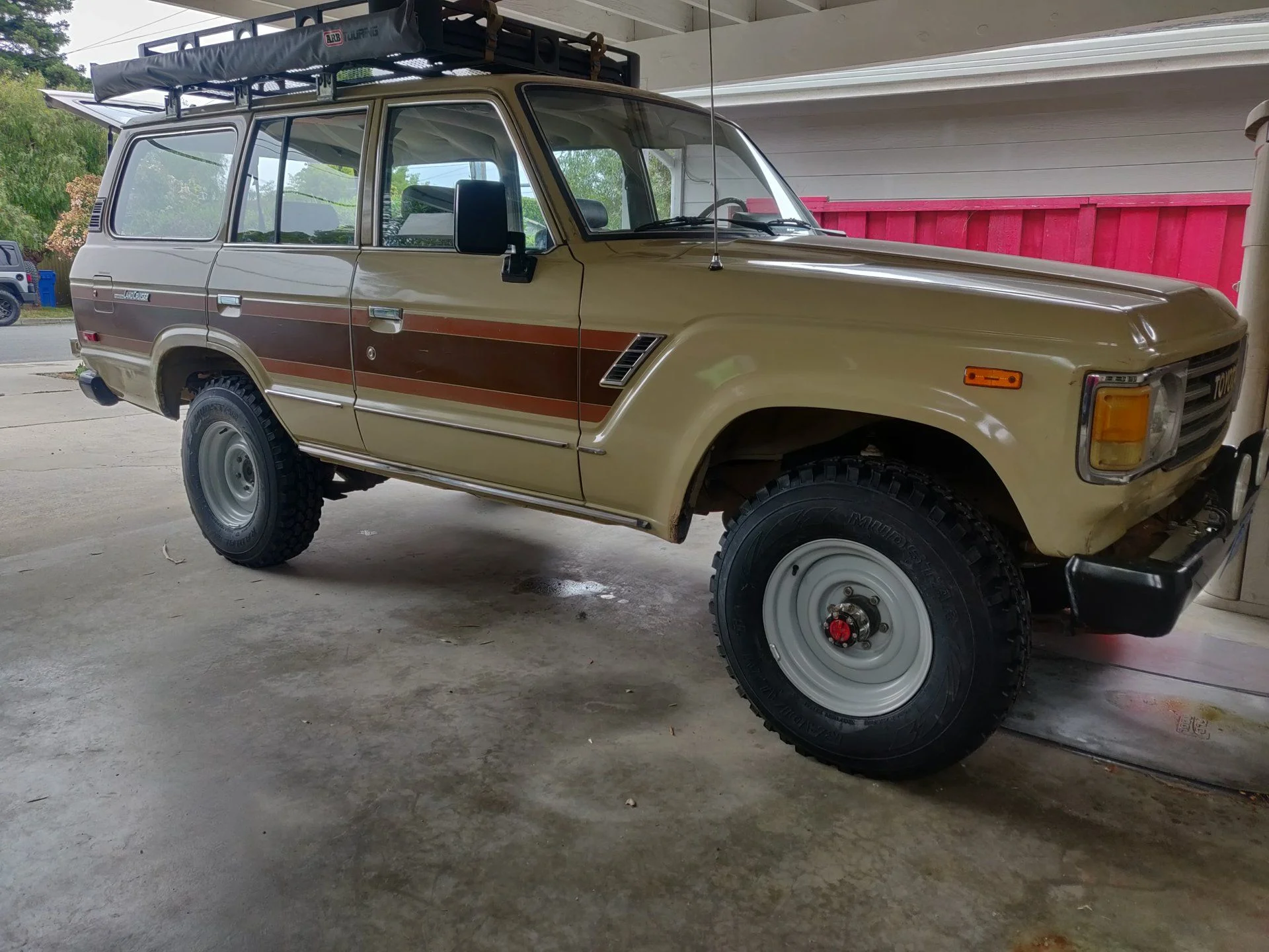

Just this week I said I'd never run 235s on my 62. I may have to eat those words.

I've gotten lots of compliments on the tires and i think they look prefect on the 62, very Australian looking. Mpgs seem to be down, but i don't have any numbers to give. The arb with winch adds at least 200lbs. If i could guess I'd say 11-14 highway. I was running 30x9.5x15 A/T tires before and was getting close to 16.
