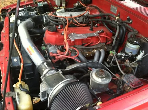

I came across a post were by the OP was offering replacement injectors, most of which were a bit larger for those of us with engine work. The OP is somewhat of an injector specialist, he was even offering to give away sets for testing purposes, anyway I followed his ebay link and ordered up a set in March and finally got around to installing them. The old injectors are 190cc/min and the new ones are 211cc/min. My engine has an engblder head with larger ports and valves as well as an RV cam, also I installed an LCE high flow intake tube with K&N filter. I'm curious to see what gains I will get out of these injectors and if my MPGs go down.
The guys eBay name is Injectordyne, the injectors were $130.00 free shipping.
So a little update on these injectors.... I just returned from GA, 1022 mile round trip driving between 65-70 MPH, I got 20-21MPG, it would seem that milage has Not suffered since upgrading to larger injectors. Really I can't say that I notice much of a gain in performance but I couldn't help but think that with the added air getting to the engine that I may be running a bit lean, and hell for $130.00 I figured why not. image-4274988718.webp
Those are getting some mixed reviews, some say they run really rich, to the point the computer can't adjust correctly. Glad yours are working out...
Wow, nice to know, the last time I looked at my plugs there was no sign of burning rich and like I said I'm getting 20-21 MPG on the highway. I know some of the large injectors he sold seemed to be too large.
