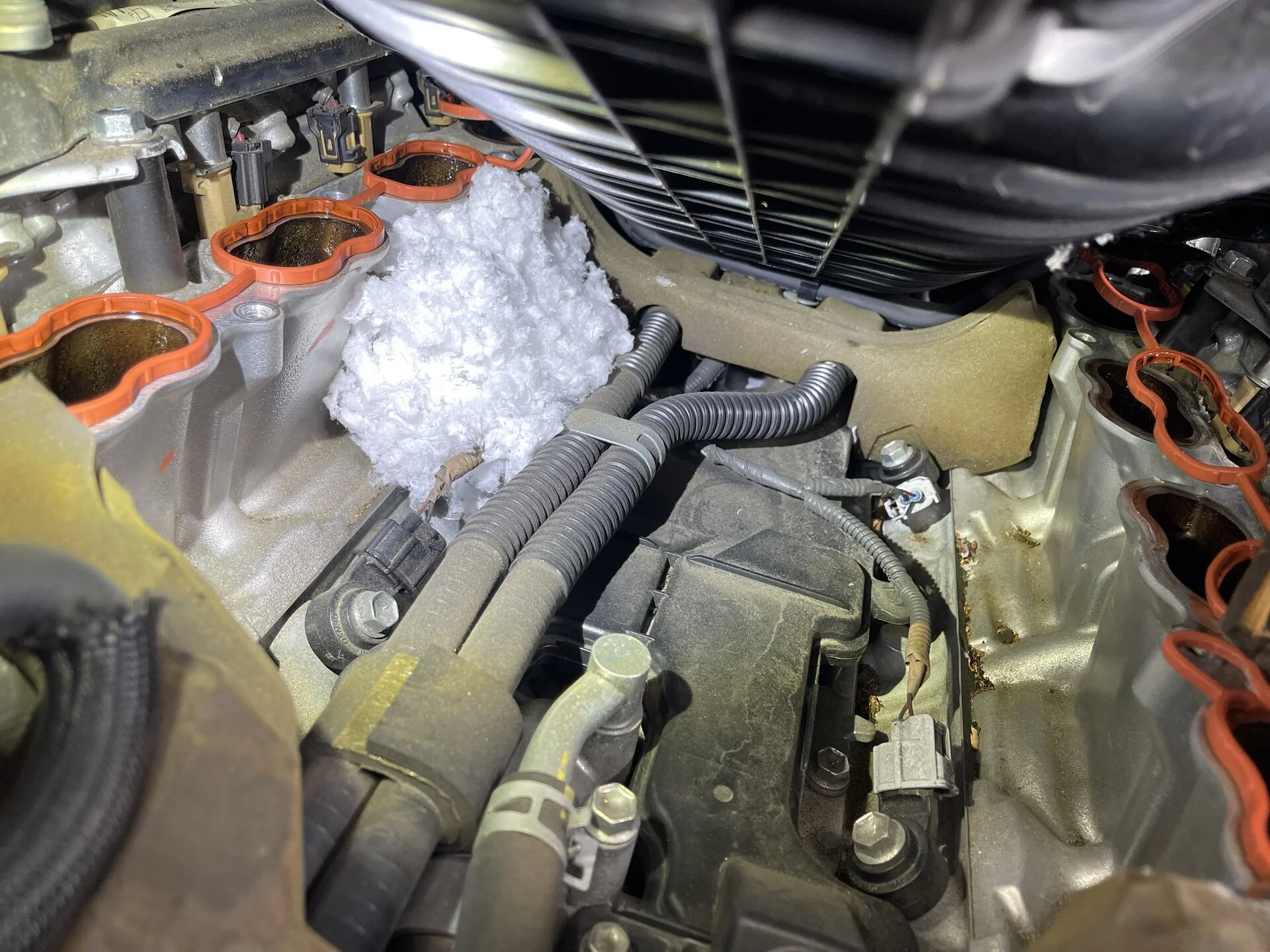

This morning the dash lit up with check engine and reduced engine power light. It also lit up the Trac Off light. I had the truck (17 LC) towed to dealer this afternoon and service rep from his initial assessment told it was with knockout sensors or wiring around/in the manifold. Technician looked at it and said he sees a rodent nest and wiring is chewed underneath the manifold. They have quoted me $988 ( 🙁 ) for the work as it will take 5 hrs to remove the manifold, access and replace the wiring. As an afterthought, I don’t know how he was able to spot the nest if he had not already taken off the manifold. The issue was communicated to me before I left and dealership and my stay didn’t really span 5 hrs.
I have asked for pics of nesting as it won’t be covered by the extended warrant from Toyota. Anything you guys want me to check with them or ask them to make sure that fix is proper? Thanks 🙏

All I can say is that mine was about 3 hours and the detailed work order listed most of that time as cleaning out the nest. My dealer usually estimates this kind of stuff a bit high then gives me actual labor time. For something like this I don't think any book tells them how long it takes to clean mouse poop.
Some pics of rodent mess and chewed wiring.
Oh damn! Do you park outside?
Ugh what a bummer. Glad mine fits in the garage!
