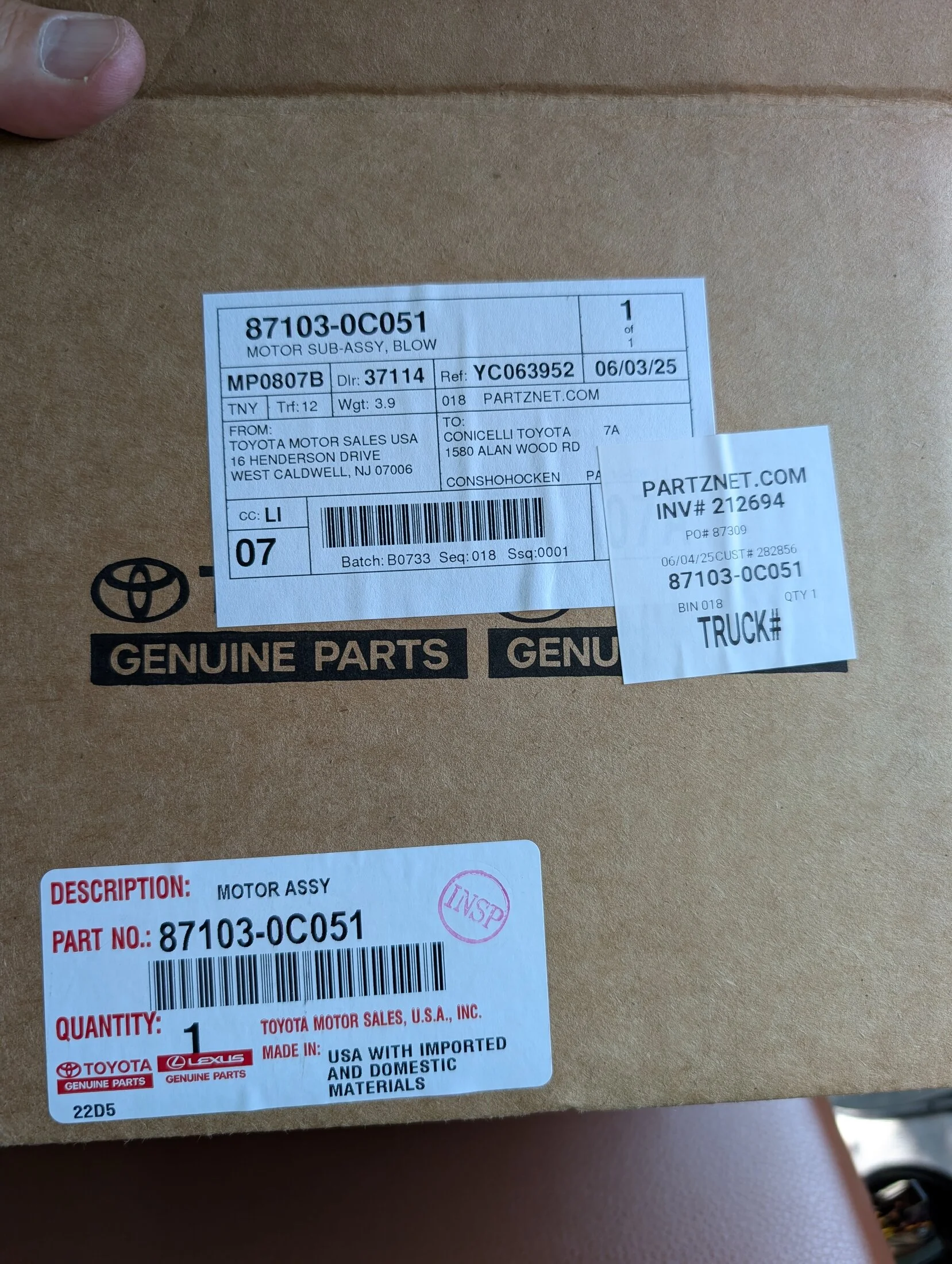

I ordered a new blower motor from conicelli Toyota. Should be here in the next couple days. I'll report back my findings
Roughly 30 minutes, an 8mm socket with 3" extension, a medium flathead, a flashlight and a new OEM Toyota blower motor pn 87103-0c051 and the issue is remedied. One 🍌 on the difficulty scale.
I purchased online from conicelli Toyota in conshohocken, easy and relatively inexpensive. Shipped to my house within a couple days of ordering.
