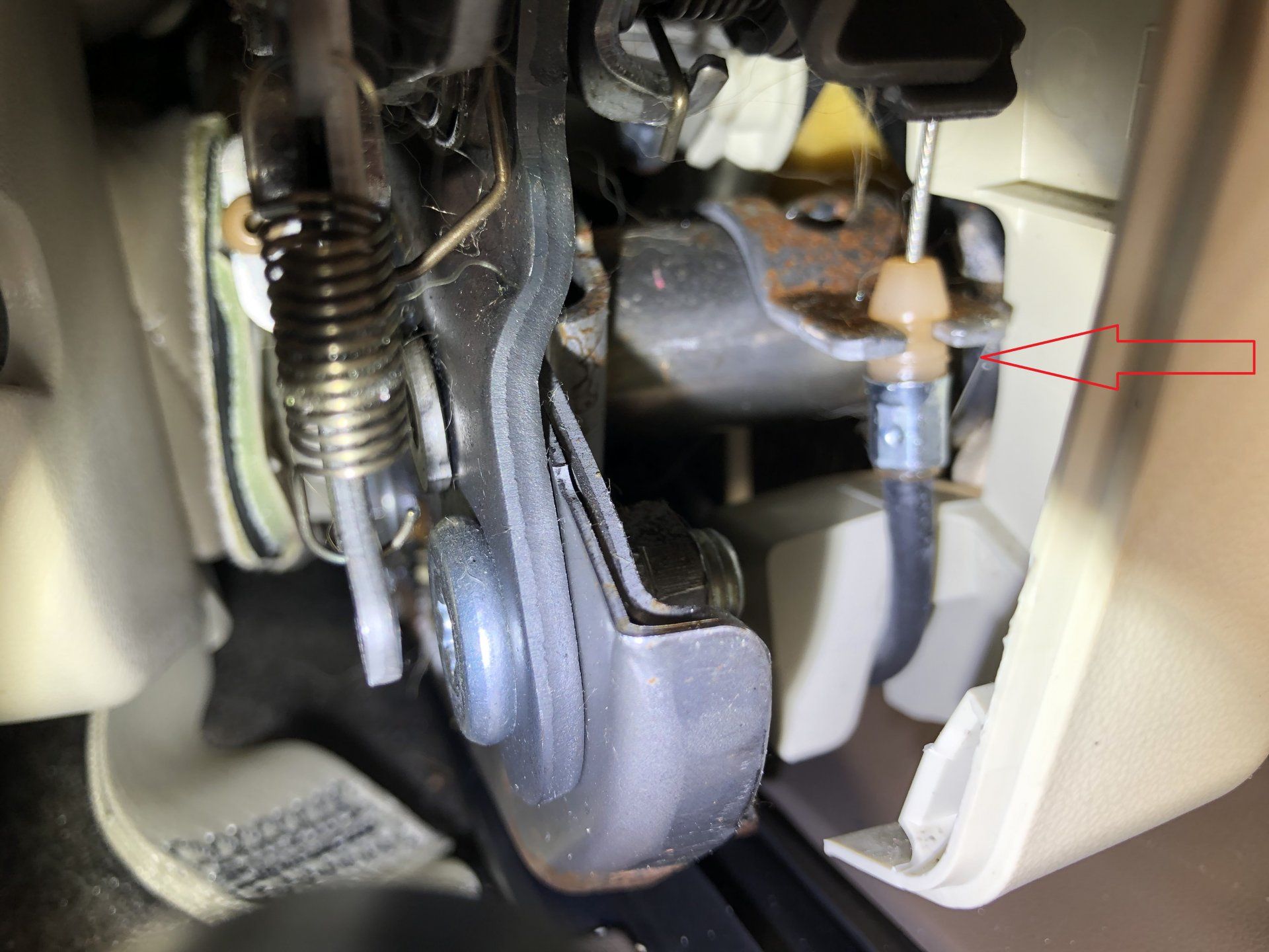

It is not difficult to fix the problem as just following the attached photos.
