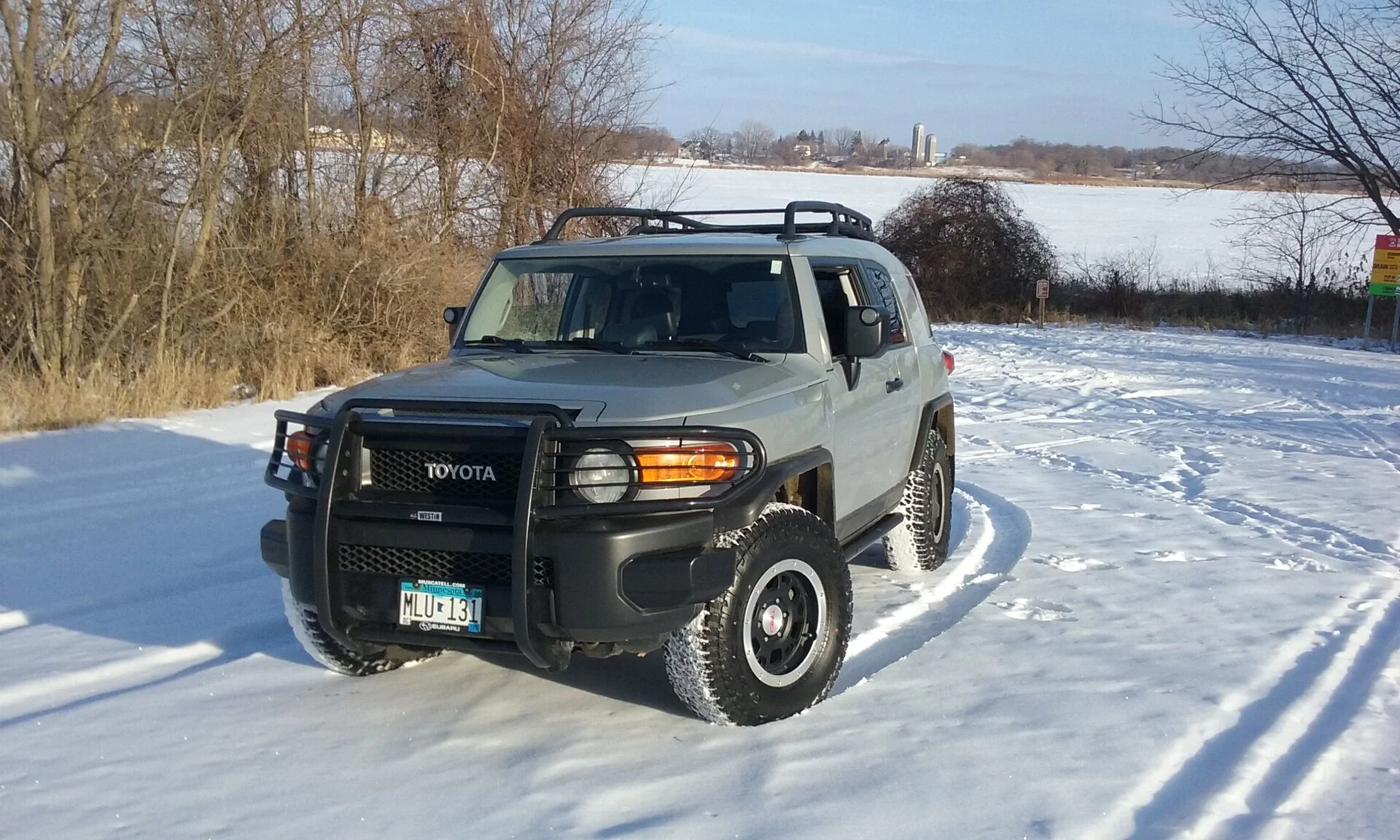

Hello, My bro has a nice 2013 FJ Trail Teams and recently purchased a small camper.
He is looking for standard / stock height REAR springs, but a higher spring rate.
I think these Dobinsons will work, any other ideas?
