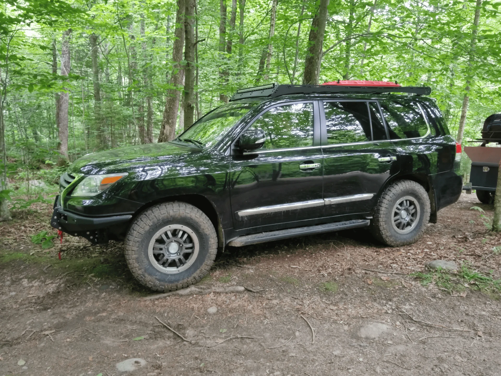

We were on a group ride yesterday and the AHC system on my 13 LX decided to go into low height and not come out. Leaving the vehicle off for 5 minutes seemed to get the pump working again and it returned to normal height. Picture above is with the rig in normal height.

Flash forward a month and I mounted a set of RW with 34" Ridge Grapplers. Naturally I wanted to see the truck in its highest suspension setting. Move the switch up and the rear raises first and then the front raises - cool. I get out of the vehicle to take a look and sure enough the front looks like it's in normal height and the rear looks like it's in high. Weird. So window open and door closed I cycle the system again this time using a broom handle from outside the truck so i can see it raise in real time. Sure enough the truck raises from N to H but once it reaches its max height in the front it dips back down to N height while the rear remains in the H setting. FWIW I did a sensor lift on the vehicle on the recommendation of many of you here. No errors on dash.

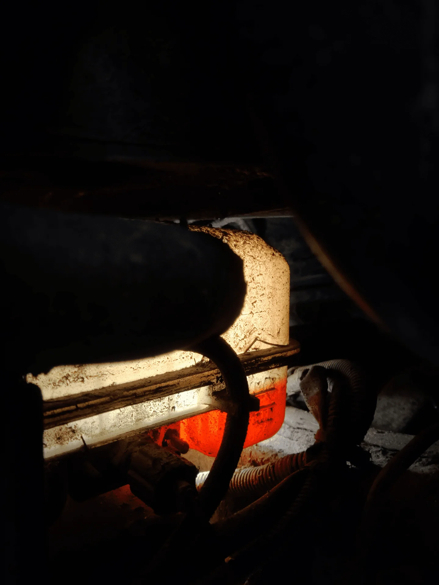

First place I look is the AHC tank (behind the RR fender liner for those who don't know) to see if there was fluid. It was low so I added some more and bled the system. No change. Couple of weeks later same issue going into High decided to bleed the system again, lots of air bubbles come out, then clean pink fluid - no change.

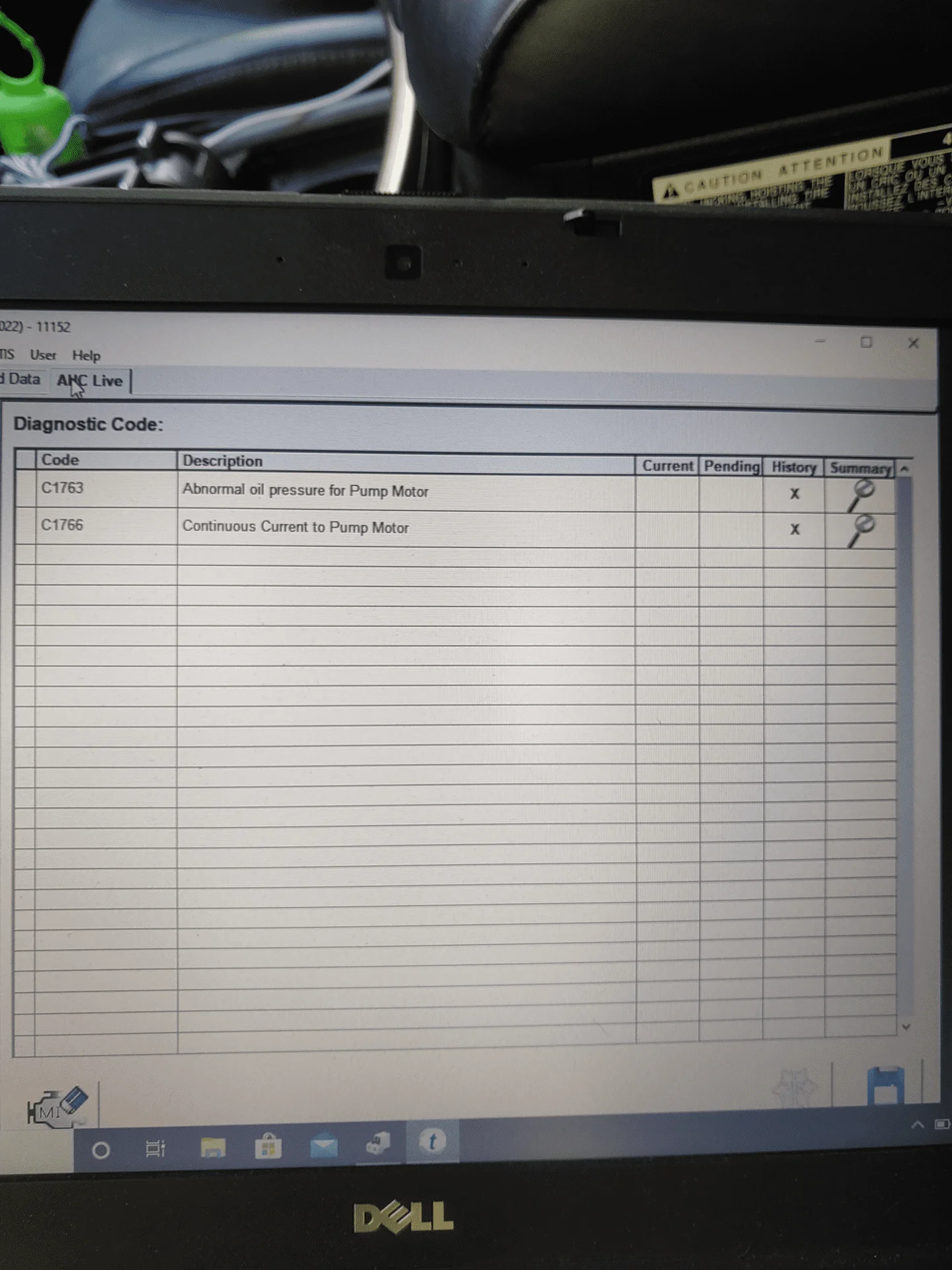

Once we get home I break out my Jolly Roger copy of techstream for the first time and connect the vehicle to try to see what's going on. Codes below are what showed up - notice nothing current and nothing pending. Only time I saw the AHC light on the dash was when I flushed the fluid and did the globes and it went away quickly so I'm wondering if those are the stored codes? The real kick in the balls is the software kept crashing when I attempted to run the various AHC tests - I guess you get what you pay for haha.

How much fluid were you low?
Sorry for all the questions but trying to isolate where the problem may lie. Truck looks great btw.
What's your fluid level at normal height?

One of your codes is common with low fluid. Could also be your pump. Any strange sounds when it's running?
I am maxed out in front and 3/4 maxed in the rear on the sensor lift. I do not know how much it weighs but my guess would be 6500 if stock truck is 6000lbs (we deleted the third row and 2nd row two person bench but added single drawer, sliders, winch, Aluminum bumper, rack, etc.) Fluid was just below the fill line. Thanks for your help!

Could be your pump based on those codes.
2150 lumens behind it shows it's right on the max line in normal height

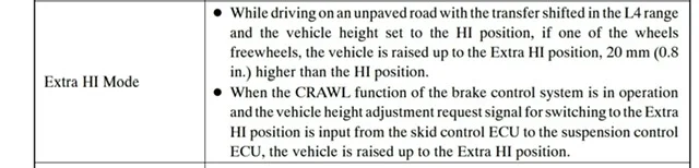

4lo automatically puts the truck in xhigh. So that is the issue, as you can’t sustain H right now. You are overlifted as indicated above, and possibly there is a pump pressure issue too.
34”‘shouldn’t require much if any sensor lift, So as suggested back that off to as little as possible, zero would be where I’d start.
Verify at that setting you can get into and sustain h and xH (4lo).
i think you have to be in 4Lo AND have a wheel off the ground.

i think you have to be in 4Lo AND have a wheel off the ground :squint:
Have to go look at the flow chart again but I think it’s under 19 mph and in 4lo.
