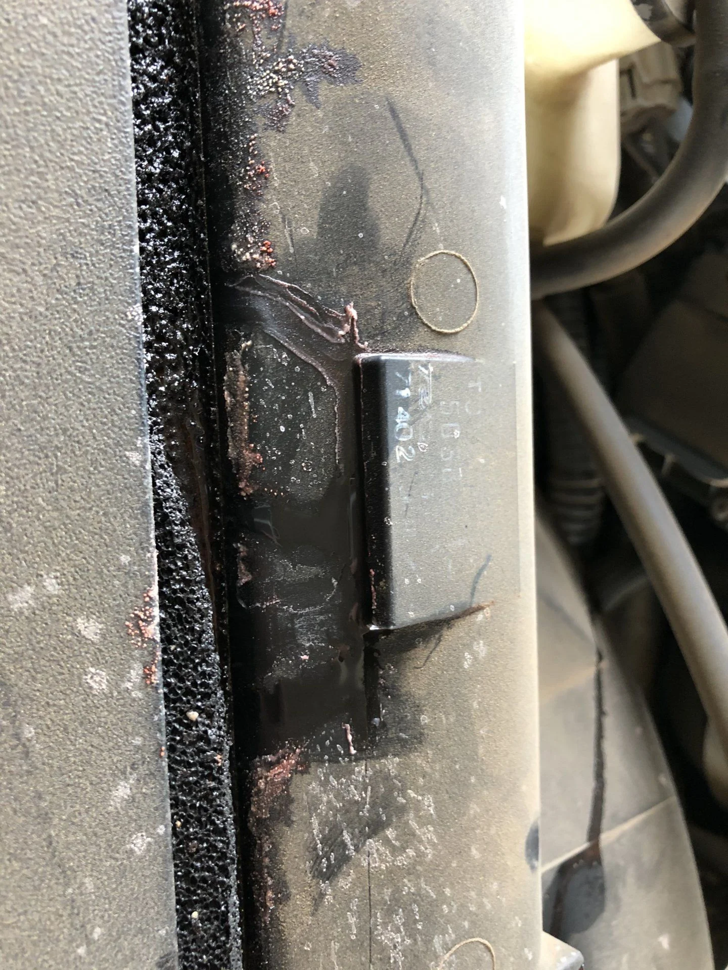

My radiator just busted and I'm posting to get some guidance. My 2013 LC has 107k miles, I purchased it CPO, and at the time I also purchased the Toyota certified Platinum warranty which should have me covered for the radiator repair as it goes though 131k miles and July 2022. At least, I hope it does.

radiator picture:

I'm not really happy about our radiators only lasting a hundred thousand miles or so..I'm at that point as well. First thing I'm going to do is find out if there's a better alternative as far as radiators go. Back in the day you could get a good Copper Brass combo radiator that would last for a long time and you could have it repaired if need be apparently those days are over so we're left to deal with plastic tanks and aluminum... same thing happened recently with my Excursion but I bought an aftermarket radiator that does not have plastic tanks on it .. I don't know if there's anything available for the Land Cruiser but I'll be looking
Nothing for a 200 series. Not in Japan, not in Australia, not in South Africa, not here. This is a complaint that a lot of gear heads have no matter the vehicles make or model. Copper/Brass is expensive. It is heavy. Plastic/aluminum is cheap, light weight, runs at a higher pressure so less fluid is needed = less weight. Less fluid is less weight which means better fuel efficiency. And the materials are cheaper. So every manufacturer just switched over to plastic on the outside aluminum on the inside. They all know that this combo will break sooner than a copper/brass. The engine designs are for a thin plastic radiator in modern vehicles. Even if you want to make an all metal radiator the space inside is not there for the size it would have to be for equal cooling efficiency.
2013 damn, I thought this was more of an issue on 2008-2010...I guess not. I inspected my radiator (2011 LX with 105k miles) no sign of cracking in that area yet.

I have a 2013 lx at 86 k miles. I purchased the lx with the hairline crack. The ppi at a toyota dealership didn't see it. I couldn't tell till I posted photos here.
