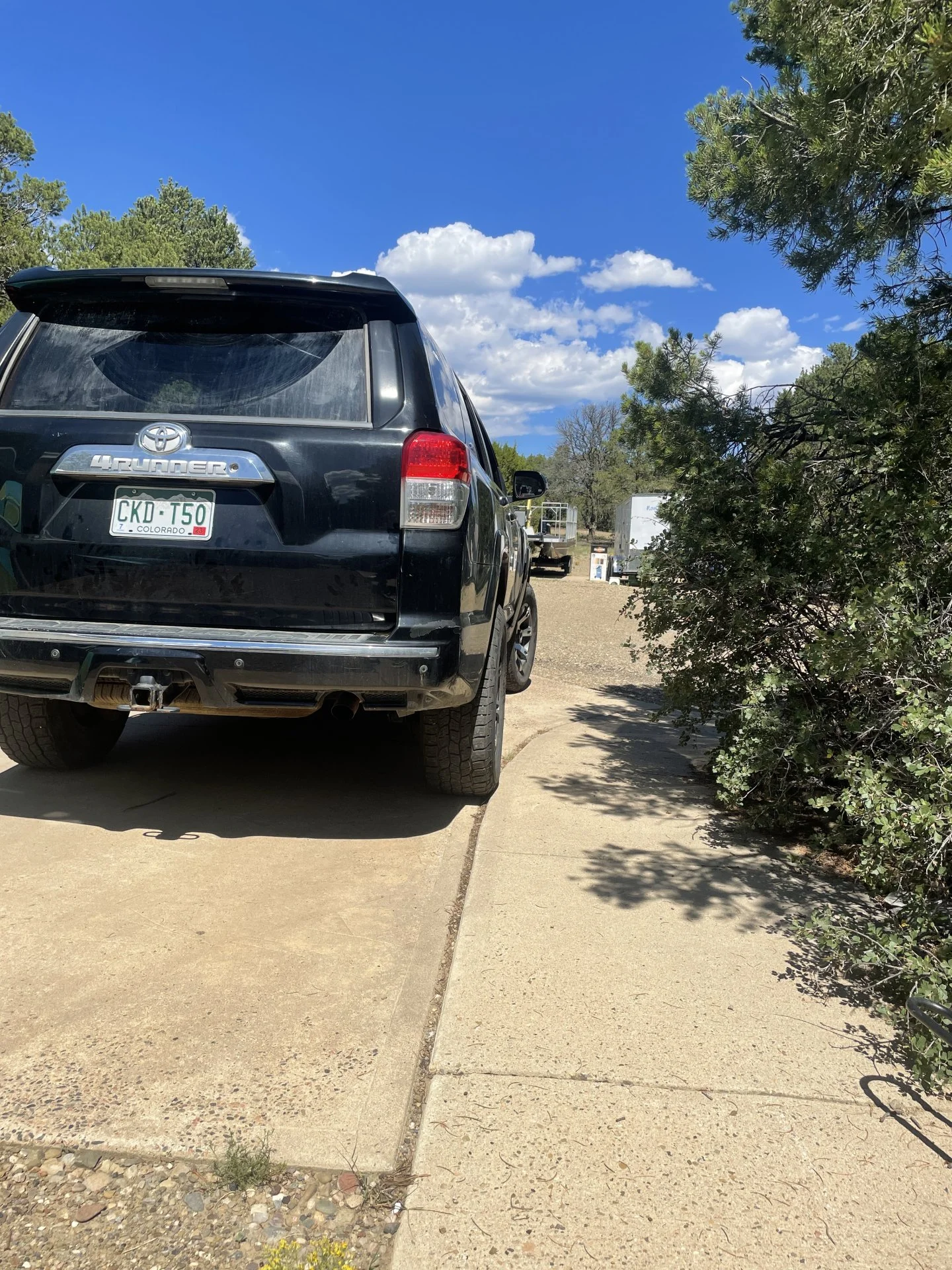

17" American Outlaw wheels from PO with Cooper Discoverer AT3 265/70R17
I do not know offset but they stick out about an inch.
I want a taller and skinnier tires in a KO2
These Coopers are great on the Highway and 3 Peak rated but have weaker sidewalls so i haven't taken her off road
She has an Eibach stage 1 lift
I ended up doing TRD wheels with 0 offset and 275/70/17's. After doing much research I discovered this is the largest tire that will fit on an unlifted 4Runner. 33's require a 2"-3" lift. Hope that helps.
