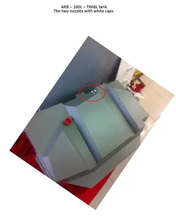

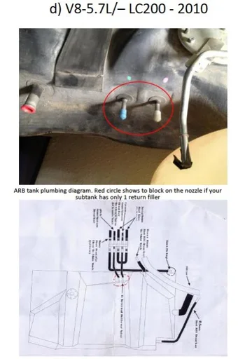

45L Fuel Subtank
-2012 LC200 fuel subtank has only ONE INTAKE NOZZLE - see pic below
-2011/2010 LC200 sub tanks had 2 intake nozzles which fit straight into ARB 180L tank code TR68L.
Now I want to order the ARB tank and have been trying to get in touch with both ARB & LongRanger guys and awaiting their response. So far no luck. there is NO pump in the subtank - seems like a gravity flow/siphon mechanism.. See pics... why haven't ARB/LR taken these sub tank changes into account??? [they sent the same 2 nozzle tank to my friend with 2012 LC200....]
Can anyone elaborate the significance of these part changes?
My 2012 LC200 has a factory winch with factory back door mounted spare wheel and another spare wheel under chassis. No KDSS.
Pictures are - 2012 Sub tank with one nozzle, 2010 with 2 nozzles and the new 2012 ARB 180L Tank code TR68L purchased recently..

I didn't get any satisfactory response either from the long ranger or from the general ih8mud community , but now I have few more details / pics to share. Initially I thought that the V6-2012 LC200 manual has one return nozzle in their sub tanks and hence we need to plug one of the ARB aux tank nozzle. ARB comes with 2 return nozzles.
Recently me and my friend - we both have exactly the same vehicles - same manufacturing period - same specs - same color - V8-4.6L 2012 - went for our aux tank (TR68L) installations. Apparently my subtank had 2 return nozzles and his one had only one! We just cannot comprehend this difference ? See the pics below if you can make out some sense !
So is it some kind of random subtank distribution by Mr.T? Is there any significance of having one versus two return nozzles? How come ARB never witnessed this ? After some waiting and discussion with long ranger , they just sent us a new plumbing diagram to plug one of the nozzles ! That's it.
