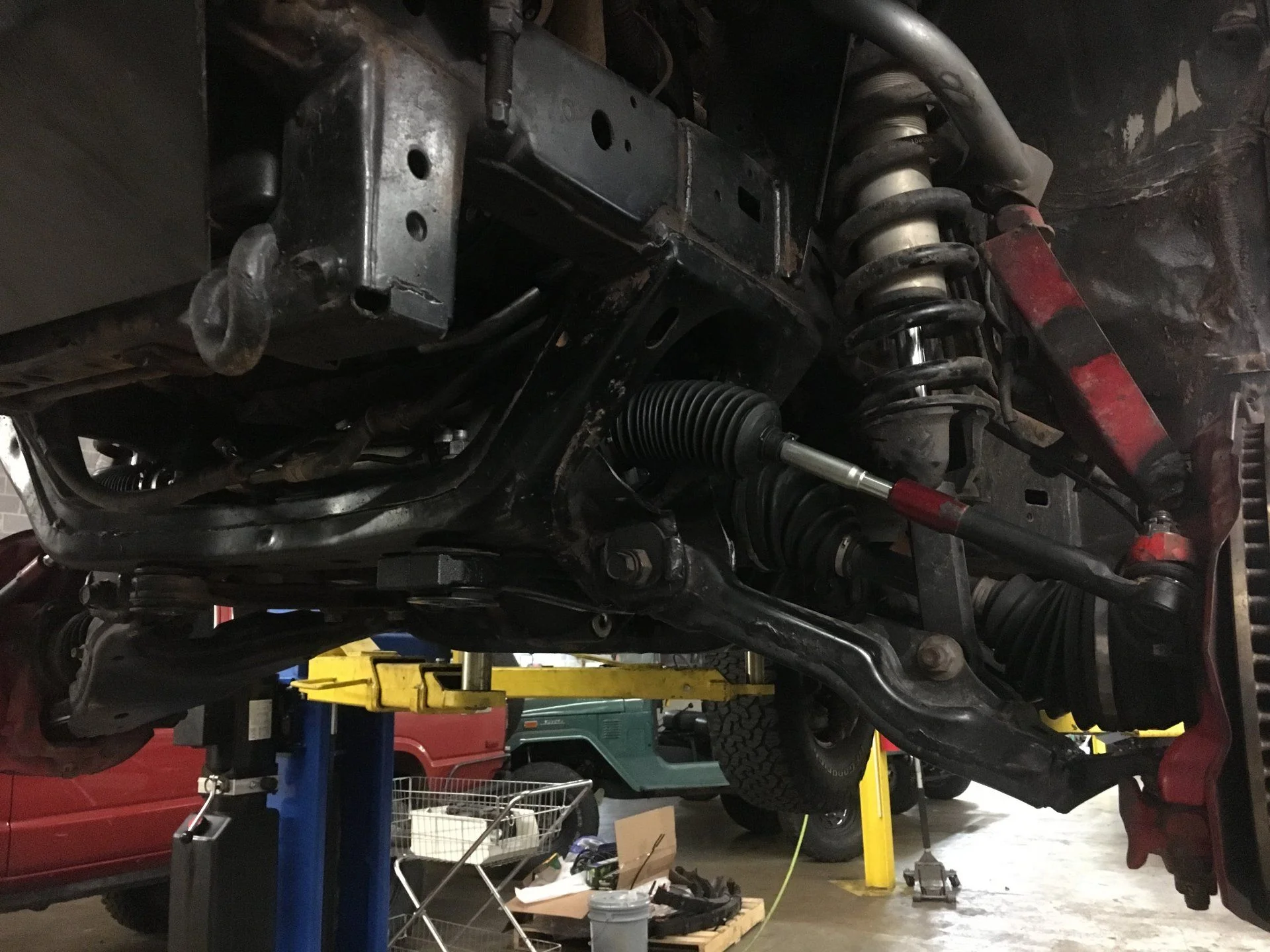

I've been running 315/75/16 for around 7 years on FJ80 alloys as well (but mine are not TEQ, some knock-offs that don't need the spacers). I go through inner tie rods every 18 months. I've been through 2 steering racks since the tire upsize as well. I just finished installing the latest rack 2 weeks ago.
I'm starting to think...how can I get a Tundra steering rack under this thing :D

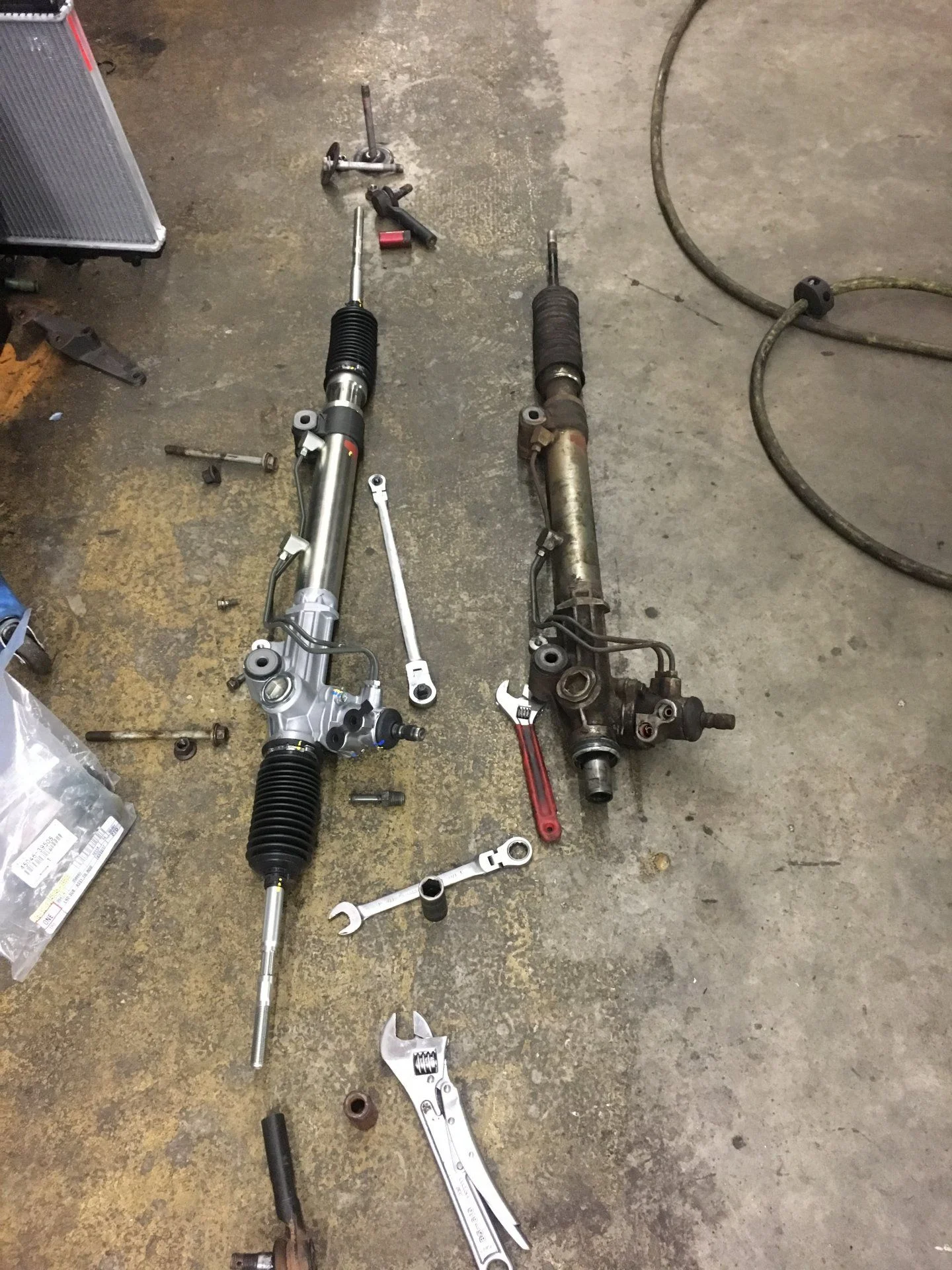

OK, on that 1st point you may be right, but I can't confirm yet. The new rack comes with inners already attached and I did not remove them during the installation (though it would have made the job much easier). So I have no idea what size the inner threaded part is. That would suck if I bent one on the trail and my trail spares wouldn't fit. I have someone I can talk to that may be able to shed more light on this. I will report back when I suss it out.
New and old next to each other. The old outer tie rods do fit the new inner tie rods, so that diameter and thread pitch is the same.
