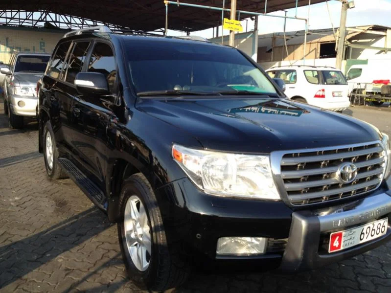

I just reconverted my 09 to 2013

Thanks dude, looks just like a '13

thanx for all replays and i will list what i replaced
1-front head lamps 2013
2-front bumper and under grill guard
3-2013 grill without camera
4-side merrors with LED signal lights
5-side 2013 moldings
6-rear stop lights 2013
7-4 rims with center caps
note : my 200 is american spec and all parts boughts from the meddle east spec so i hade to do some wirring jubs for the head lights and the rears
all parts + installation costs arround 5500 us dollers

does the module and auto levelling system give u a headache when installing? everything else works fine? im tempted to do simillar work THANKS BUDDY
Hi
Actually ، every thing working good but , because the models les than 2013 does not have the leveling system , i got the manual leveling head light , and if u want to put the LED day time running lights on you need to do some wiring modification with the original DRL which im going to do today
