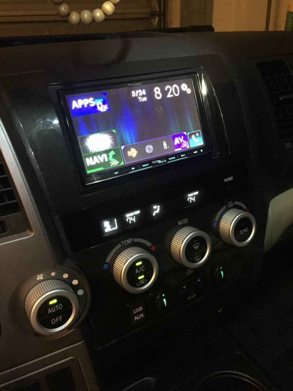

So the stereo on my 2008 tundra is starting to develop a mind of its own. I'm looking into upgrading the unit. I hear people say they've upgraded to a unit with navigation. Can you guys post pictures of your upgraded set up? Any advice on what to and where to purchase?
I have a Sequoia that has the same radio setup as a Tundra. I installed a Pioneer AVIC 8100 NEX head unit with a CRUX SWRTY-61 wiring harness to retain factory backup camera and steering wheel controls. Radio was definitely an improvement on sound. It even makes the stock speakers sound good. I used the following bezel to mount it: Metra 99-8220 Dash Kit, Gloss Charcoal. I get compliments on the bezel all the time, matches the factory dash perfectly.
