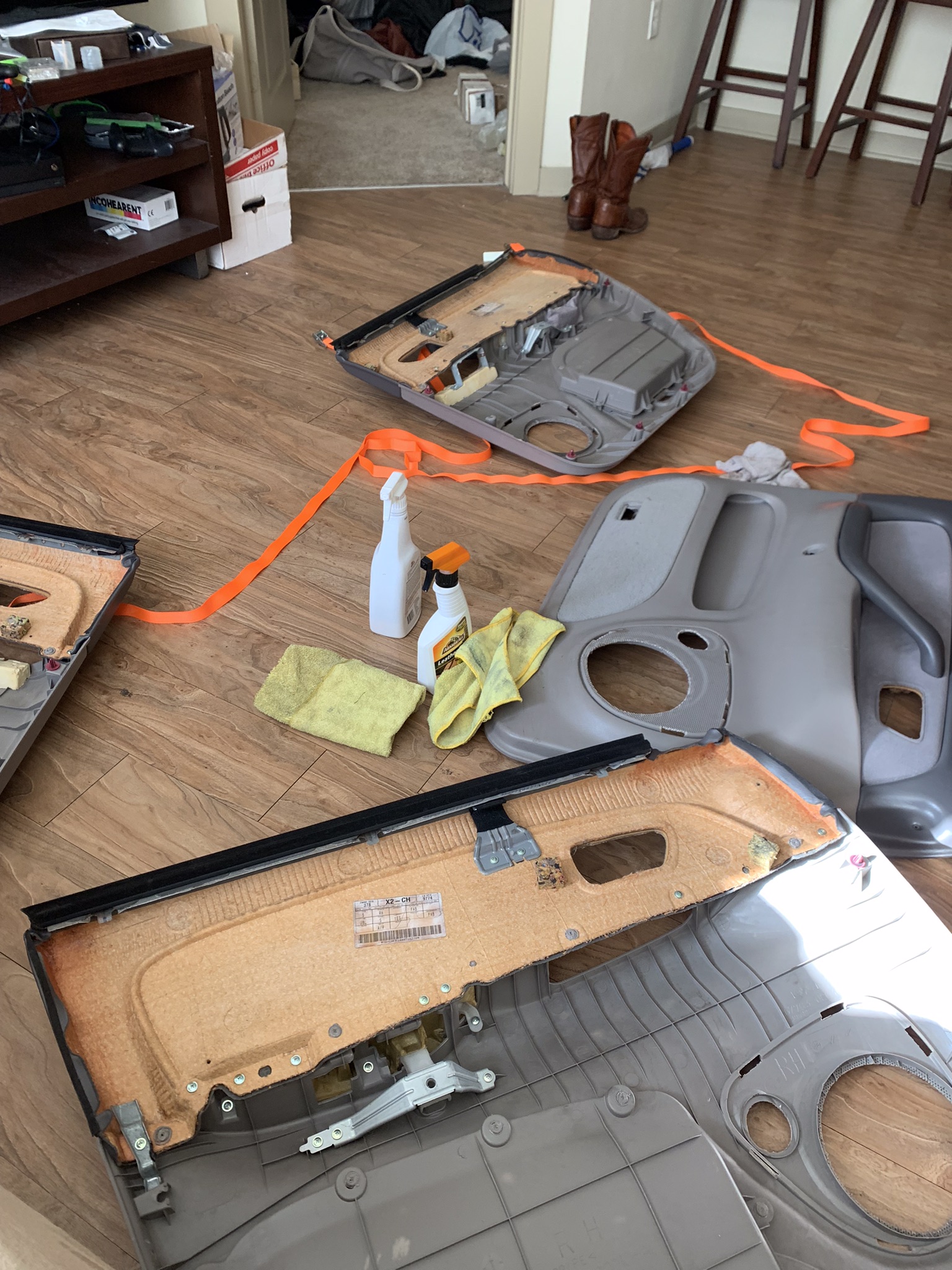

- A bluetooth kit bought on ebay: One of the best purchases I made, I was able to keep the old school looks of the stock JBL stereo with wireless connectivity. Install was super easy, just removed the head unit, unplugged the CD plug, and plugged the bluetooth kit in.
- Reupholstered the door panels with tartan fabric from a pair of pajamas I cut up.
- While the door panels were off, I cleaned the speaker grills and applied 303 Aerospace on all the interior panels.

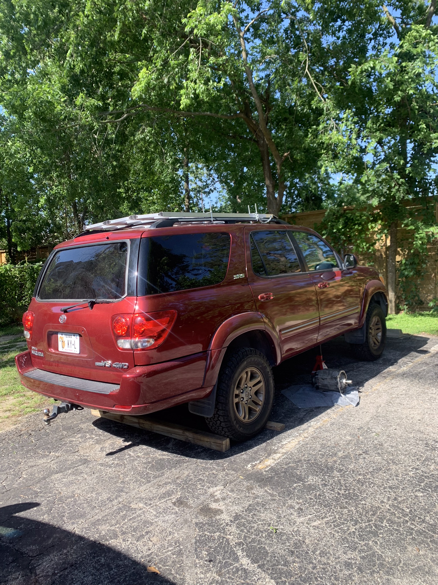

It was finally time to start working on the transfer case. Make sure to get someone to help you take the transfer case out of the vehicle. Don't be like be and drop it on your own face during removal. Cracked a tooth and busted my lip.
After the removal of the transfer case and help from the previous owner (shout out to Dean), the problem was determined to be an C clip that wasn't properly installed in the transfer case when the previous owner rebuilt the transfer case.
The previous owner was nice enough to help me take apart the transfer case and repair the clip when I brought the case to his garage. After reinstalling the case and retiming the electronic actuator. 4WD was working again just in time for a summer roadtrip.
There are some big pains during the transfer case removal and reinstallation process, including:
- Removing input shaft seal from the transmission - required alot of flatheads and hammering
- Retiming the electronic actuator- there are NO information on this. I followed a Russian Youtube video to retime the gears, and there is also a nice write up on the TSOR Facebook group.
And during this time, I also installed a makeshift roof rack made out of a ATV ramp from Harbor Freight. I will post another guide later on how to build a full length aluminum roof rack.

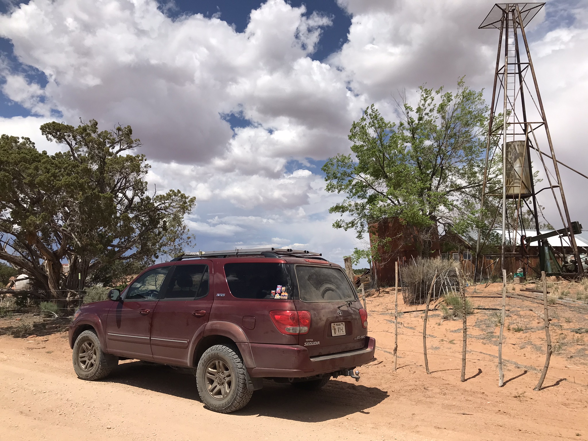

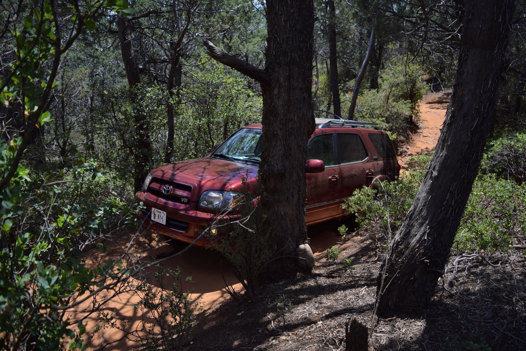

First big road trip in the Sequoia. My first stop is Sedona Arizona, one of my favorite towns in America with some beautiful scenery. Took the Sequoia to Soldier's Pass, extremely fun trail with some technical parts, great for a beginner like me, highly recommended.

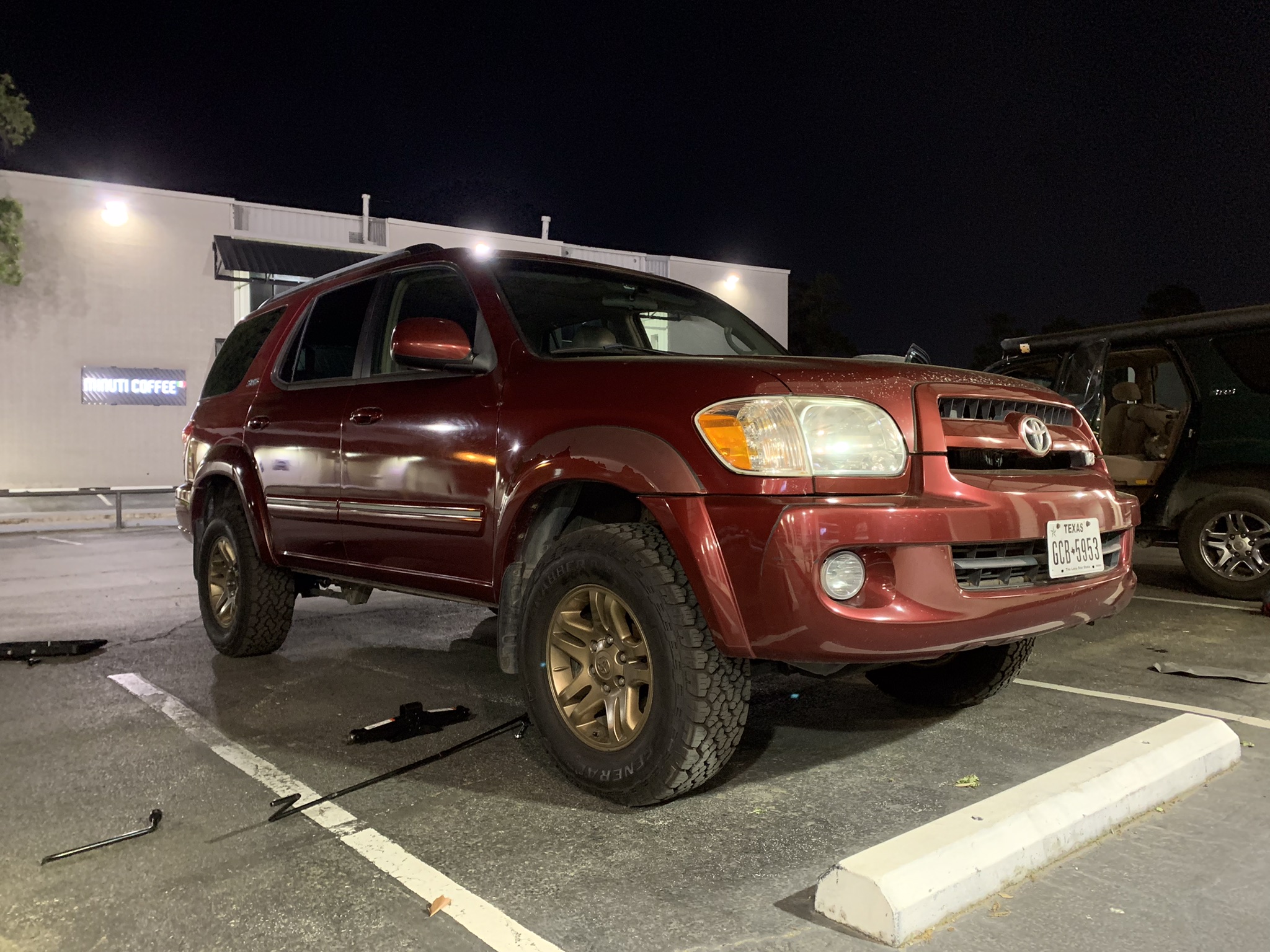

To combat these problems, I installed a few mods:

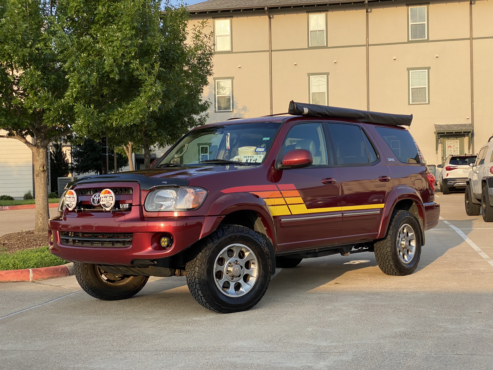

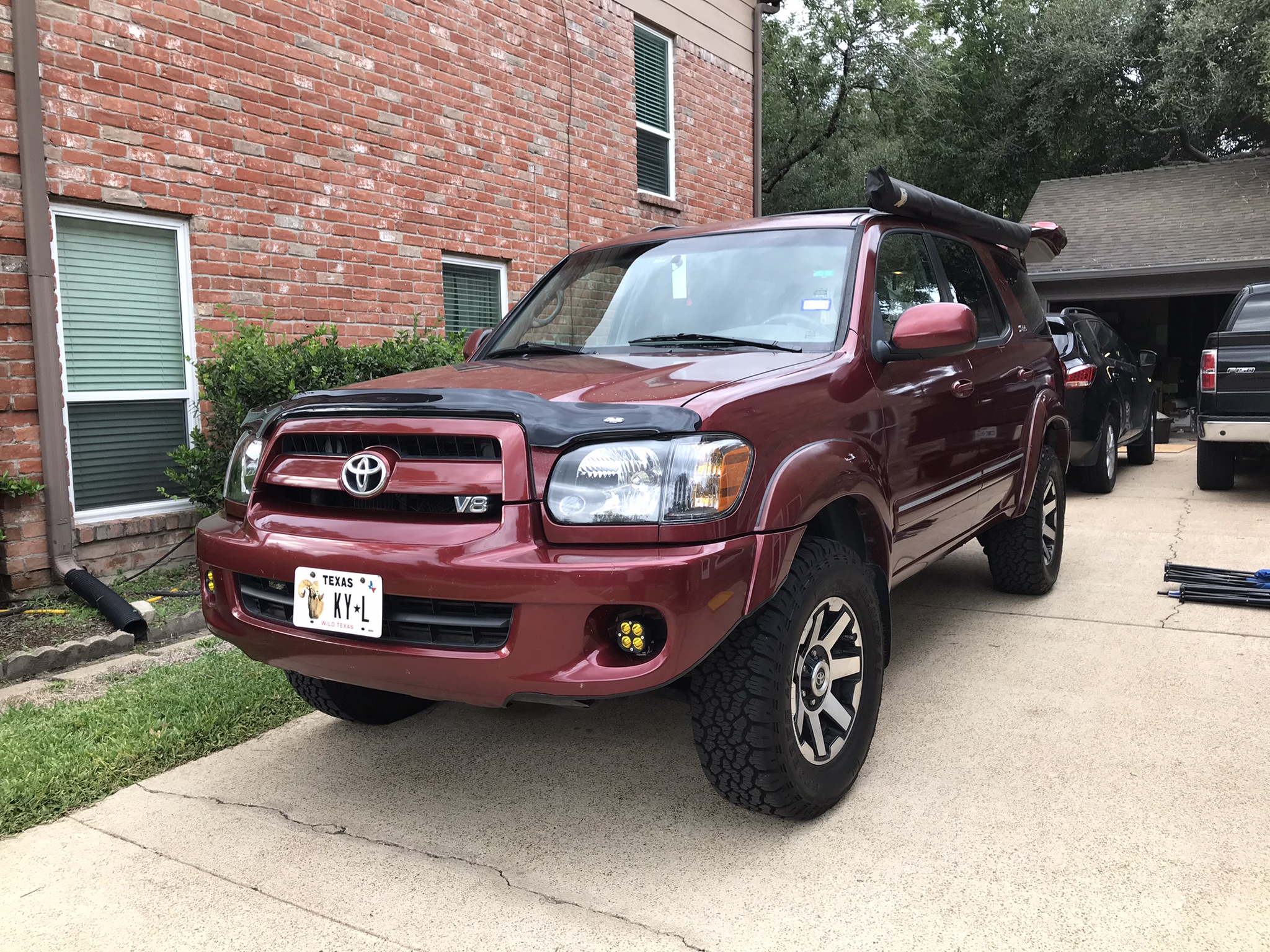

- Bilstein 5100s to combat ground clearance. Didn't do a crazy lift since this is a daily, just set the shocks to the middle setting which gives it a leveled look
- Amazon knockoff flood lights. One of the best purchases I've made, put them in place of the stock fog lights, super bright and super easy to install. Still working great after two years of ownership
- AVS bug guard - Another great purchase, covers up some of the car's rock chips and drastically reduced the number of bugs hitting the windshield. Only down side is that it prevents air from blowing rain drops off the hood and windshield.
- Fender cut - mostly for looks, also for ease of access to the fog lights when installing the food lights.
The front end of the vehicle is looking alot better now, way more aggressive.

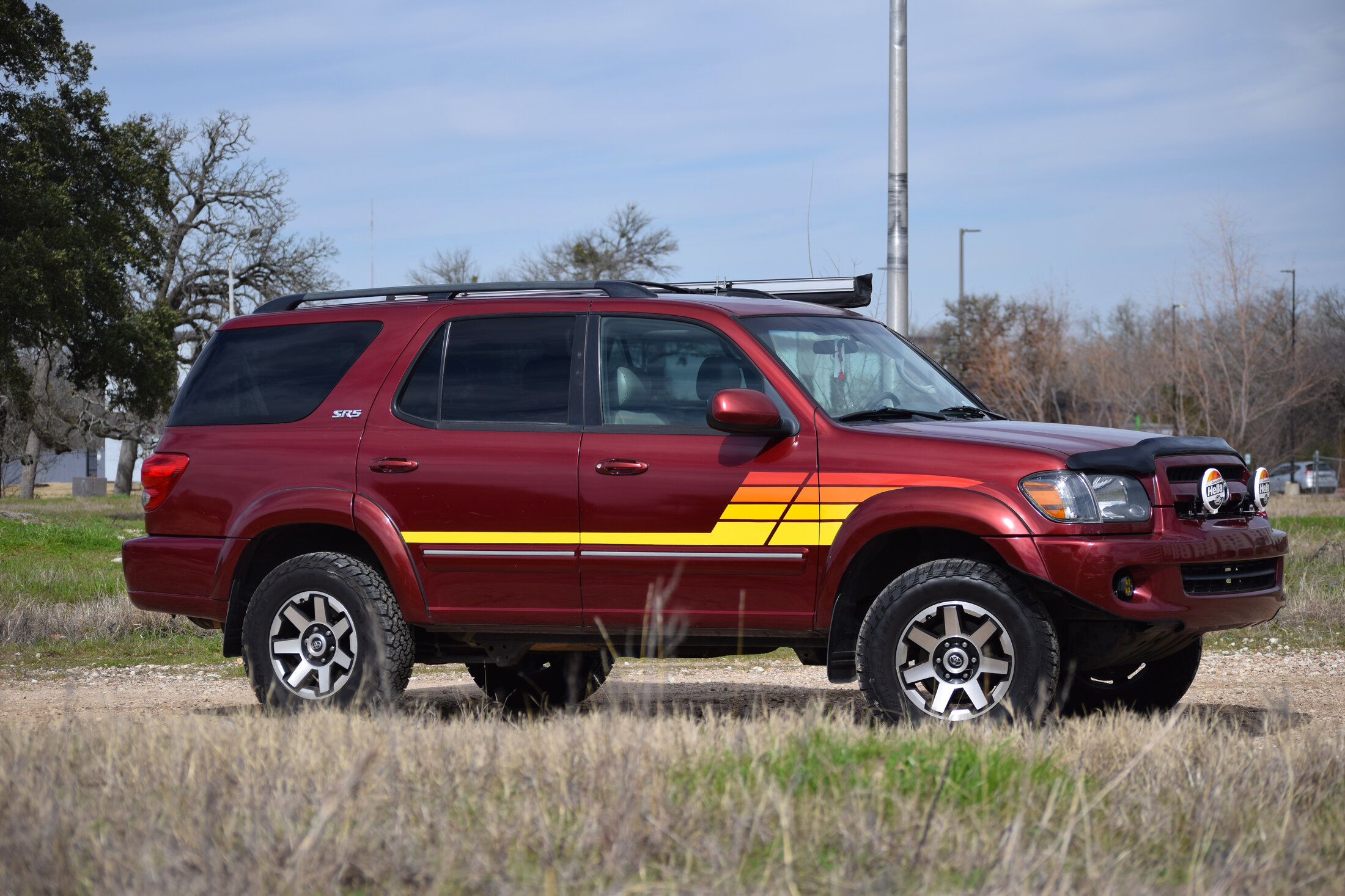

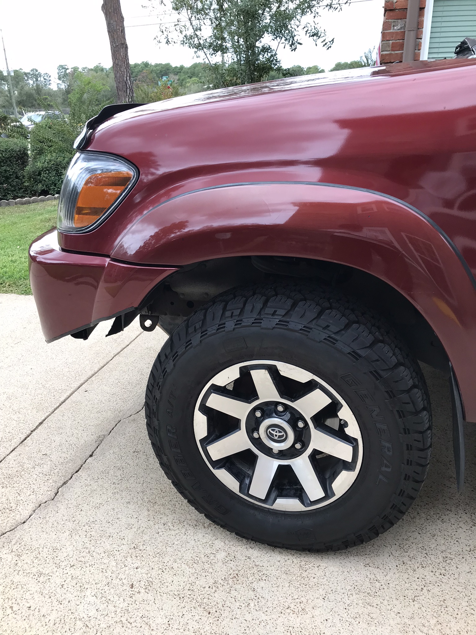

- Got some 4Runner TRDOR wheels: Got really tired of looking at the spray painted gold stock wheels, found a set of these T4R wheels for cheap on Facebook.
- Installed an NAPA awning I had laying around for beach and camping trips.

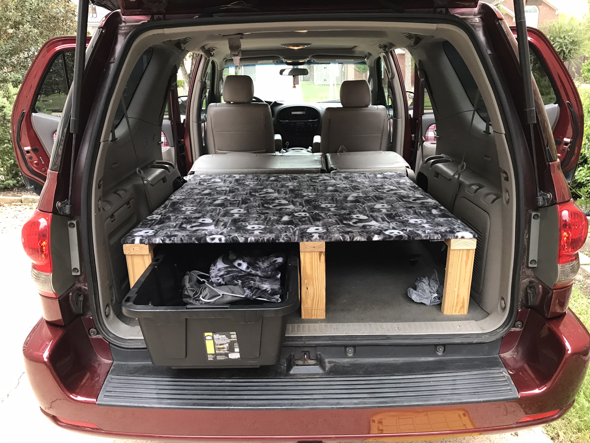

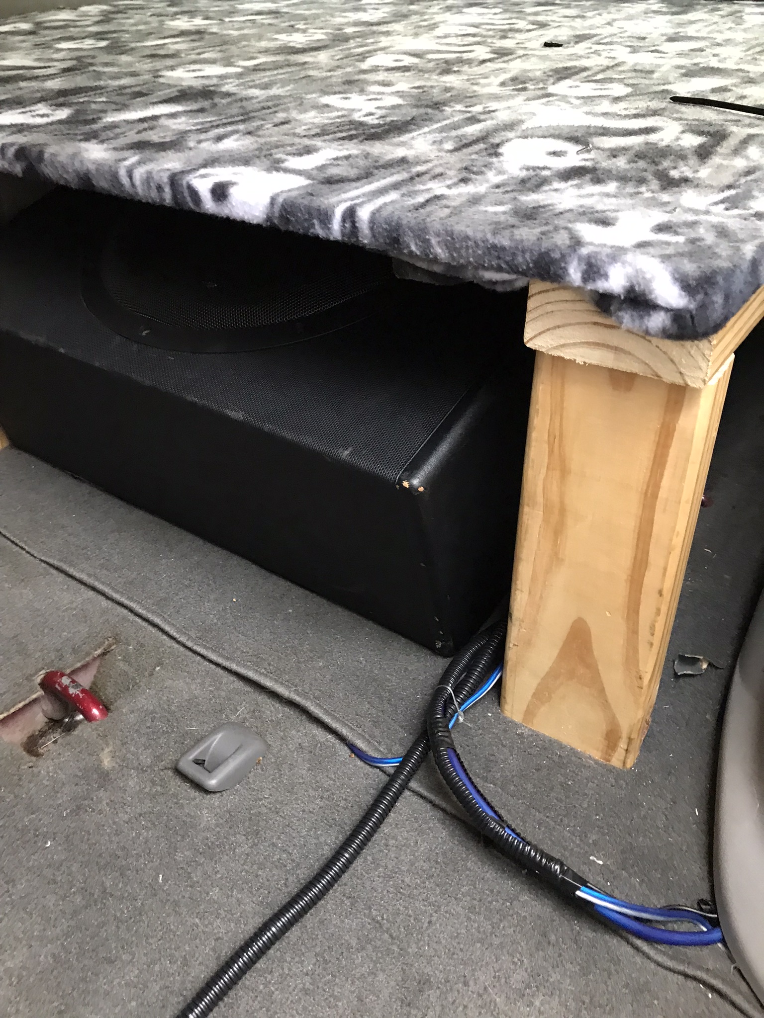

While I was home I decided to also build a sleeping platform in the back with some underbed storage as well. If you decide to build something similar, Lowe's sell these bins that are absolutely fantastic.

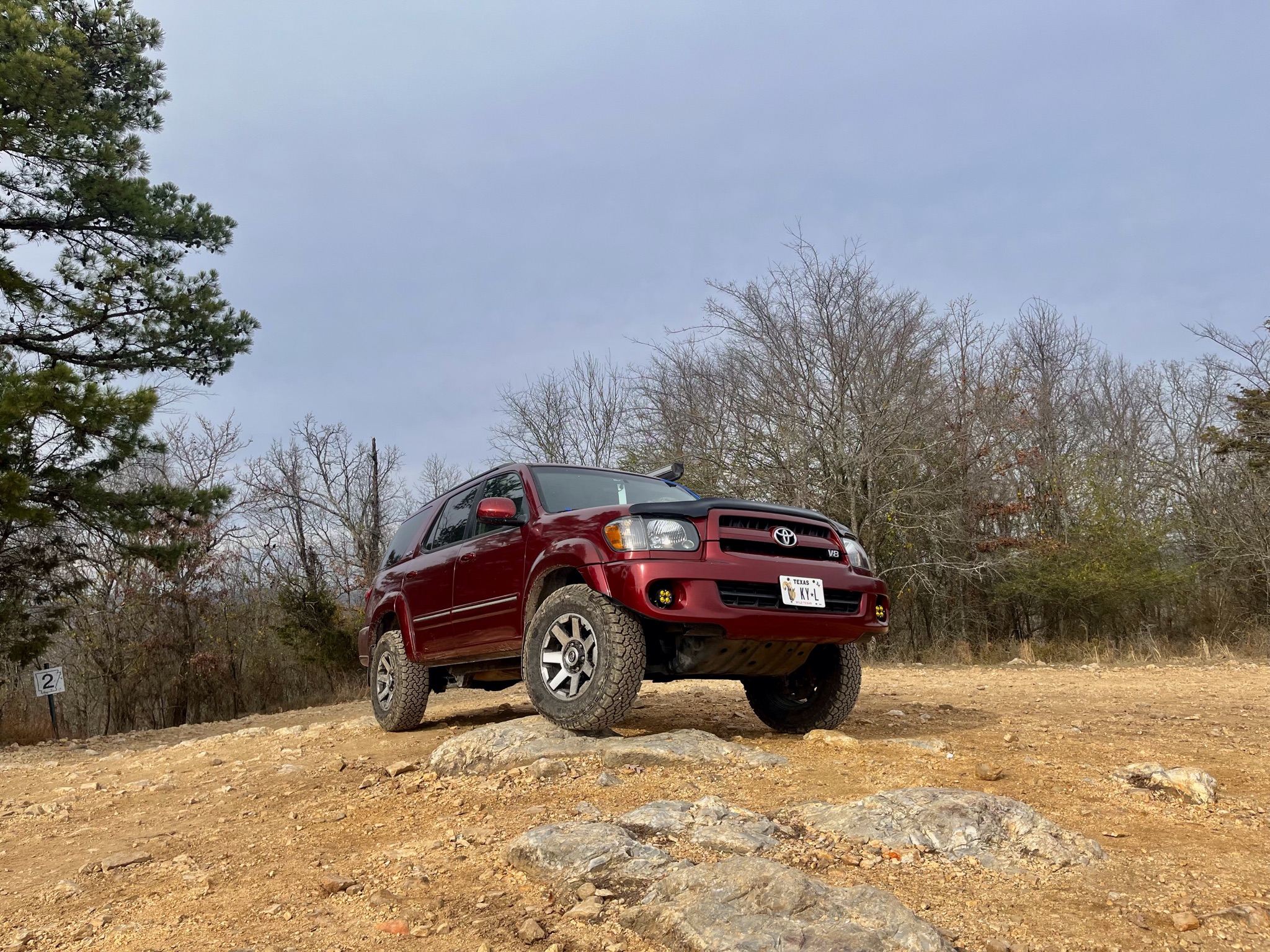

Another big road trip, this time to Hot Springs, Arkansas just in time for Christmas. Stopped at Caddo Lake, Texas on the way and did the Jeep badge of honor "Snake" trail at Hot Springs Off Road Park. Very very fun trail and I highly recommend it. The Hot Springs bathhouses were also very relaxing as well especially during the winter.
March 2024
Went on another big road trip to Moab and camped in the car the entire time. Did a bunch of trails including Fins and Things, Gemini Bridges, and Potash road. Fins and Things is the most fun I have had on a trail so far, and Gemini Bridges and Potash road both offered some insane views and some abandoned uranium mines along the way. Will definitely come back some day.
On this trip I realized how little flex the front end of the Sequoia offers, as I constantly found myself three wheeling on more technical parts of trails. Took the front sway bar off as soon as I got home.

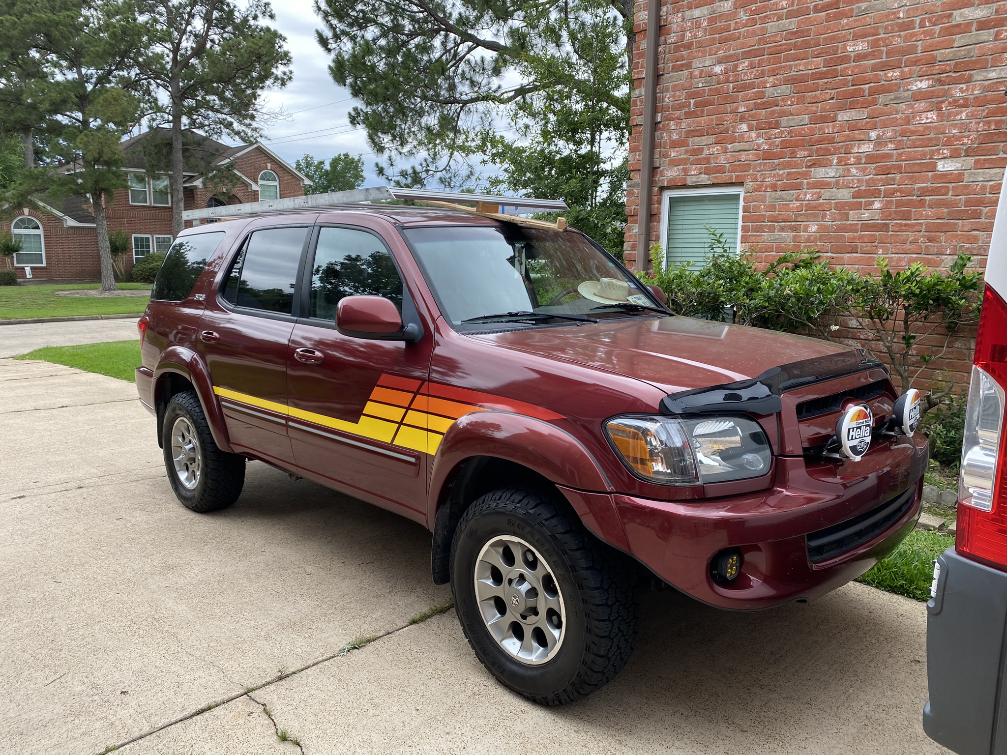

Felt as if the old 4Runner wheels didn't look great with the stripes. They were too modern looking with the diamond cut color coding. Picked up a set of old FJ Cruiser wheels off Facebook for cheap and damn does it look good.
