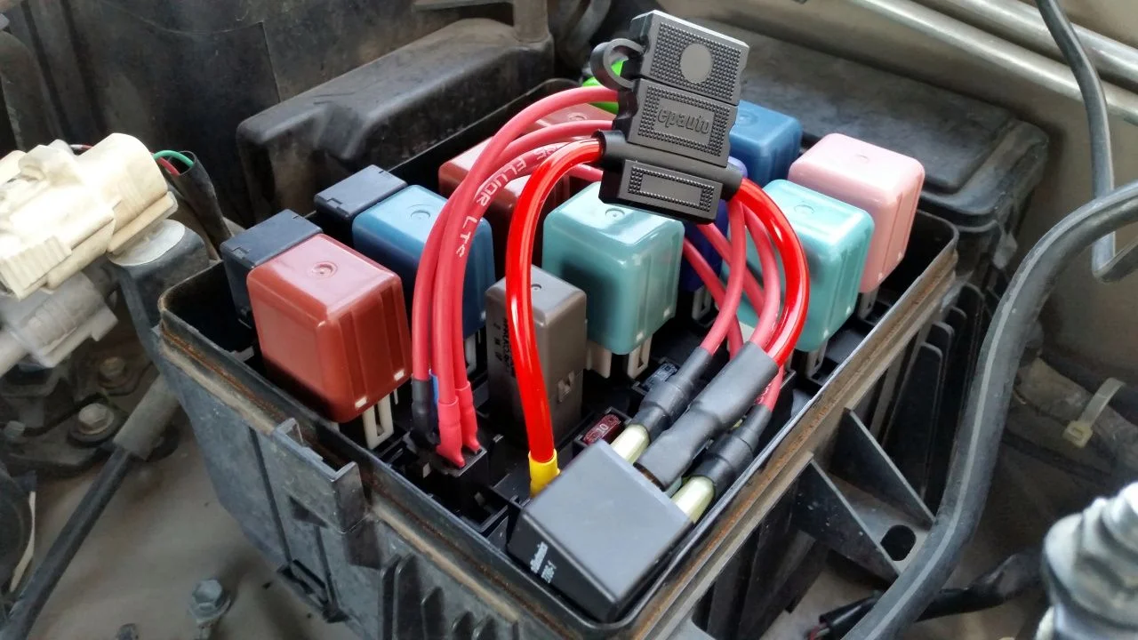

Sounds like you may have the common immobilizer issue that is in the LX470s:
