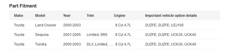

But those work up to a certain year production. Maybe up until 2004 or 2005. The starter 28100-50101 doesn't have those parts available.

All I know is when I enter my data for that part it says not compatible. Also only compatible for up to certain year Toyota as well.

There might be slight variations between starters over the years, but they are all rebuildable, and dollars to donuts they are interchangeable.
It is just a matter of sourcing the parts, they are available...
Starter Contacts for 2003-2007
If this helps, I recently rebuilt the starter on my 2008 4Runner with:
2822650070 - contacts
2822650080 - contacts
2823554380 - plunger
and everything fit in just fine, so I think there is truth to what FrankTorres said.
