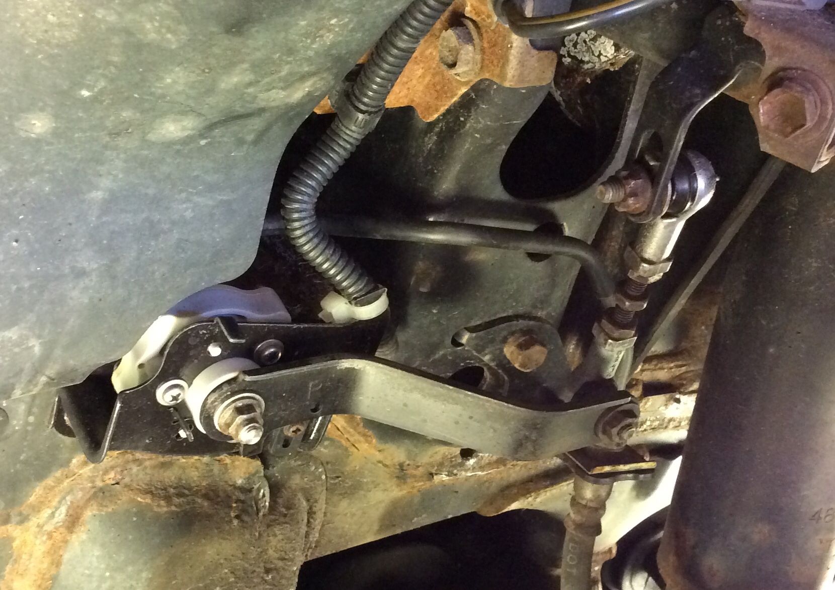

OP start here: Removed driver’s side height control sensor and arm. No need to jack up car, because your car is stuck in front HI it is easy to reach around/over wheel to access. Sensor removal:
  1. SOAK bolt at end of sensor arm to suspension pick up point in PB Blaster.
  2. 2x14MM bolts to frame, loosen both until just holding bracket on.
  3. Remove 10MM bolt at end of sensor arm link to suspension mount, 10MM opened end wrench on back of nut to keep from spinning (make a mark or take a picture of where the suspension link is within its mounting slot). I choose to remove link from suspension pickup point because I didn’t know how much force was going to be involved so I didn’t want to stress the arm by separating at the arm to link joint. Next time I will separate at link to arm joint then I won’t have anything to mark Make sure you tap all the rust of the nut and you have great contact with the nut before you start turning. Once nut is off arm it will (should) move very freely
  4. Cut cable tie that holds wiring harness to bracket, unclip sensor from wiring harness.
  5. Holding sensor arm and sensor assembly with one hand to prevent from over extending arm, now finish removal two bolts to frame.
Pic of my passenger side post replacement.

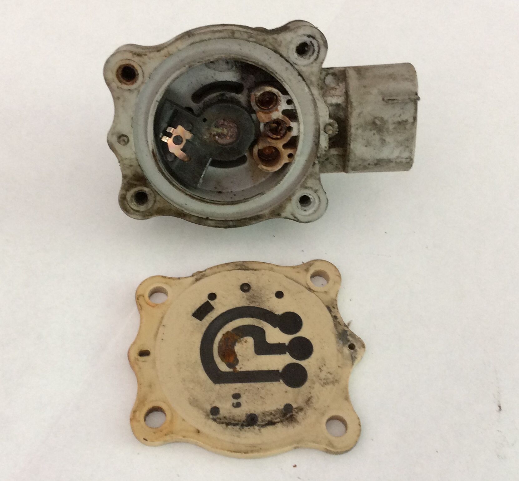

Driver side: My driver side was a little dirty inside, cleaned up with contact cleaner and a q-tip. Tested with OHM Meter. Center pin on connector is ground. Tested each outside pin to ground, my outside pins ranged 550-1950 and 450 -1950 as you moved arm. During reasembly sensor cover screws should be snug but don’t overtighten at risk of cracking housing.
Passenger Side: Mine was completely fried inside, clearly had gotten wet or dirty enough to cause an arc vaporize everything.
