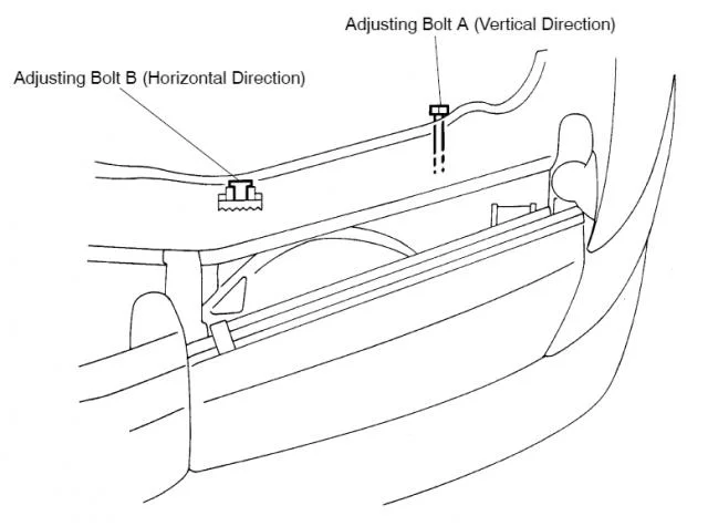

Hey guys,

There is a small adjustment nut near where the bulb for the low beams goes into the housing. You'll need a small wrench and some patience if you try to adjust with the lamps installed.
There should be 2 adjusters, one for left/right align and one for up//down align. I don't have the adjustment specs at the moment, but they are probably in my electronic FSM. OZ has different specs AFAIK and I don't have them handy either. Someone will chime in with the adjustment specs I am sure, it's not that hard to do with a couple of chalk crosses on the wall.

from the fsm:
(btw: You have to turn quite a bit to see any change, several turns)
