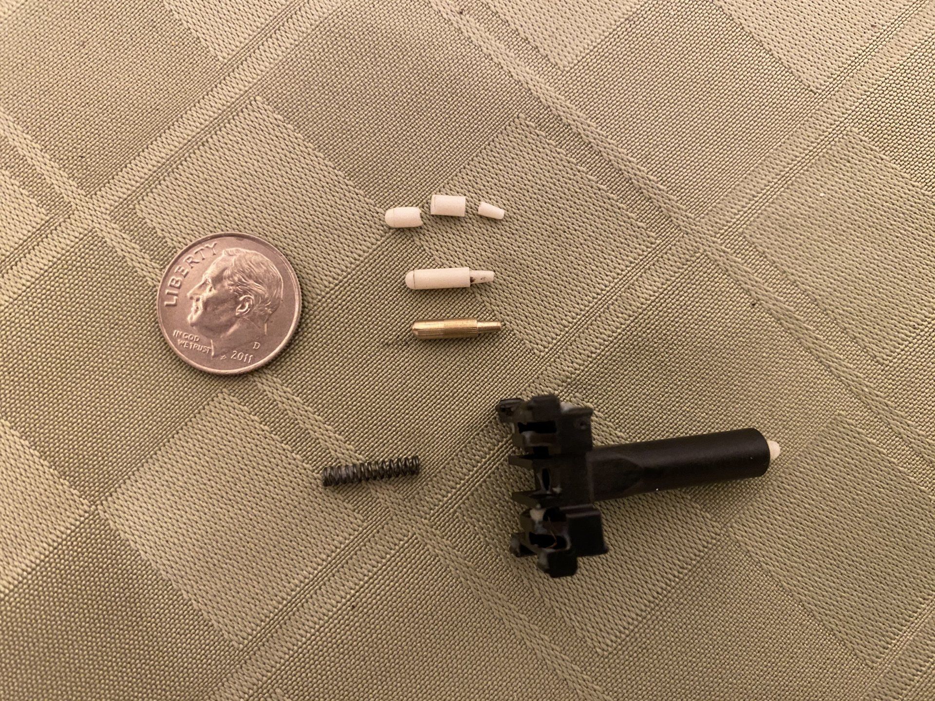

Just had to deal with this so thought I’d add a pic for future reference. The pic shows the broken pin, an intact pin taken from one of the other switches, a pin that I made, and the spring and switch lever. the pointed end of the pin goes into the spring, and then they both go into the switch lever. I bought some 2.5 mm brass rod and chucked it up in a drill to do the shaping.
