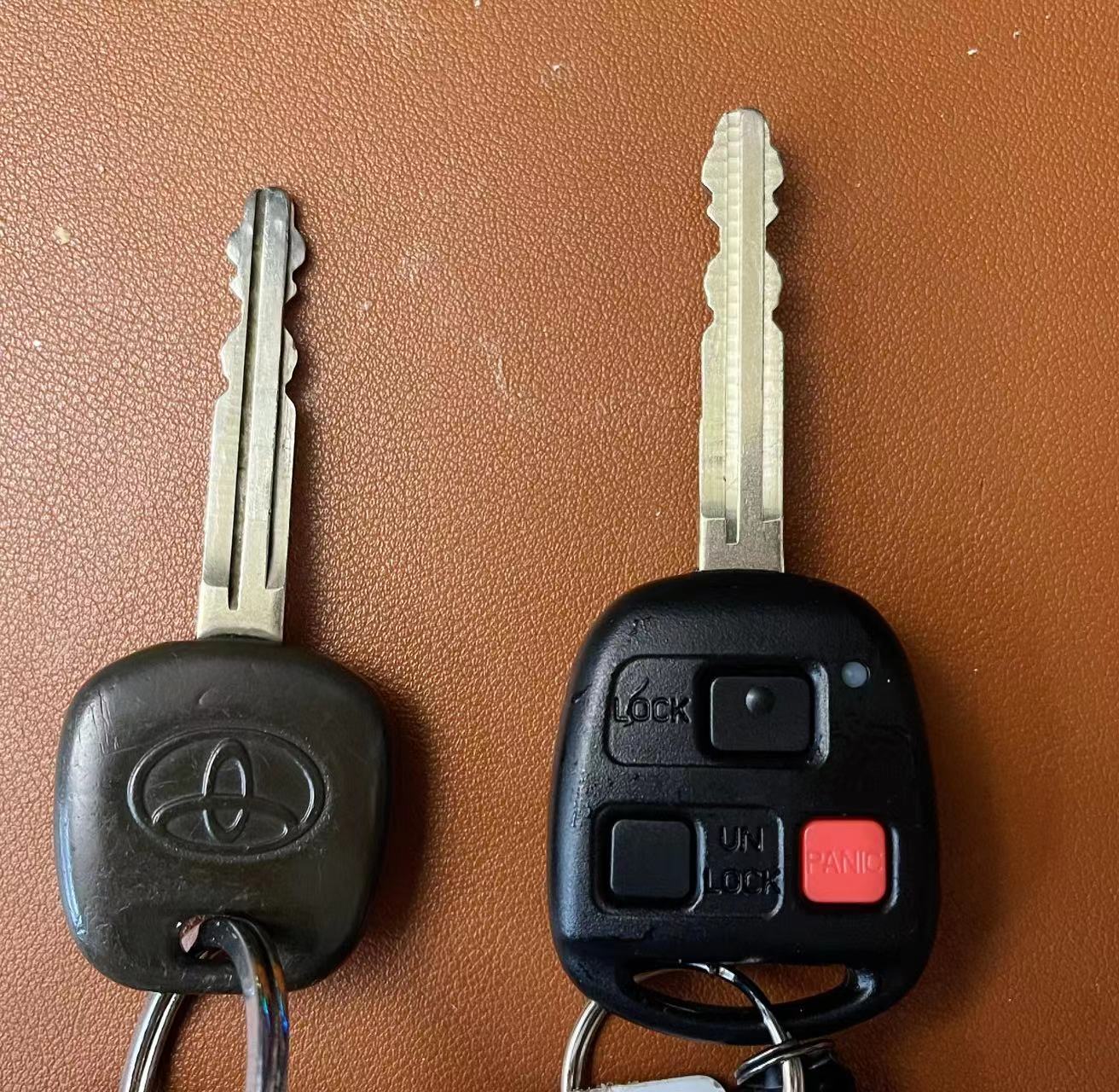

2004 LC100 key programming - remote works but key can't turn on ignition
Sep 26, 2021
3
15
NYC
Hi all, new LC100 owner here, car is a 2004. I only get 1 transponder key so I bought one with remote (see pic below) and had local key master shop cut it for me - he did mention to me that there are 2 chips in there: 1 for the remote, 1 for the ignition.
I searched on the forum and watched all the videos I can find, now the remote works after following this video (), but the key still won't turn on ignition, it can turn on the power (radio, etc.) but security light remains on all the time.
I just spent an hour doing further research but can't find any way that works, any suggestion is appreciated.
Thank you.

It looks like you have a valet key, you will need a master or a immo reset to add keys if so.
Watch the security light as you insert your key into the ignition. If it goes out right away you have a master. If it stays lit for a second your key isa valet.
Thanks Mauser, will watch the security light next time...

Nope, the key I have is a valet key (thanks @Mauser for his instruction), therefore I can't program my key. I end up asked a indi shop prgoram a key for $100. If your dealer only charges $100, I think it's a good price!

Also, for an FYI, another easy way to determine if a key is cut for master or valet is by the tip of the key(at least for my 2003 LC)
