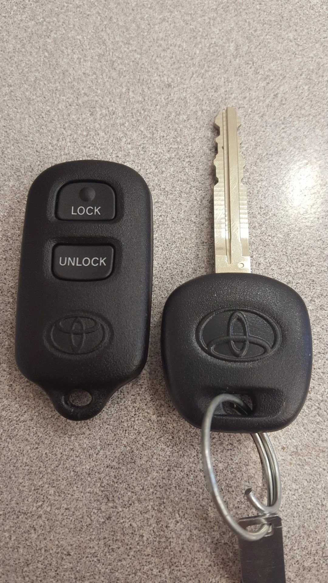

OK, The remotes I ordered from eBay arrived today. They are definitely brand new authentic Denso remotes. That's the good news. The bad news is that they are thicker than I'd hoped. Slightly over 1/2". I was hoping to locate some that were 1/4" thick or so. The search for that continues. The large buttons and lettering are definitely welcome though. Programming the remotes was simple and they have great range. It's nice to never worry about breaking another key again. Here's a comparison pic with a new non remote master key, and programming instructions...
Add remote procedure:
With vehicle OFF, NO key in ignition, drivers door OPEN and UNLOCKED, master key in hand:
1) Insert and remove key TWO times.
2) Close and open door TWO times.
3) Insert and remove key ONE time.
4) Close and open door TWO times.
5) Insert key and close door.
6) Turn key to run position, then to off position and remove.
(At this point the door locks should cycle lock/unlock to indicate programming mode)
7) Simultaneously press the lock AND unlock buttons on the new remote for 2 seconds.
8) Press the lock button for 2 seconds.
(At this point the door locks should cycle lock/unlock to indicate successful programming.
9) Open the door and test....

great work and info! I'm going to pursue this. Could I keep my working remote key and simply program the new remote in addition, or will that throw a wrench into the works?
I'm not sure what the limit is, But I know it's at least 4. I have 2 remote keys and 2 remote fobs working now.
Did the stand-alone transmitter improve the range of the lock/unlock? Mine is abysmal with new batteries at about 10ft (and if I remember right that's about what the manual said to expect). If this went up to my wife's Tundra at half a parking lot I would put up with the extra fob on my ring...
Definitely! I tested it 3 houses down (approximately 200 feet) and it worked fine. It might have worked further away, but that would have put me in the street... It's a cheap, easy test. Pick up a used one on eBay and give it a try. I got very lucky finding a couple brand new ones for $24 each. Just search for HYQ12BBX. Good luck!
