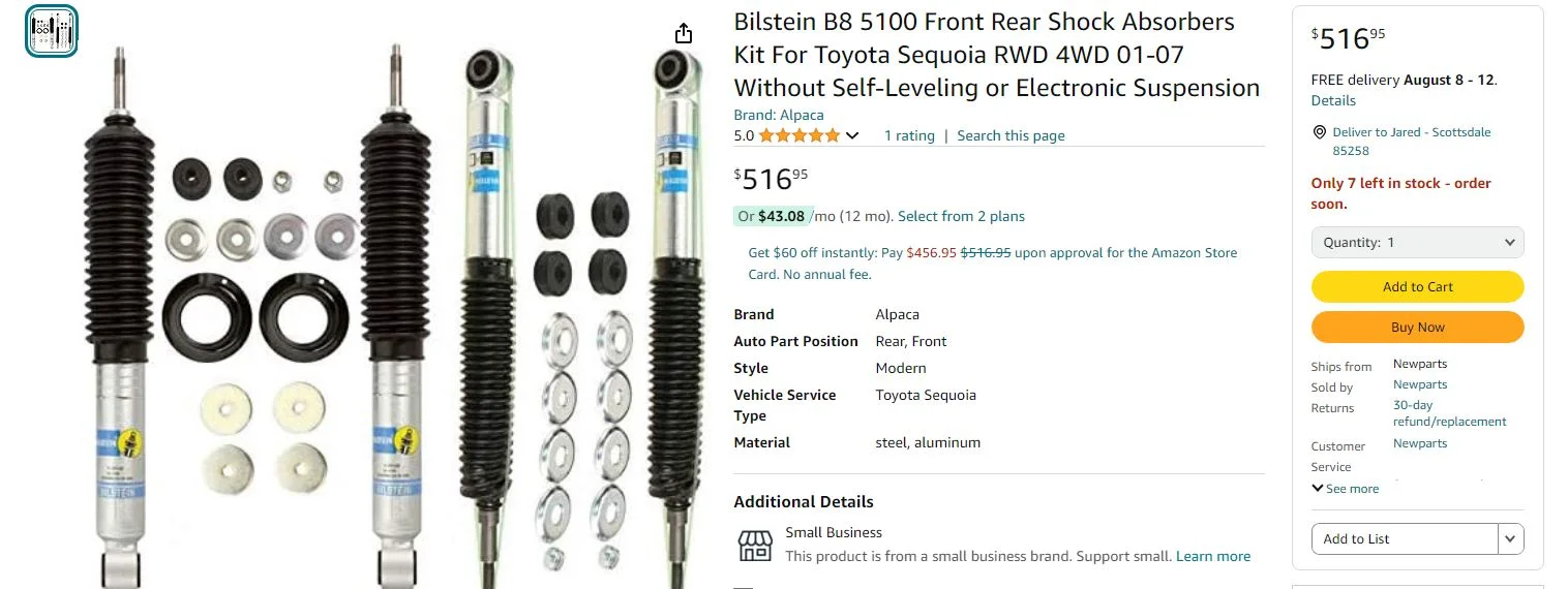

I read some of threads here and found that the Bilstein 5100's seem to be well regarded. So I did some searching and found these:
Bilstein B8 5100 Amazon
Is that what I would want? Or is this a waste of money for a 2WD?
And is there a better source out there than Amazon? Amazon has a reputation for selling fakes. And It bothers me a bit that the picture does not show the springs--- but that every other Sequoia strut seems to come with the spring attached.
And again, this is a 2WD truck-- and it is not used for off-roading of any kind. I just want it to drive nice. And occasionally tow a boat or other trailer.

Rock Auto is my go to for non-OEM parts. If it were me, I'd get a set of Gabriels or Monroes and call it good. You're probably talking $175ish for all four corners.
Do you think I should buy the strut/spring combination? At RockAuto I can get Monroe QuickStruts with the spring for $71 a piece. I can get Monroe RoadMatic for $81 I don't know if the springs were replaced the last two times I had the struts replaced.

www.1stgenoffroad.com
From what i've been told his is the best site hands down for not just suspension, but all things first gen sequoias. I haven't ordered from them yet but I've spoken to many who praise the site and their staff who always offer their support and 2 cents.
Regarding the Amazon listing, I believe the coil is sold separately. The front 5100s definitely utilize a Coil.
Check out 1st gen's listing for this same setup:
or the 6100 if you're feelin it =) :
