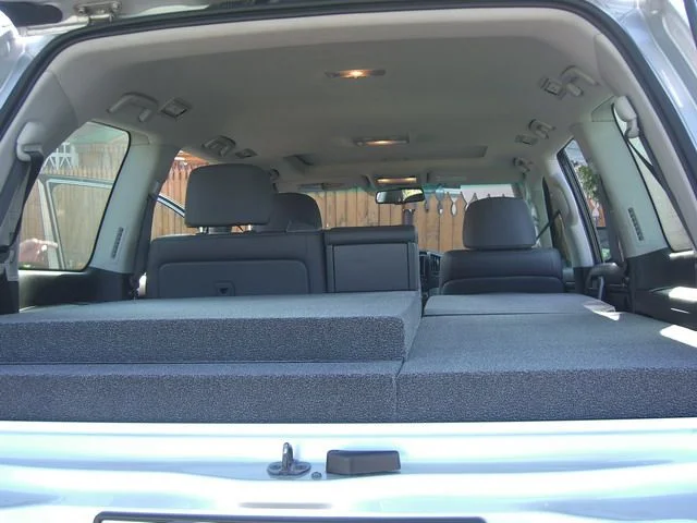

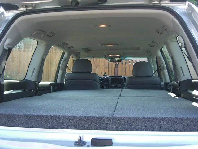

I am sharing my new sleeping platform in hopes for your feedback and so others can hopefully benefit. I used a similar setup in my previous 4Runner. My wife is more comfortable camping in the vehicle than in a tent and I like the ease of setting up and breaking down.
This was extremely simple to "build". 3/4" plywood, cut to 76" long (I'm 6'4"), carpeted and tie downs installed. The platform rests on top of the 2nd and 3rd row seats. Testing seems to be fine, very little bowing or flexing with both of us laying on it. With mattress pads down, the weight will be distributed even better. I'm not worried about the seats supporting our weight (about 300 pounds).

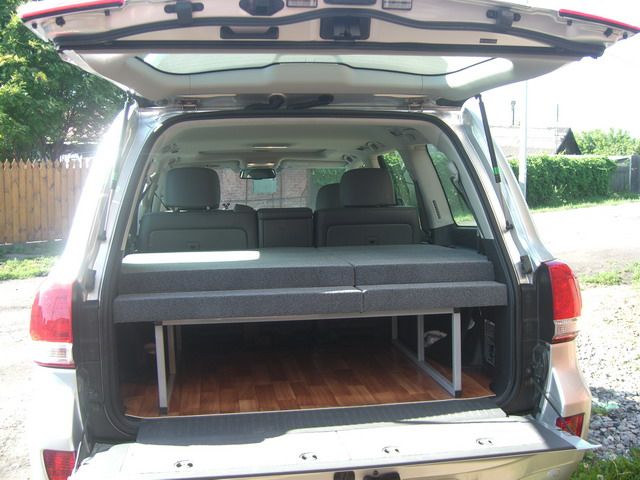

Mark, I actually followed your DYI idea and incorporated a fold-over/down section to achieve MTayors idea above. I meant to say thanks for the inspiration. (as he suggests MTaylor - do a search)
I initially intended to install the shelves and platform over as a temporary mod for an overland tour of New zealand I did last year. So bloody useful I haven't got around to re-installing the seats. Might do it just before I upgrade to the 300 series.

I'm going to do the same but in two sections with legs. Something like the pics in the threads:
http://www.elementownersclub.com/forums/showthread.php?t=54524
http://www.elementownersclub.com/forums/showthread.php?t=62469
I'll put one section over the rear seats folded down and the middle section on top of it for transport. Then when i get to the site i will put the middle seats down and then assemble the middle section and place it over the seats. I will use either threaded pipe or pvc for legs and make a connector to latch the sections together.
I plan to cover all of it and then use a cabelas 3" (48x72") pad on the top of the platform for a perfect fit. There still is plenty of headroom. A couple of window skreenz and i have a nice sleeping setup.
