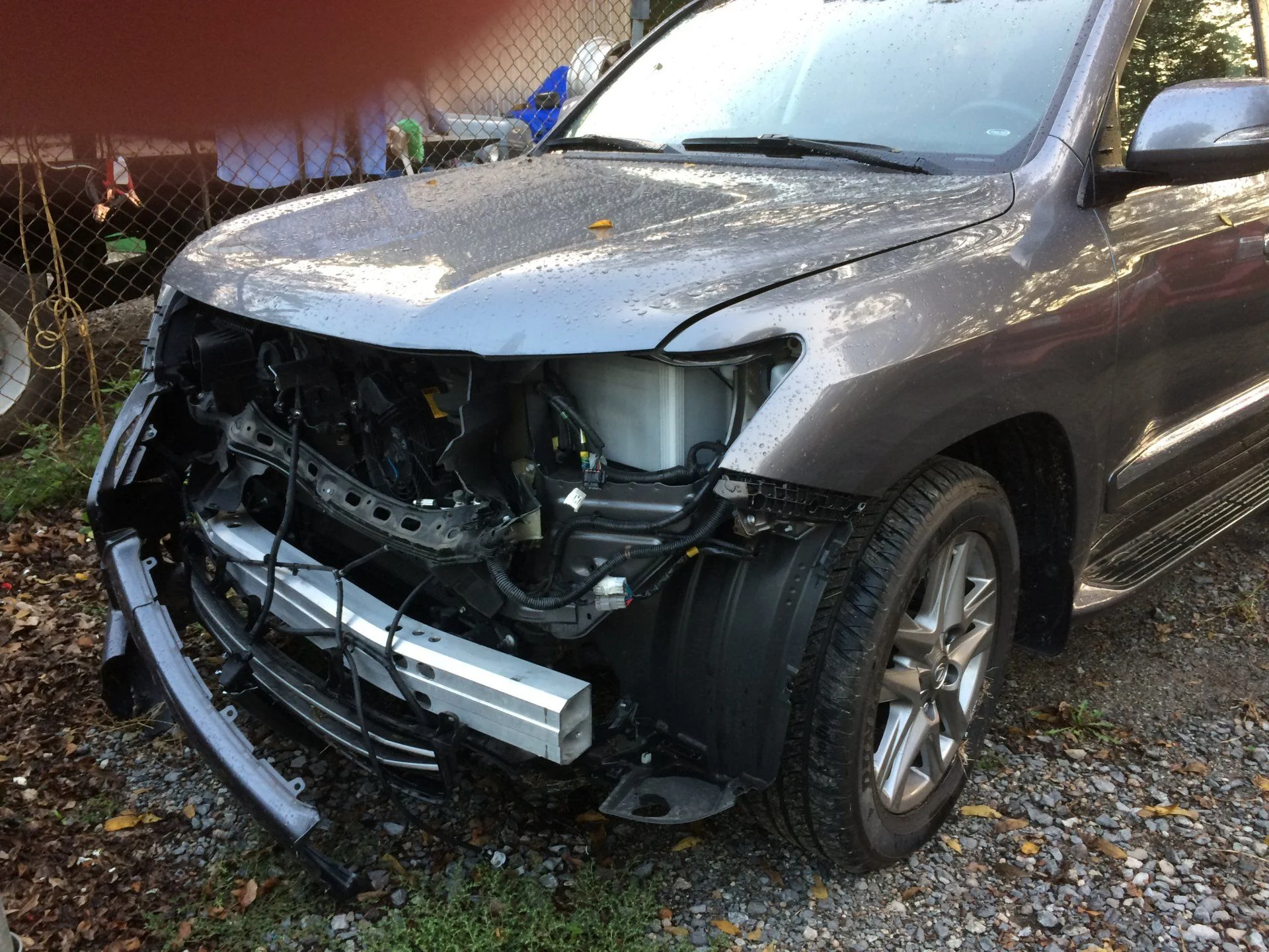

Utah...from that photo-
-Had that deer jumped at the last second, it could have easily been death.
Yikes.

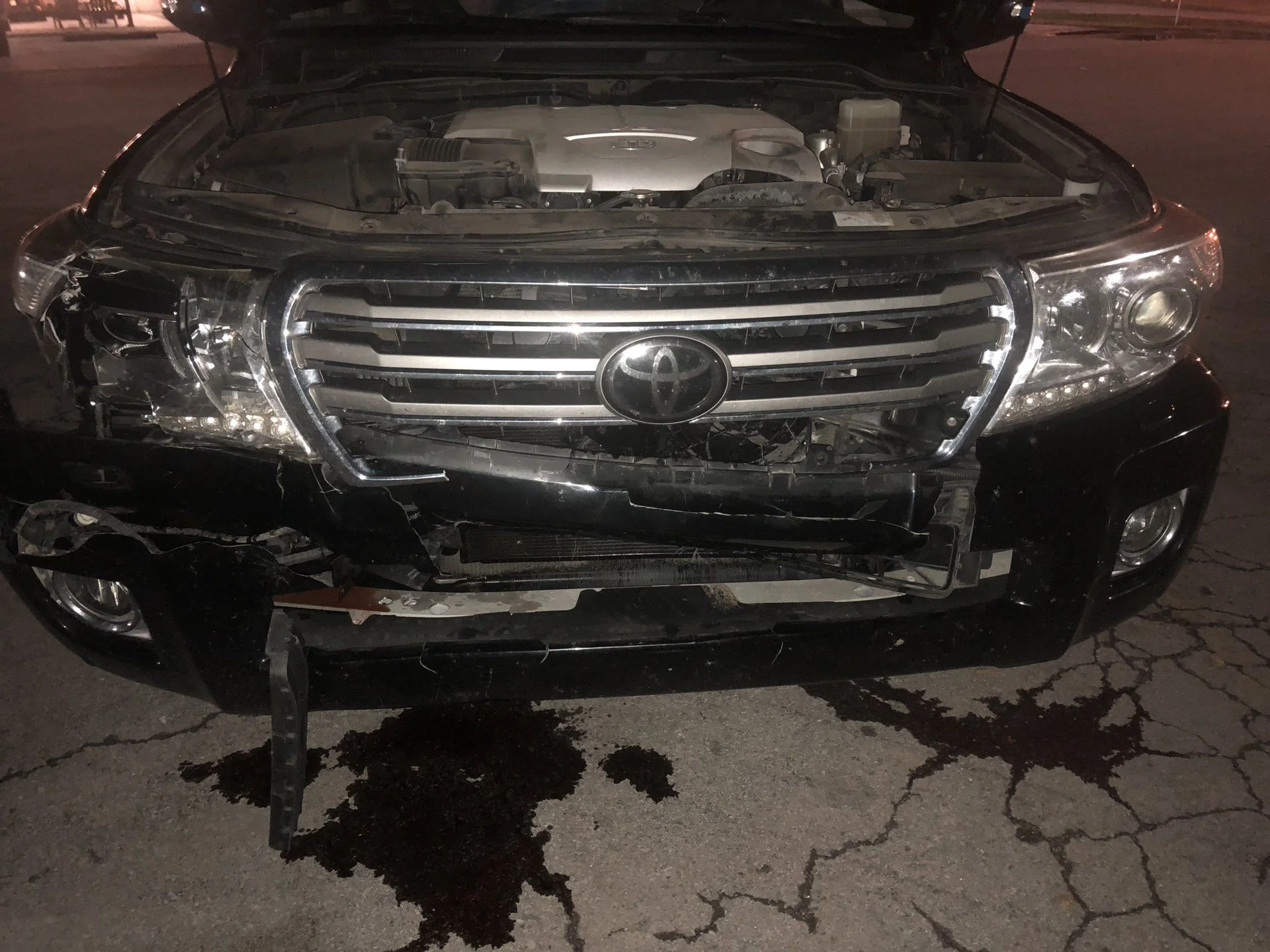

Here’s mine. As long as it’s not totaled I guess it doesn’t matter.
