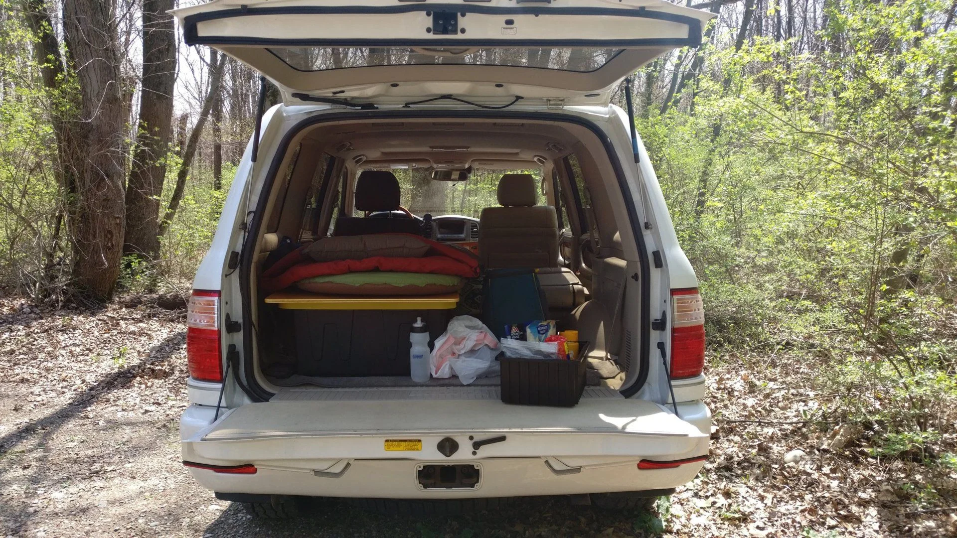

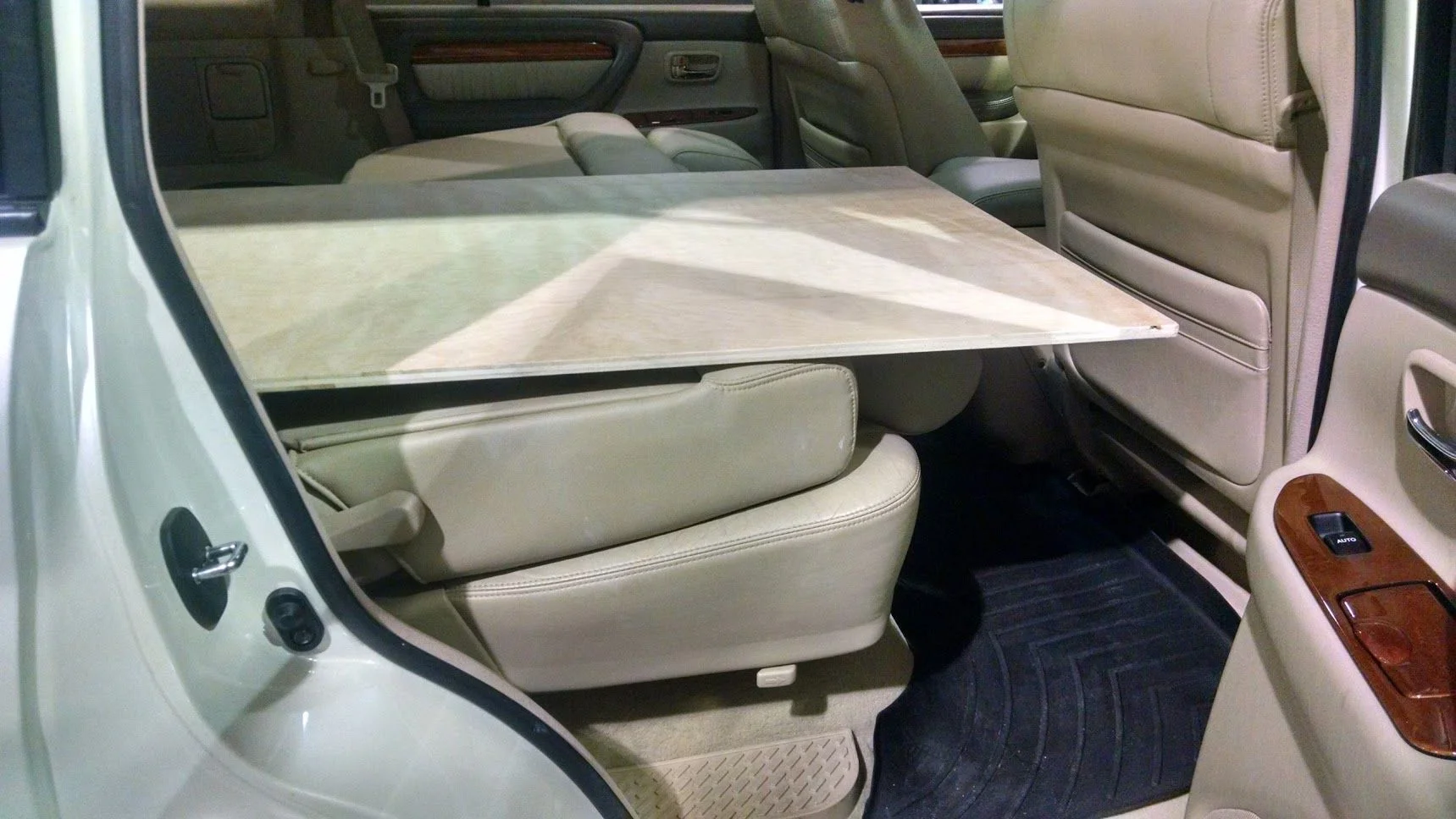

I don't have a 200 series but the 100 is fairly similar. Your idea will work, just need to find the right boxes. I went to local HD and bought a bunch of different totes to see how it would all fit in. Surprise, surprise, the cheapest yellow-top ones are the most robust and exactly the same height as the folded 2nd row. I made a 78" long birch plywood platform. To prevent slippage I just use drawer liner between the seats and the platform. Also a folded blanket under the platform makes for a spacer.
It is all very ghetto but it works really well.
EDIT: These are the totes I used: HDX 17 Gal. Storage Tote in Black-HDX17GONLINE(6) - The Home Depot
