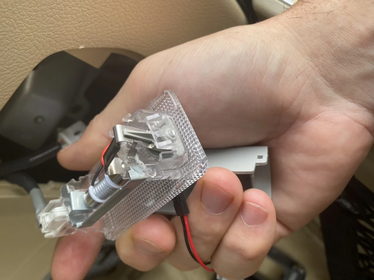

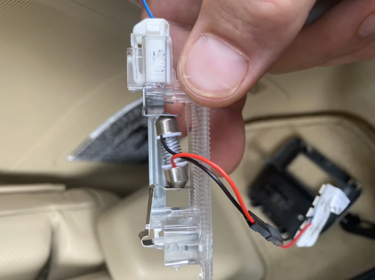

When I install the adapter into the bulb tabs, the adapter is slightly too large and exerts pressure on the metal tab that moves and is attached to the plastic switch and the switch wiper. This pushes the wiper too far away from the contact patch to activate the light.
Here you can see that the adapter is larger than old bulb and forces itself at an angle. At this angle it doesn't even work consistently. It has to actually slide down a little more towards the clear lens before it will turn on every time.
Here is the LED in place with just the regular bulb. You can see the metal tab is touching the led pad. This is the what keeps the light from working at all. Once you put the adapter in, the metal tab is forced into the back of the led.
I see the last user put his LED against the lens like that and his parts, from the front look exactly like mine. Are other people putting the LED panel into the gray shield that goes behind the light?
Also, for sure my tabs are mangled a bit at this point because of all the attempts i made to get the wiper to work properly while the LED adapter was installed. I didn't take a pre-installation picture, so I'm not sure if I've bent it back perfectly to stock. It does work fine with the stock light bulb.

The spring does push the wiper. It is just a little too big. What I did was bend it back the opposite way, creating a little more space by bending the tabs apart (not too much). I bent it back farther than even and that seemed to lodge it in a happy place that works. Hope that helps.
In mine the spring adapter works fine but the metal angle touches the LED panel like in the picture above and it gets knocked out of place. I might remove part of the tape to see if it leaves enough clearance.
I'll give it one more shot. I bent the tabs the first time to try and get it work with the adapter, but didn't come up with a profile that worked consistently. I had to bend it back to get the original light bulb to work again. Ultimately, I didn't want to break the light and also don't really care much as I have never turned that light on before, so not too sure I really care whether it works or not.
I considered soldering the leads form the adapter to the tabs and not installing the adapter, but you do have to have some pressure on the tabs, or the switch won't work. Could possibly leave the old light bulb in and solder the LED. Not sure if that would cause too much amps to be pulled on the circuit, but probably not. That circuit was definitely connected to the puddle lights (accidentally blew the fuse in trying to fit the LED in rear the first time), so replacing all the other incandescent bulbs with the LEDs has probably already reduced the current draw on that circuit.

So most people have had no issues with the bending of the metal contacts to make the panel work. When the kits were tested and I rolled them out a lot of the people who got them had no issues however, they may have gotten lucky with the way they bent the tabs for that cargo area.
I cannot say you’re doing anything wrong but I would recommend bending the side away from the metal contact for the switch then inserting first (while adapter is compressed) from the side you just bent so that that contact remains in place. Do not over-exert the “bending” as you might snap something off.
