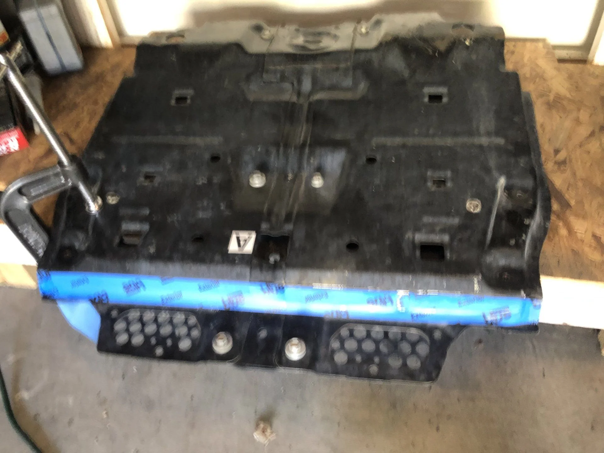

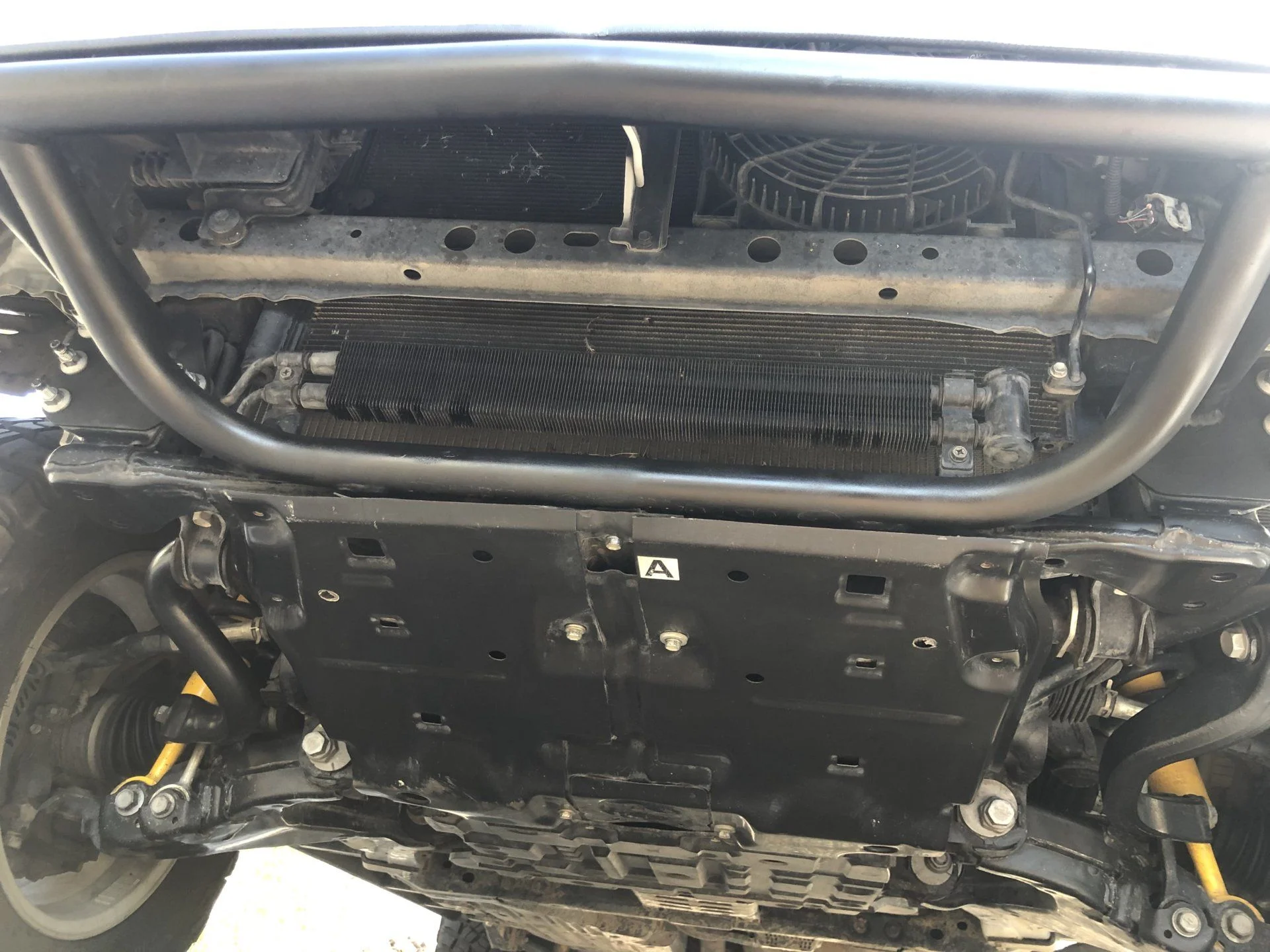

Had to cut off the front of the stock skids to accommodate the new bumper mounting.
Also removed the tow hooks for some slippery approach angle smoothness.
Living in Phoenix my biggest hazards are giant rocks so I’m thinking without a skid blocking this hole will do ok until I can get one.

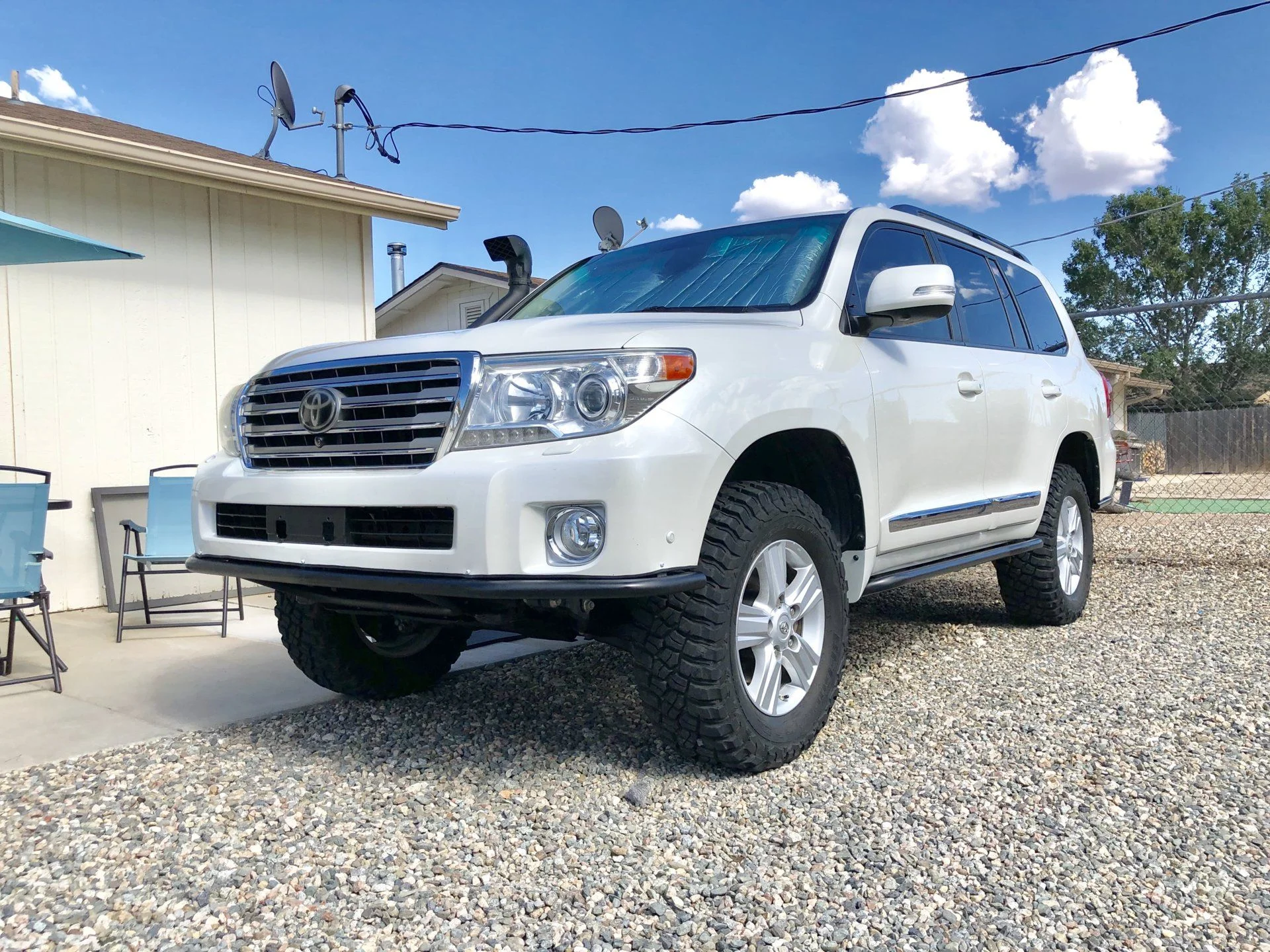

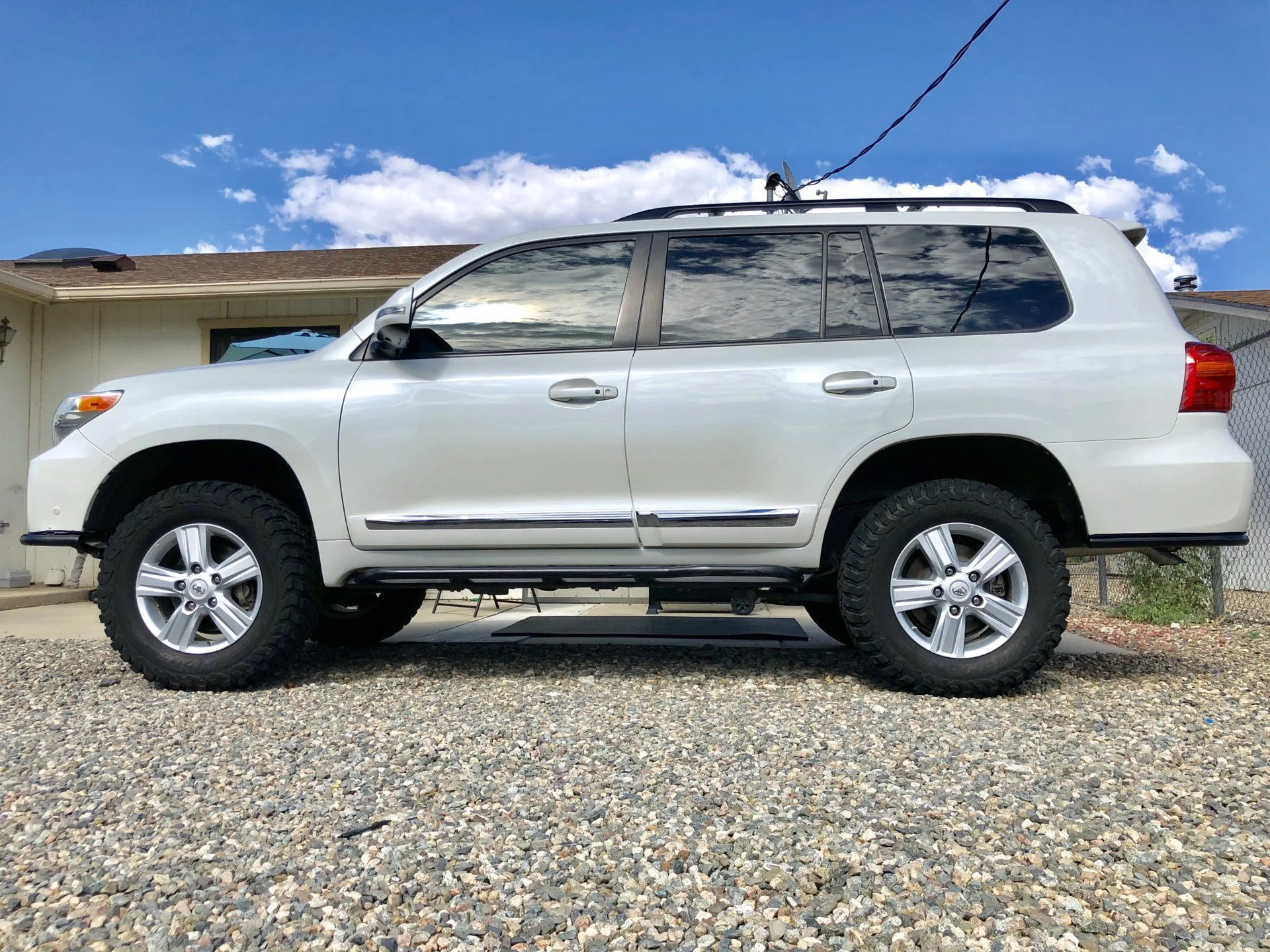

All washed up!

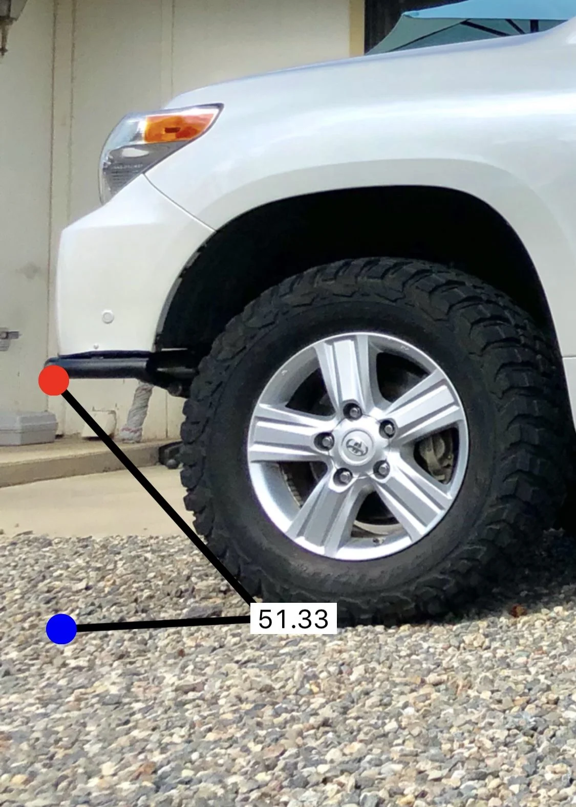

I found an app to measure angles on pictures (realizing it’s not 100% accurate but in the ball park) and measured the new approach and departure angles.
Much better than stock!
And when those angles aren’t enough, I can scraaaaaaape along. Haha
My ground clearance improved 7 inches for the front and 9 inches (directly behind rear tires was most dramatic) in the rear.
The ground clearance is now an even 24 inches at the bumpers.

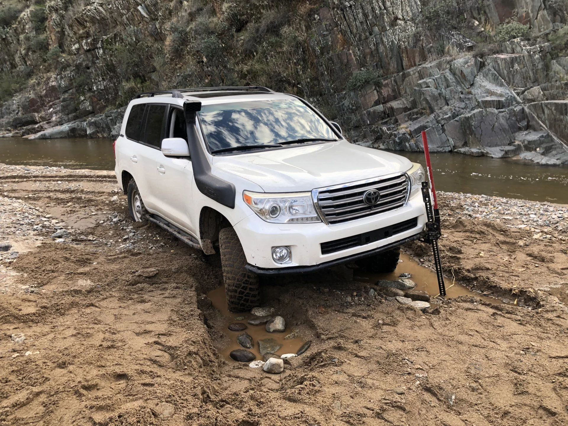

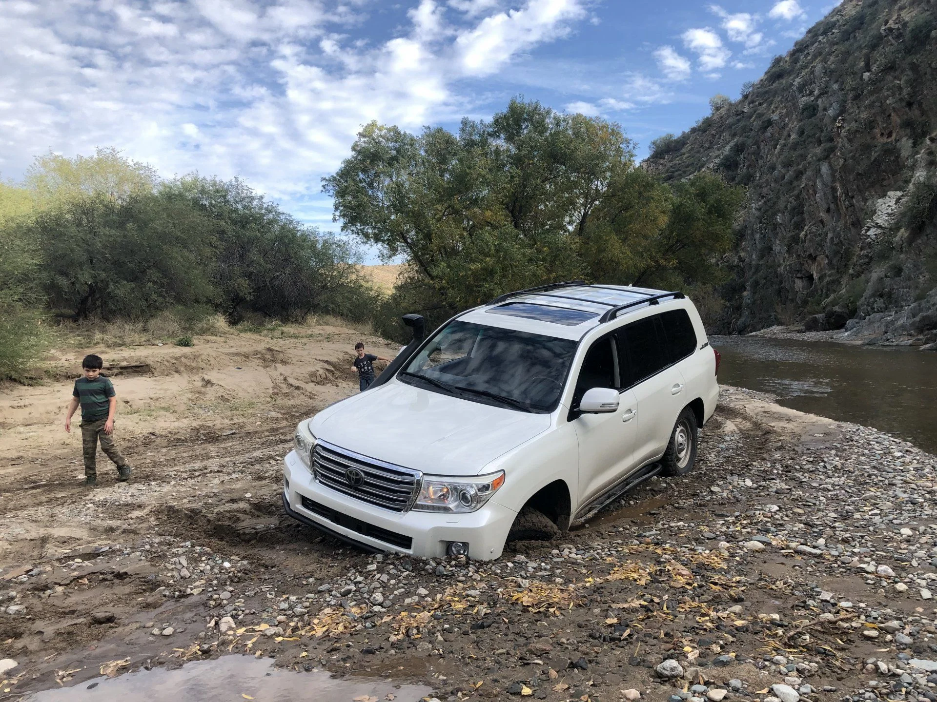

It’s great! No issues at all. It even came in handy getting me unstuck recently! Highly reccomend!View attachment 2498312View attachment 2498313
