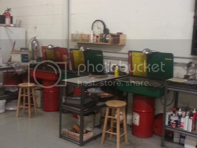

here's a shot of the 3 stage cleaning process they have

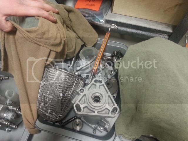

(Not my pump, but a smiliar one to mine all apart/cleaned and ready for reassemble..)

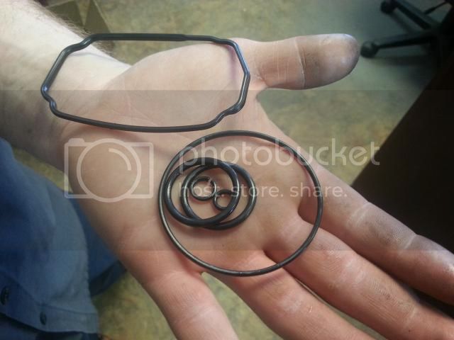

the original seals, very brittle from age (23 yrs..), and the source of the leaks..

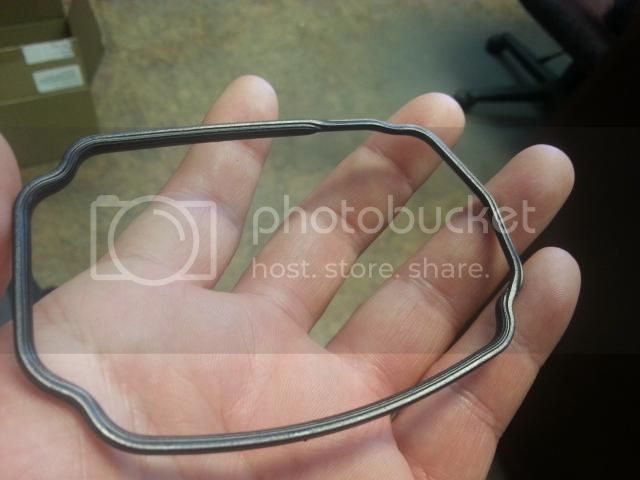

one main seal that was twisted (either it wasn't installed perfectly from the factory, or maybe the IP did get serviced in japan once..?)

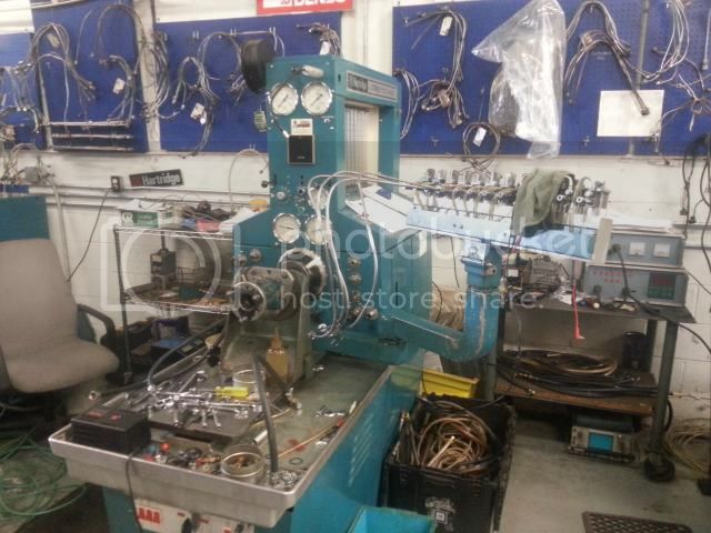

and here's the IP test bench where all the fine tuning happens (looks very complicated!)

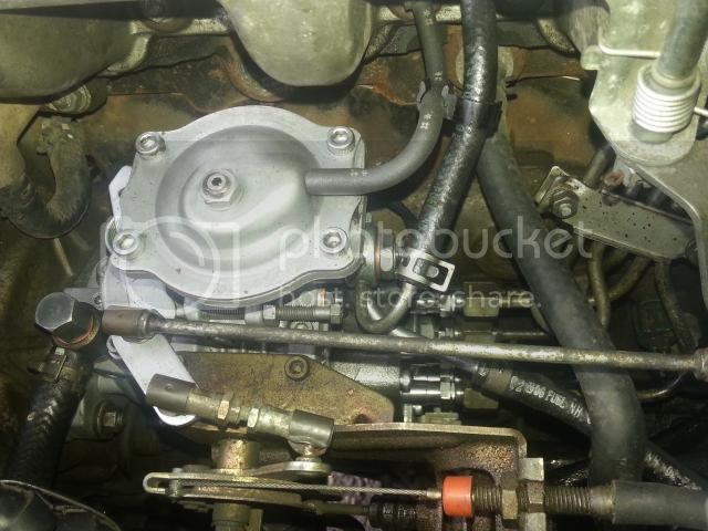

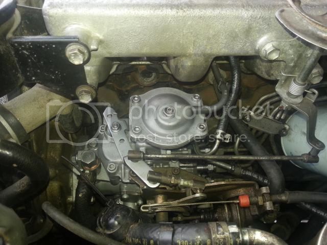

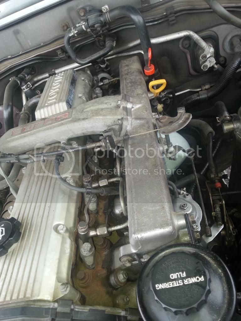

and here's the finished product installed
