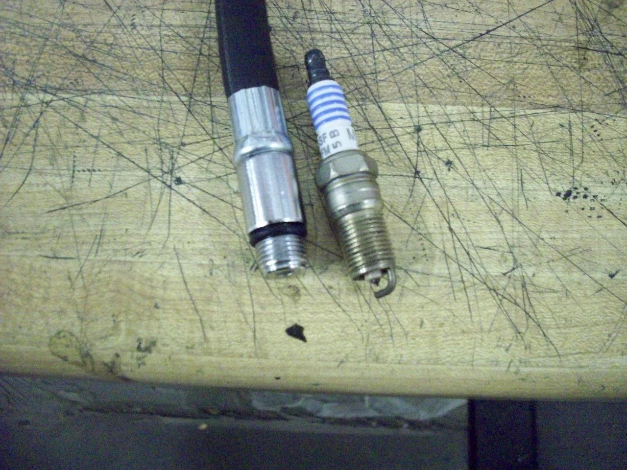

So I watched a couple videos on leak down testing. I decided this tool was worth the investment for a cheapie from Harbor Freight. I may regret that. I can't seem to get it screwed into the cylinder. The threads seem short and the spark plug hole seems long and narrow. Am I doing something wrong, or is there a work around someone can tell me.
It's just using the orings the seal and doesn't have to reach the cumbustion chamber. The rubber hose makes it hard to get the angle right to get the treads started. No tricks that I can think of. I don't think my buddy has any 3l parts but all ask.
