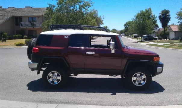

Just installed the fronts. Took it out for a very brief drive, didn't seem any stiffer to me. Then again I don't drive it all that much, and anything is soft compared to my 40. The fronts only leveled it out nicely, at this point I'm wondering if I should bother with the rear springs.
Sigh. Yeah for liquidation sale :( The kit from proffits was supposed to be 886 fronts and 895 rears, as the box and part number of the kit indicated. Unfortunately the fronts were 885's (tag on the spring) which I didn't notice until after installing them, not that I could have returned them anyhow. Oh well front 885 and stock rears sit level, and gives some more clearance for the front tires. I'll just have to source some 886 fronts, and install the 895 rears, when I add front and rear bumpers and a skid plate.
