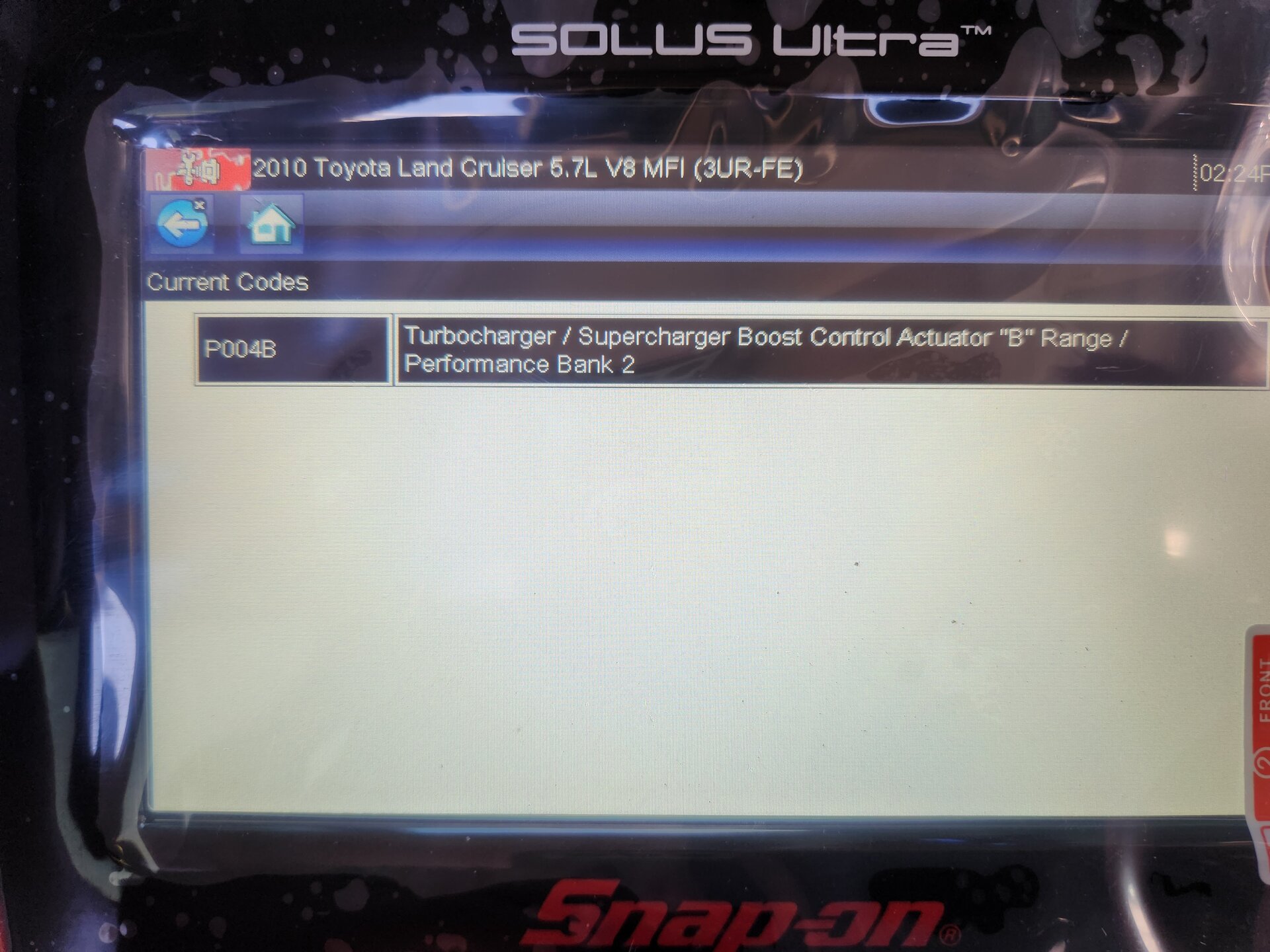

Turbo bank 2 actuator fault

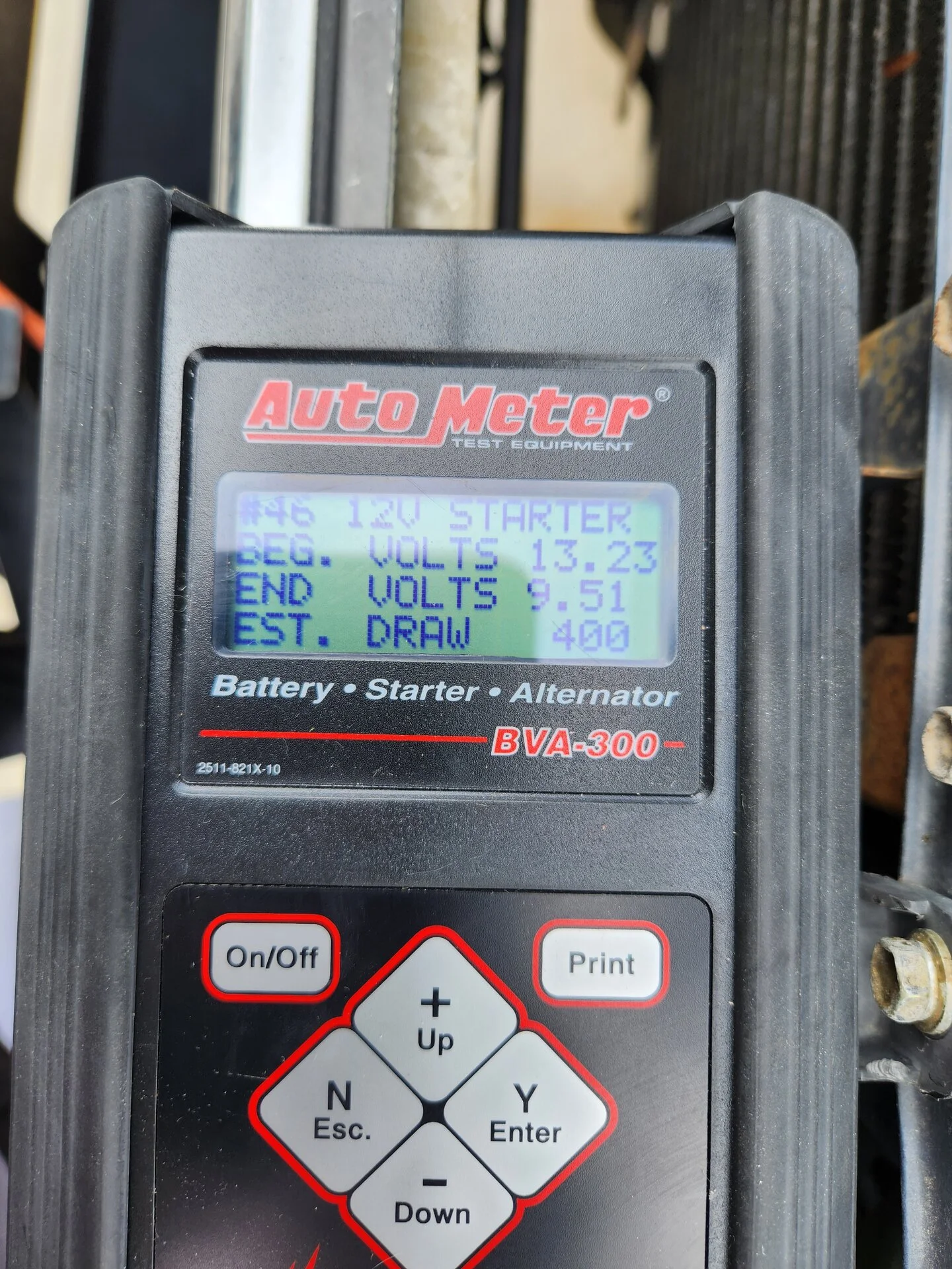

Possibly a starter pulling to many amps or weird ground

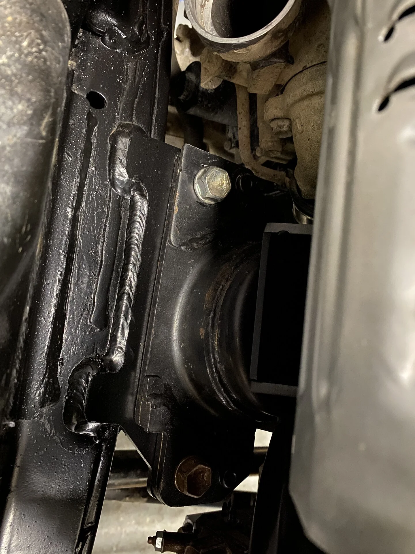

Not being overly familiar with the 80 Series, are the frame rails wide enough to accommodate the dual turbos on the V8?
Were you able to use the 80 Series frame mounts or did you salvage those from the 200 Series donor?

since it's so tight, have a look at the two connectors that plug into the turbo to check that one isn't bent over or broken. They're hella fragile.
on the front left side of the engine, above the AC compressor, there's a 6 wire plug there too that feeds the turbo on the left side. IT can get caked with oil and debris. Gold plated connectors too, if i recall.
