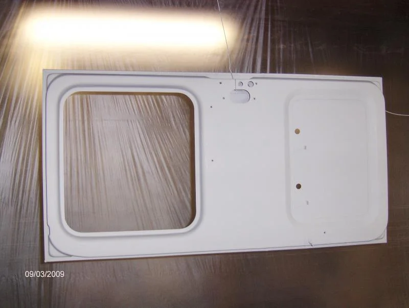

here are some of the pictures. hope you find them useful...
there is a place called APS, i dont know if you have them in your location. Its an auto paint specialty store and they were able to take a picture of a sample piece i brought in and mix it right there. it is a single stage acrylic enamil and i payed about 350$ with everyhting for it. i think if you google Automotive Paint Specialists it might be some help
