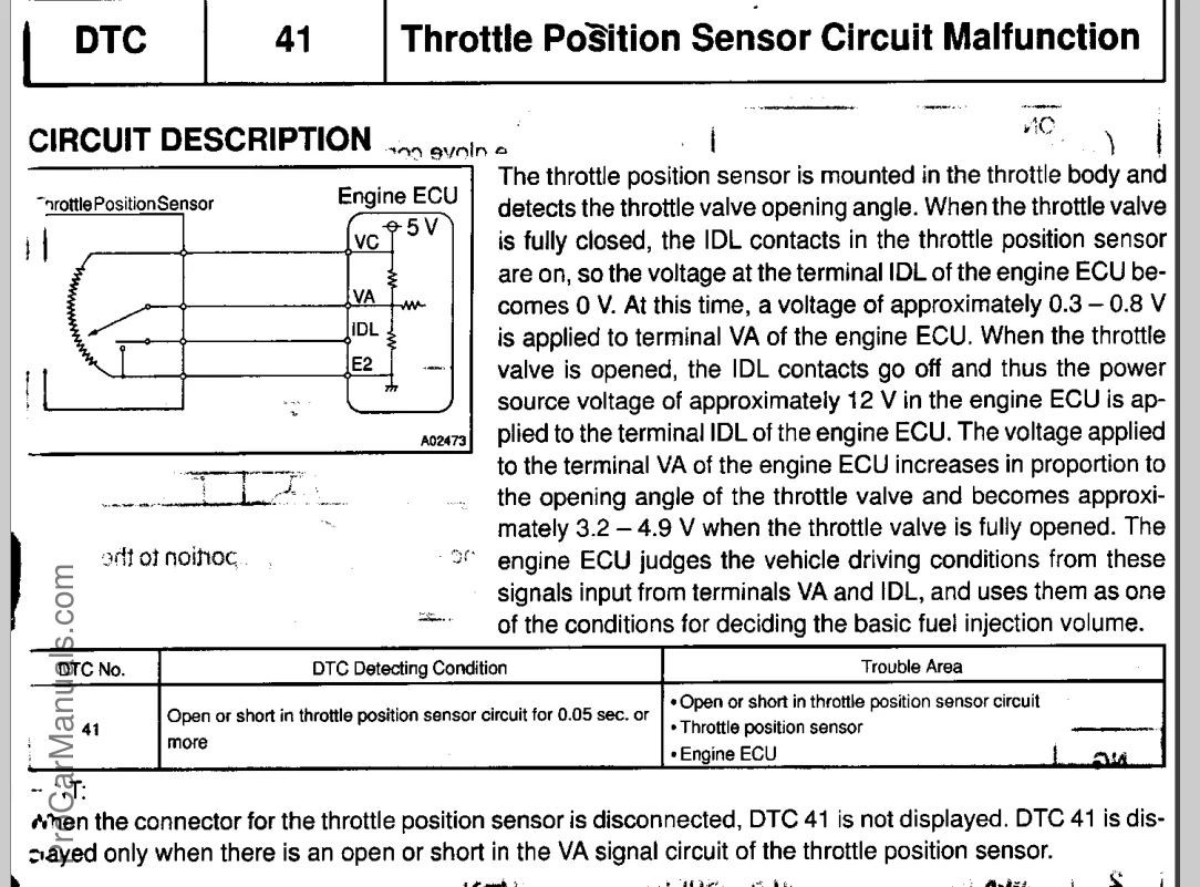

Thanks for your response. Sounds like it's not worth touching, which is a bummer. I spoke to an auto electrician the other day and he confirmed that as well. He was saying the TPS also operates the auto transmission so yes, like you say it is important. The auto trans can be controlled by a standalone control box but that is getting in to the "too hard" category for me. I found this information that explains the purpose of the TPS for anyone interested...
