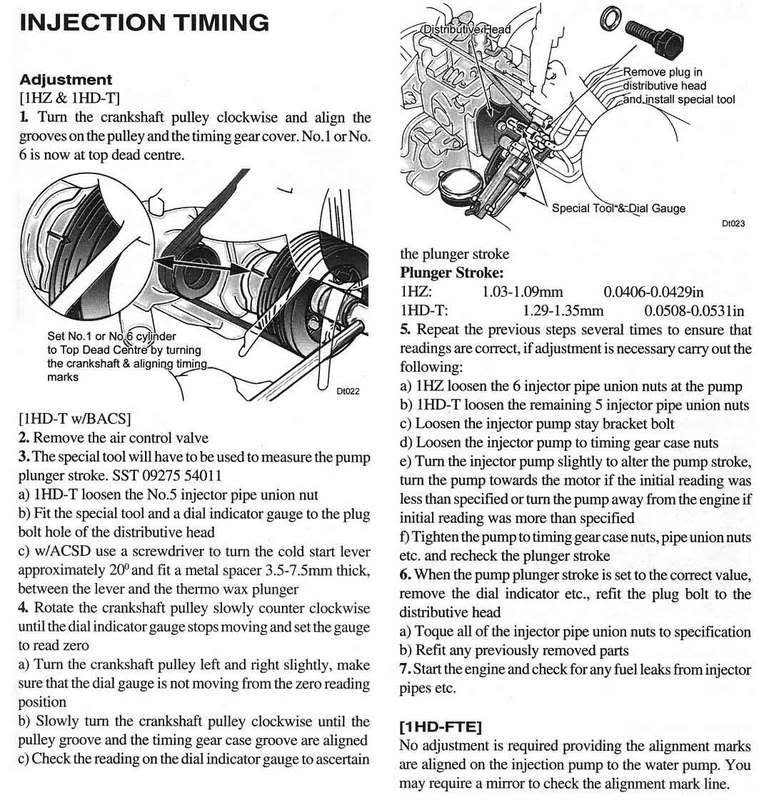

My main question is can I install the pump using factory alignment marks and will it still need to be timed? I am pretty sure it will have to be but am looking for past experience on this. The pump I will be installing is new and not a rebuild.

If you go ahead and put the pump on, yes you can just align the marks. This will be good enough to get it to someone who has the gauge to adjust the timing to its proper specs. After that, they will have to adjust it by dyno or "by feel" for the turbo.
If you like, you can buy the gauge and do it yourself.

This instruction sheet might help if you don't have it. BTW, if you decide to junk the old one, I might be interested in the plunger. Apparently it is supposed to be a 13 mm compared to the 11 mm in the zexel for the Patrol. I beleive it is a strait bolt in for a fuel shop and is one of the best post turbo mods for a aftermaket turboed TD4.2. Good luck, John
