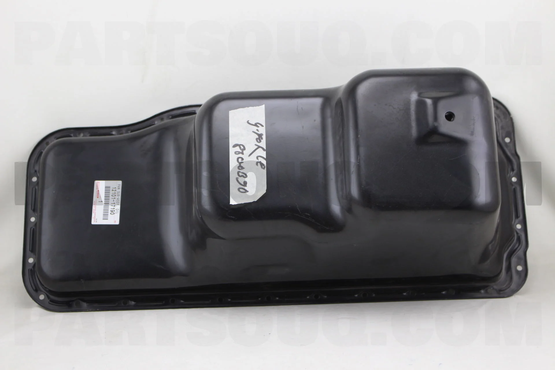

12101-17190 and its corresponding pickup looked like they were available though

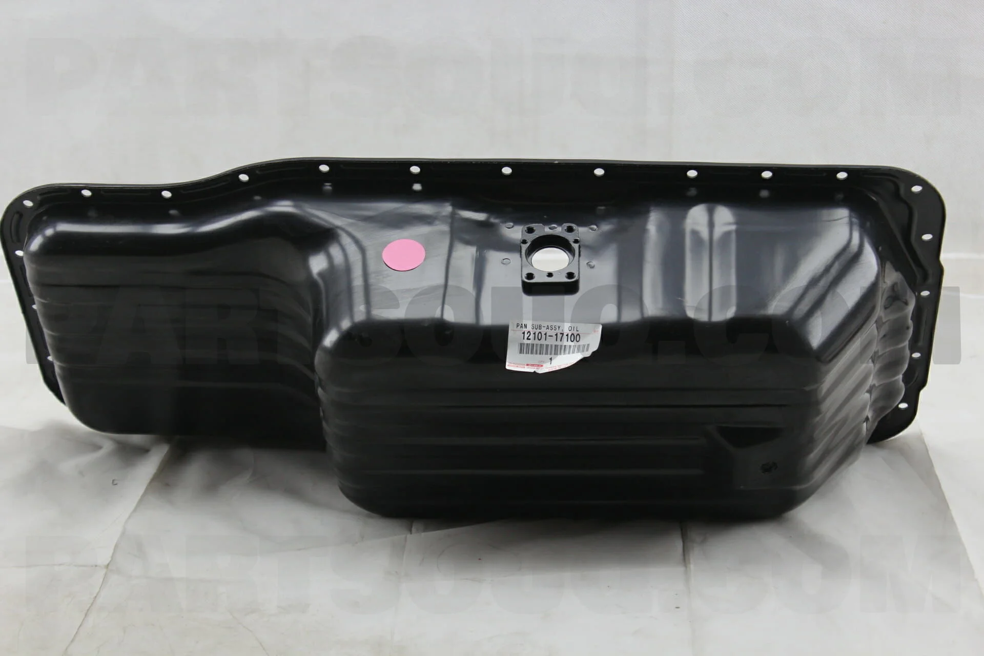

I ended up ordering 17100, which looks to have the same pan shape as what came off of my rig
Just have to weld a patch over that sensor hole.
I also ordered the 17190 and matching pickup, but it looks like it'll hang down and be more vulnerable:
