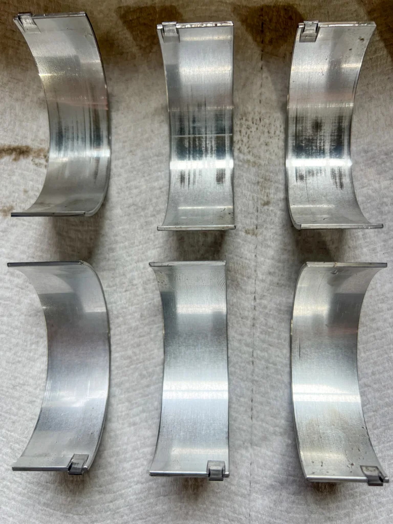

My 1HDT has about 250k miles on it. I've put about 55k of that on it. In that time I have run 3 sets of BEBs on the truck. Always the same pattern: The bottom halves look fine and the top halves are hammered out a bit.

Below is a pic of the last set that I took out (OEM crank matched with 15k miles on them,. Cyl 1/2/3 shown, 4/5/6 were the same).
I'm pretty sure the tighter ACL will be too tight by ACL's spec which is tighter then Toyota. but if you had numbers of what your clearances are that would help. what year is your engine? there are 3 piston variations and at least 2 different wrist pin weights, I think these could be factors. what oil do you run? the clicking noise is only when warmed up? have you measured oil pressure with a gauge? there is a oil restrictor between the block and head that could be missing or the oil pressure relief spring could be broken/tired if pressure is low. A new spring is cheap might be a little hard to install with the engine in the truck i haven't tried.

I’ll dig into that paper over coffee tomorrow. But other than the 195k mile original BEBs I pulled, I haven’t seen signs of cavitation. That was all on the lower bearings for that.

I haven't heard the noise in person but it sounds like you can just keep running it those bearings look pretty good from here.

One thing you could do is send in your old bearings to get coated. You can request them to be a coated to such thickness that will bring you close to the minimum spec for clearance, i would prob rather do this with OEM or tahilo, as ACL is asking for looser tolerance (maybe their bearings expand more with heat? IDK. I did the coating myself on my build. Not sure if the cavitation forces will rip the coating off the bearing or not.
