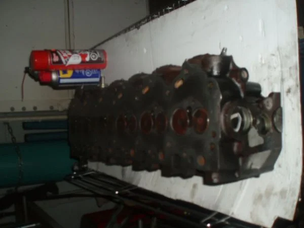

So the reading are well with in spec. I have the intake and the turbo off and will remove the head tonight. so if anyone want to see the guts of a hdj81 I will start working on it after 3 30. 10019 galaran road sidney. Thanks Ken for your help and for letting me mod you glow plug adapter to fit 10x1.25
next up date will have pics I hope. and the cause of the problem
