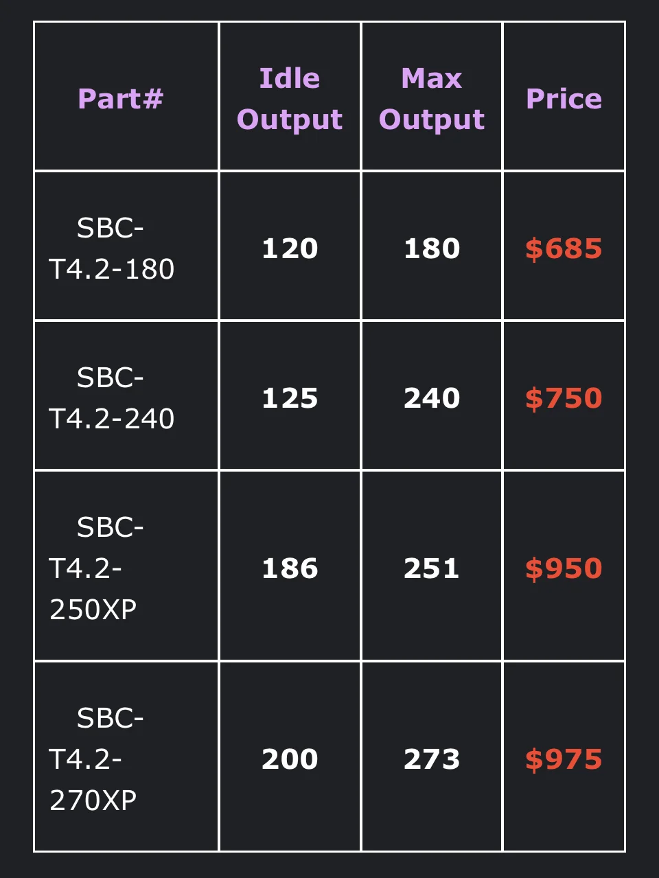

I was in a hurry to replace the alternator for a trip but I was originally hoping for a higher amp unit. I contacted M2K about the pricing for some of their high output alternators but they didn’t respond quick enough to meet my timeframe. I figured I’d post the quotes they gave me at the time in case anyone else is looking since they don’t list prices on their website.
