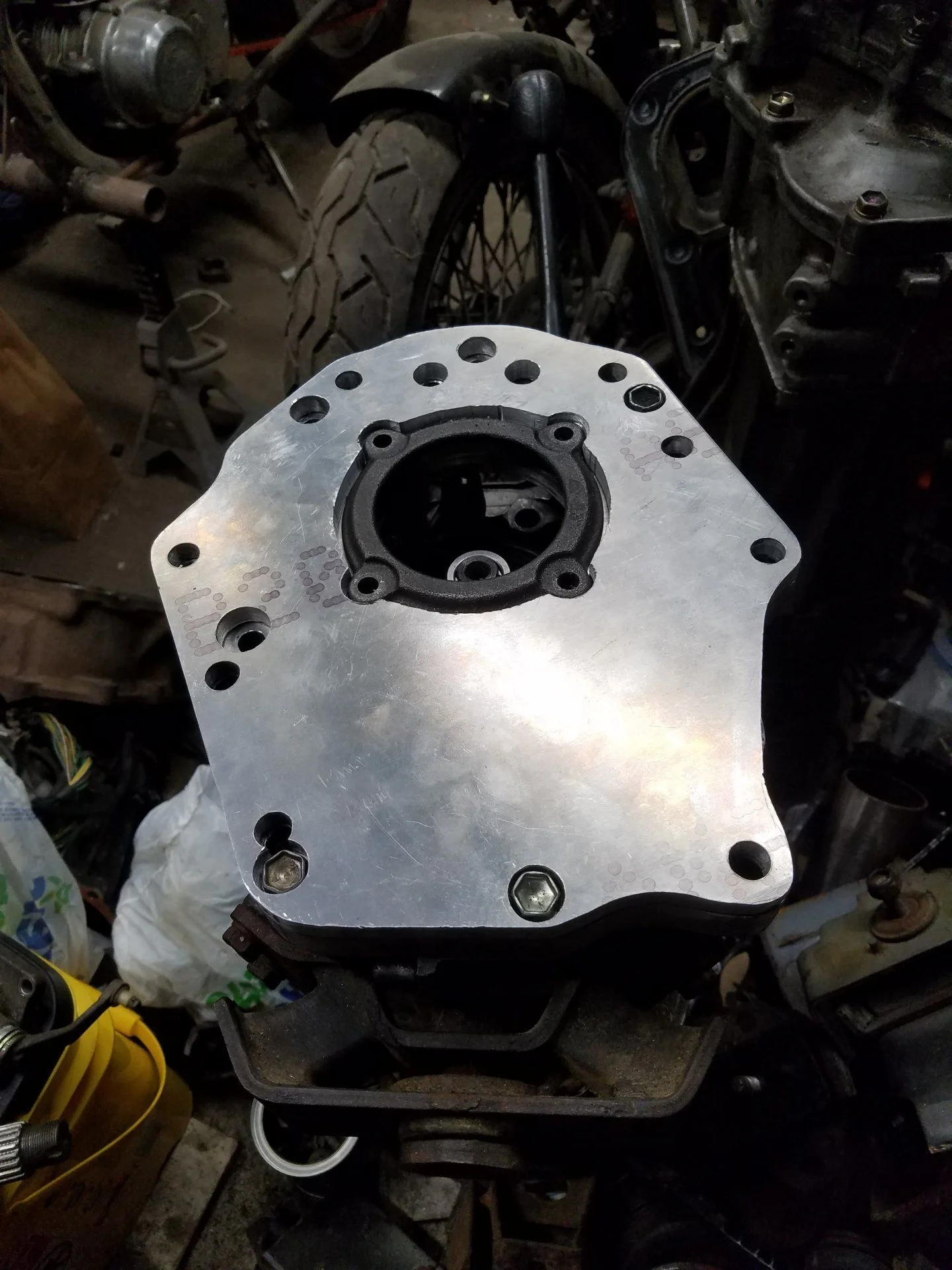

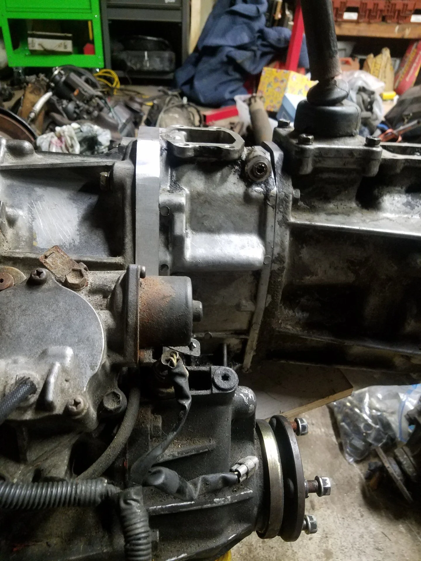

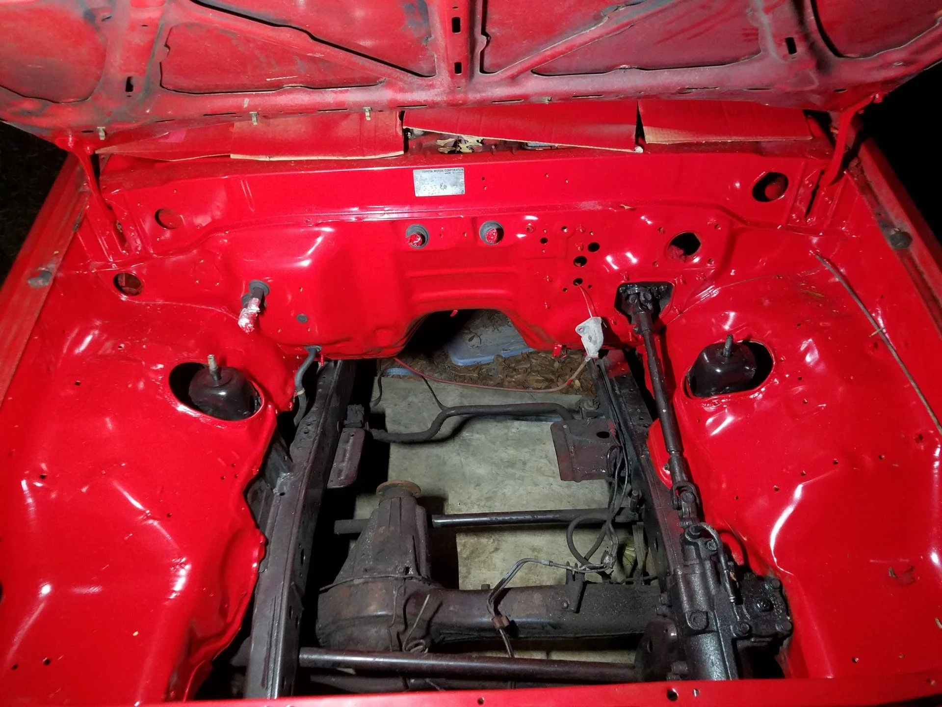

I've had a little bit of free time. Stuffing an 87 4Runner onto an fj80 frame.... using the hf2 transfer case, mated to an R151 with a 3rz and a Mercedes m62 supercharger. Had the adapter plate made, still need the spines cut for the shaft....

Wow!
Its nice to see someone making something again, rather than buying it, even better when it doesn't exist to buy. Reminds me of the good ol days of wheeling.
Dang, that sounds awesome!
Would love to watch this animal progress.
The project is pretty cool.

as far as putting the transmission and transfer case together. I still have to find some place that will cut the shaft for me. I got the plate water jetted using a zero taper process with big blue saw in Atlanta. They emailed me a couple of places that do small jobs. I just haven't had the cash yet
