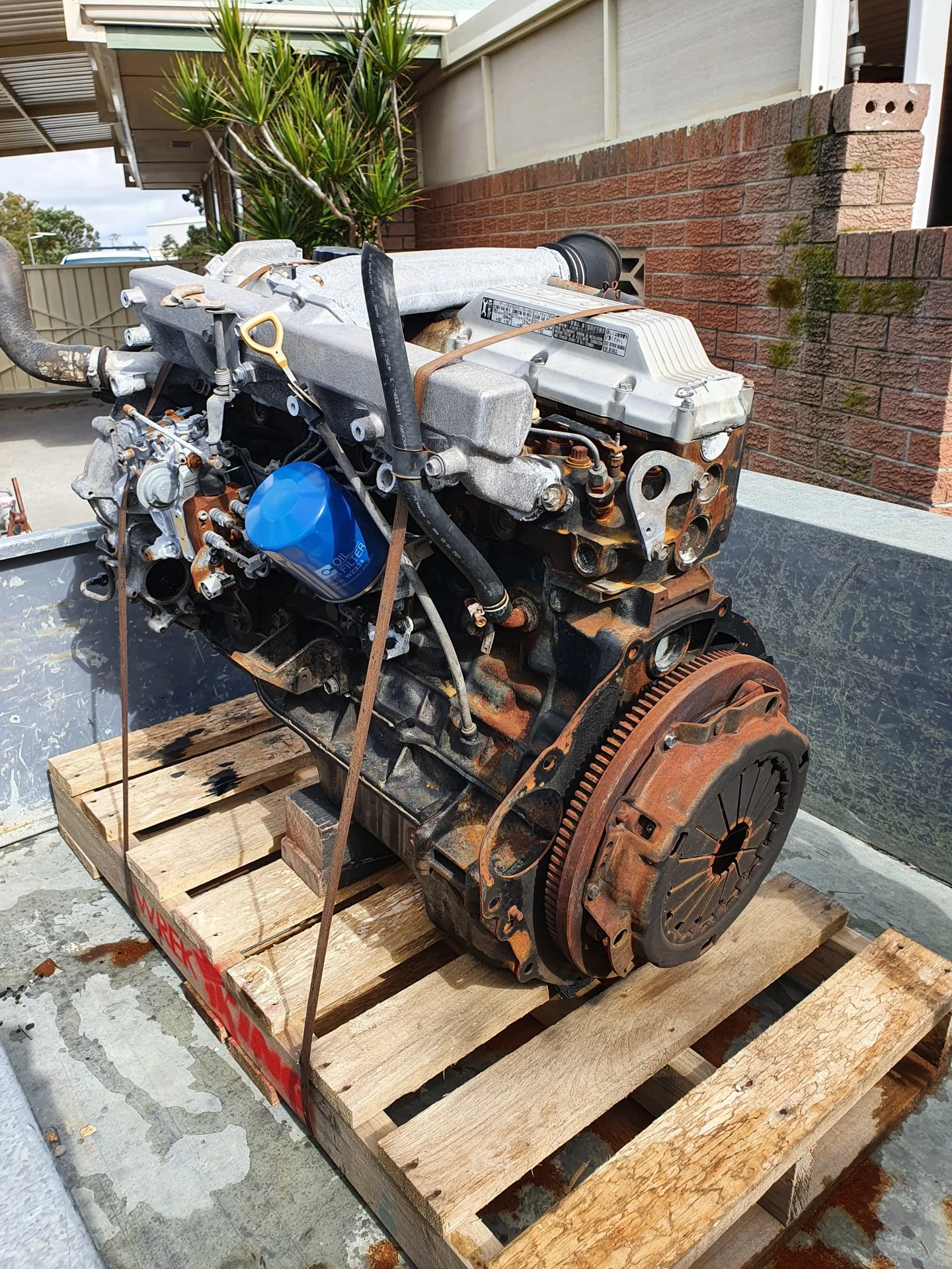

Engine as it currently sits waiting to go to Gturbo for new everything...
So I got a call from the engine builders and turns out the engine has a cracked piston - not totally surprised by this. I bought it without a exhaust manifold so I kinda thought it might have had a turbo on it at one stage, and dodgy turbo jobs on the 1HZ almost always lead to cracked pistons. Anyways I have my first lot of parts, I'm going to swap out all the suspension while I'm at it.

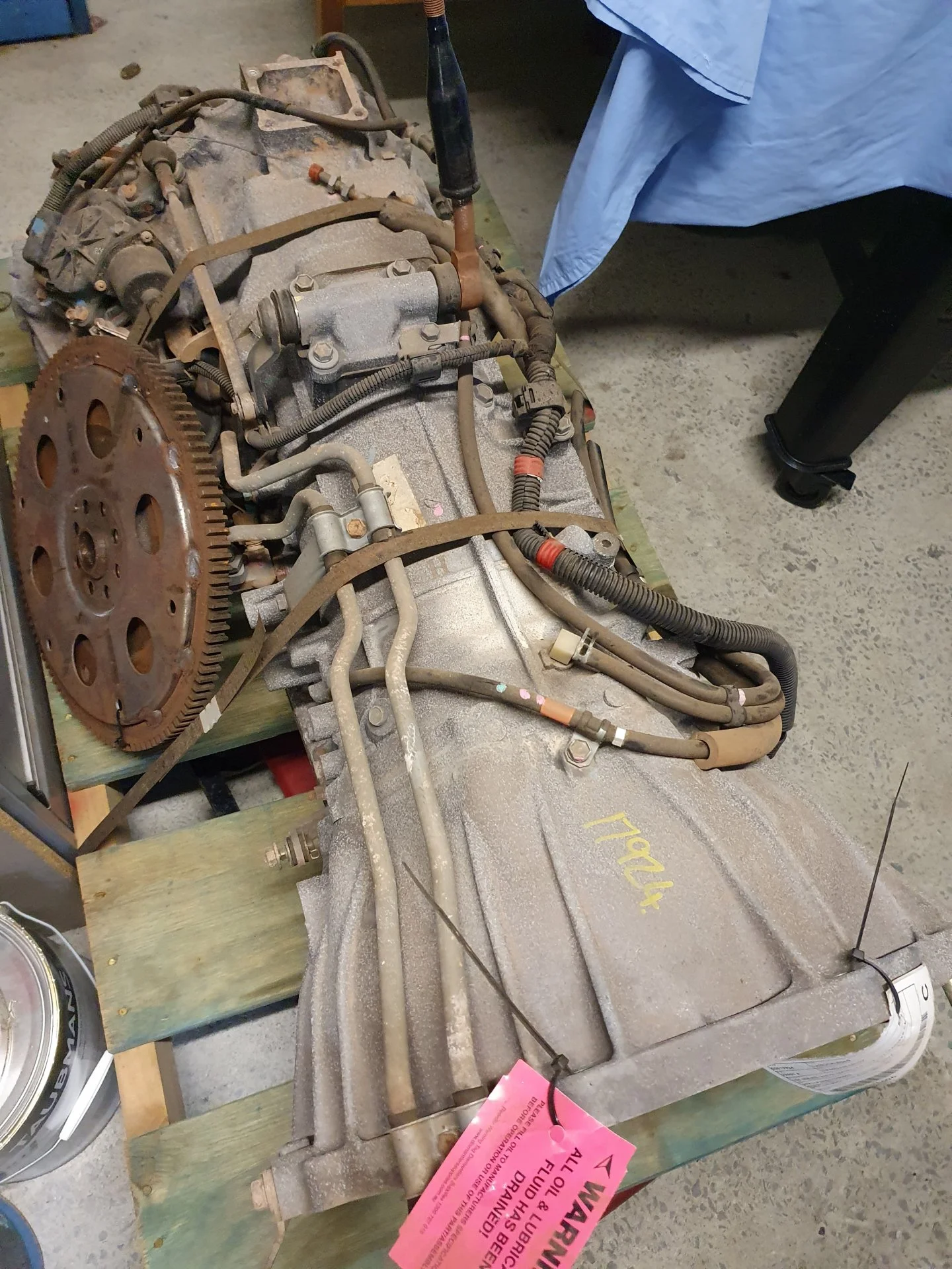

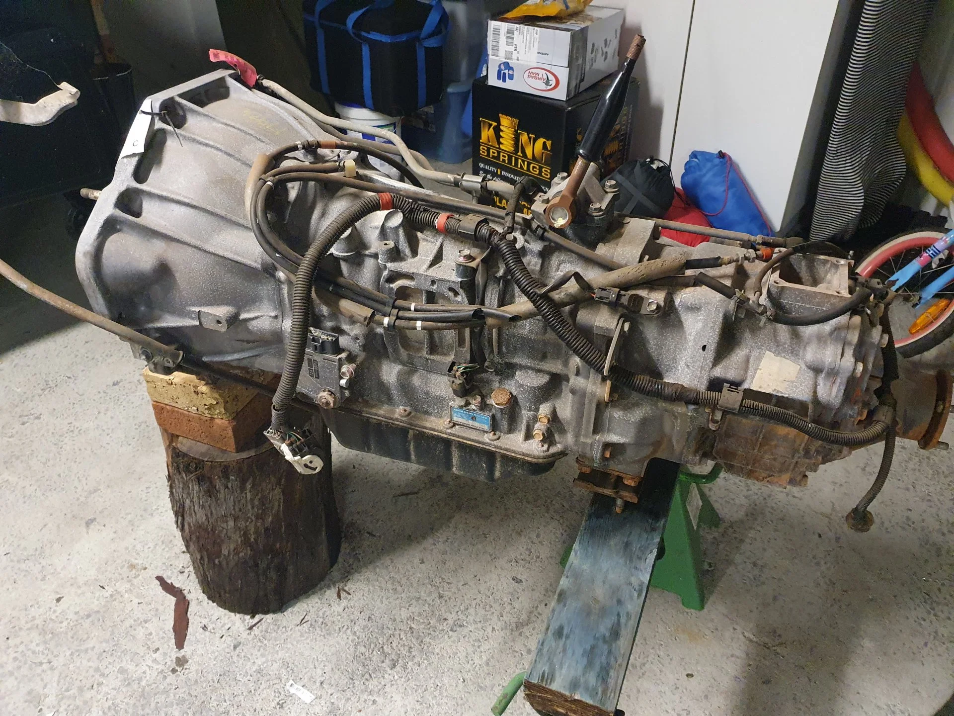

And I have the A442 trans from behind 1HZ now at home too.

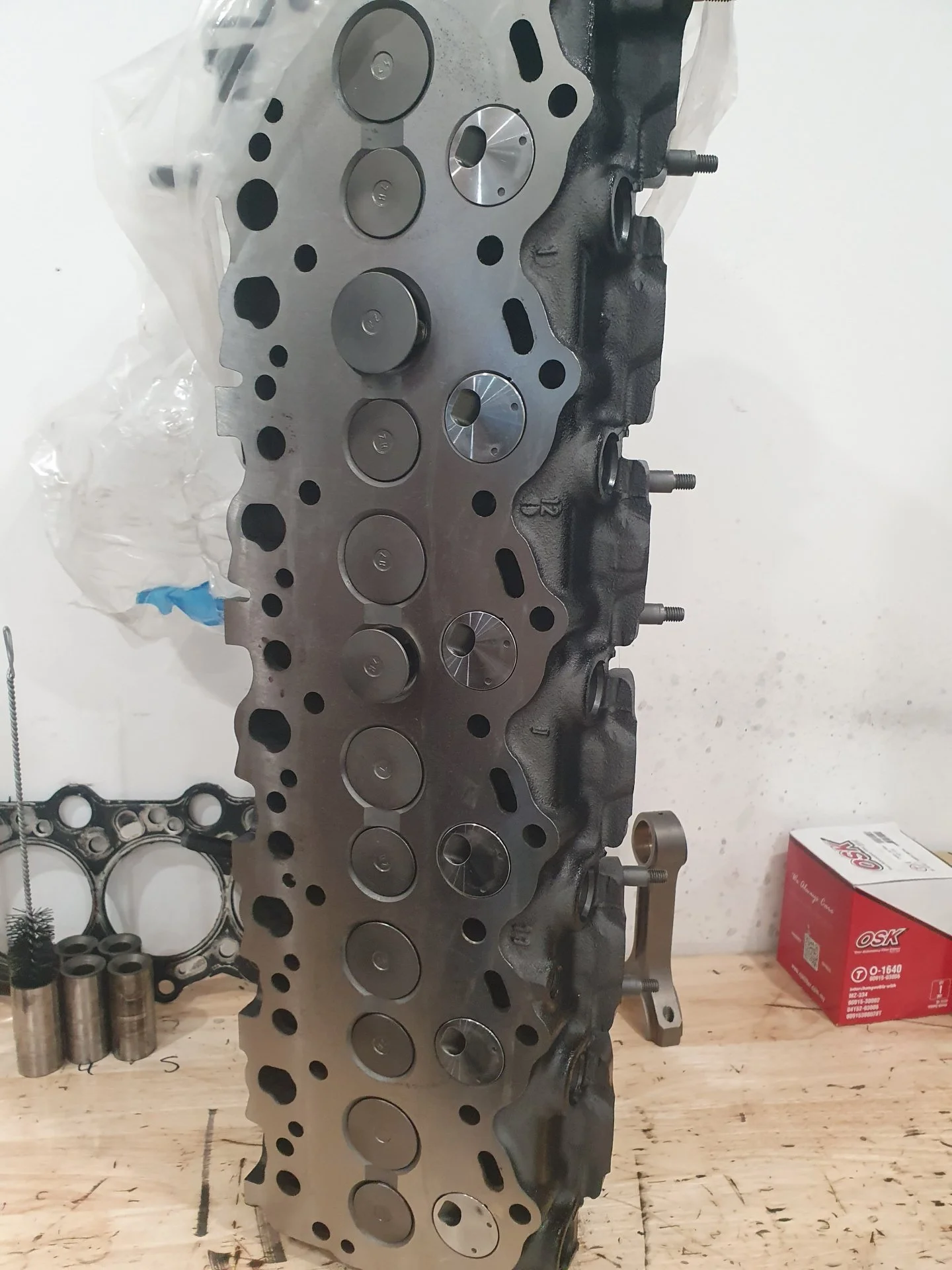

So instead, I'm keeping the factory block, crank, head, etc and installing HD rods, billet custom pistons with oil cooling, and fitting new billet pre-comp chambers in the head. Also swapping out head bolts for a stud kit, and upgraded head gasket, and ACL race bearings everywhere. On the outside a 12mm pump and turbo injectors, plus a red wheel gturbo @ 26psi. Target at the wheels is 170kw/650nm
UPDATE.

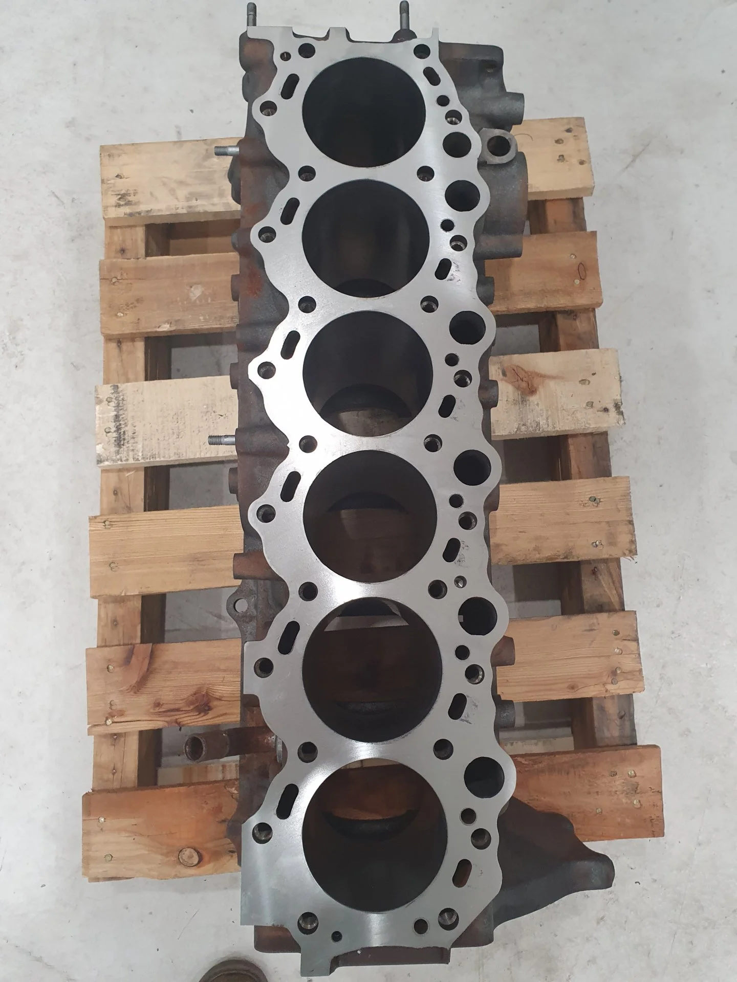

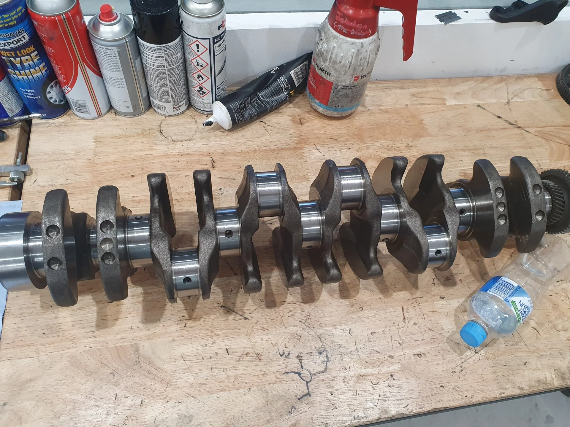

Got all the integral parts back from the machine shop, and all is ready for assembly. 12mm Pump has arrived as has the injectors, pistons and rods. So hoping to get the fully assembled engine back from gturbo in a couple of weeks. Stay tuned.

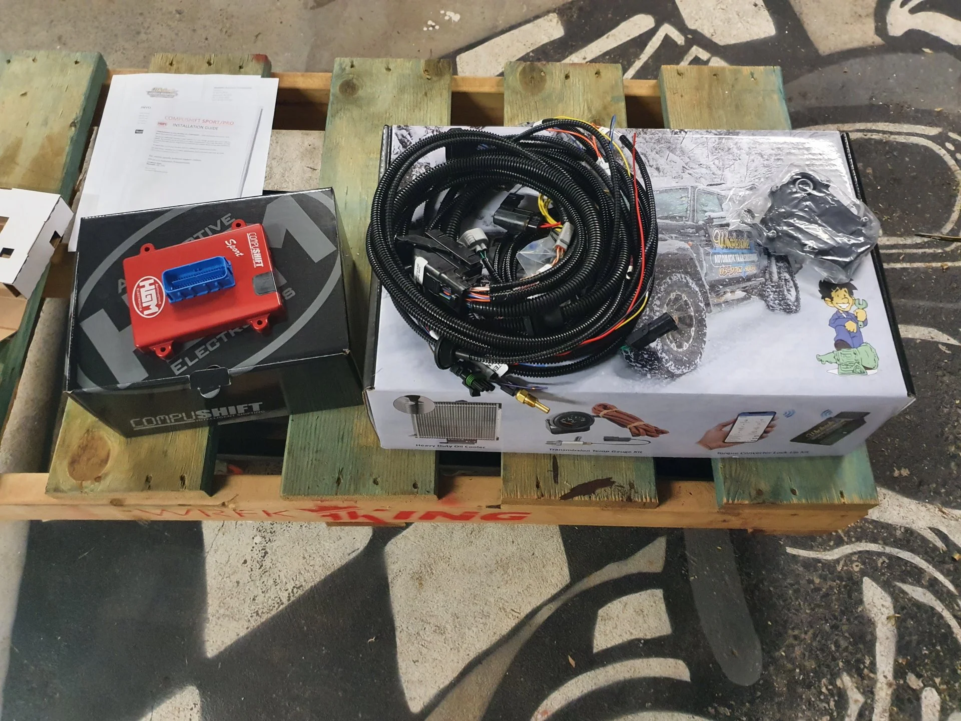

Got the trans harness and TCM, and the new valve body, got some work to do getting the trans ready while I wait for the engine. Finally stop scrolling and searching and get my hands dirty...

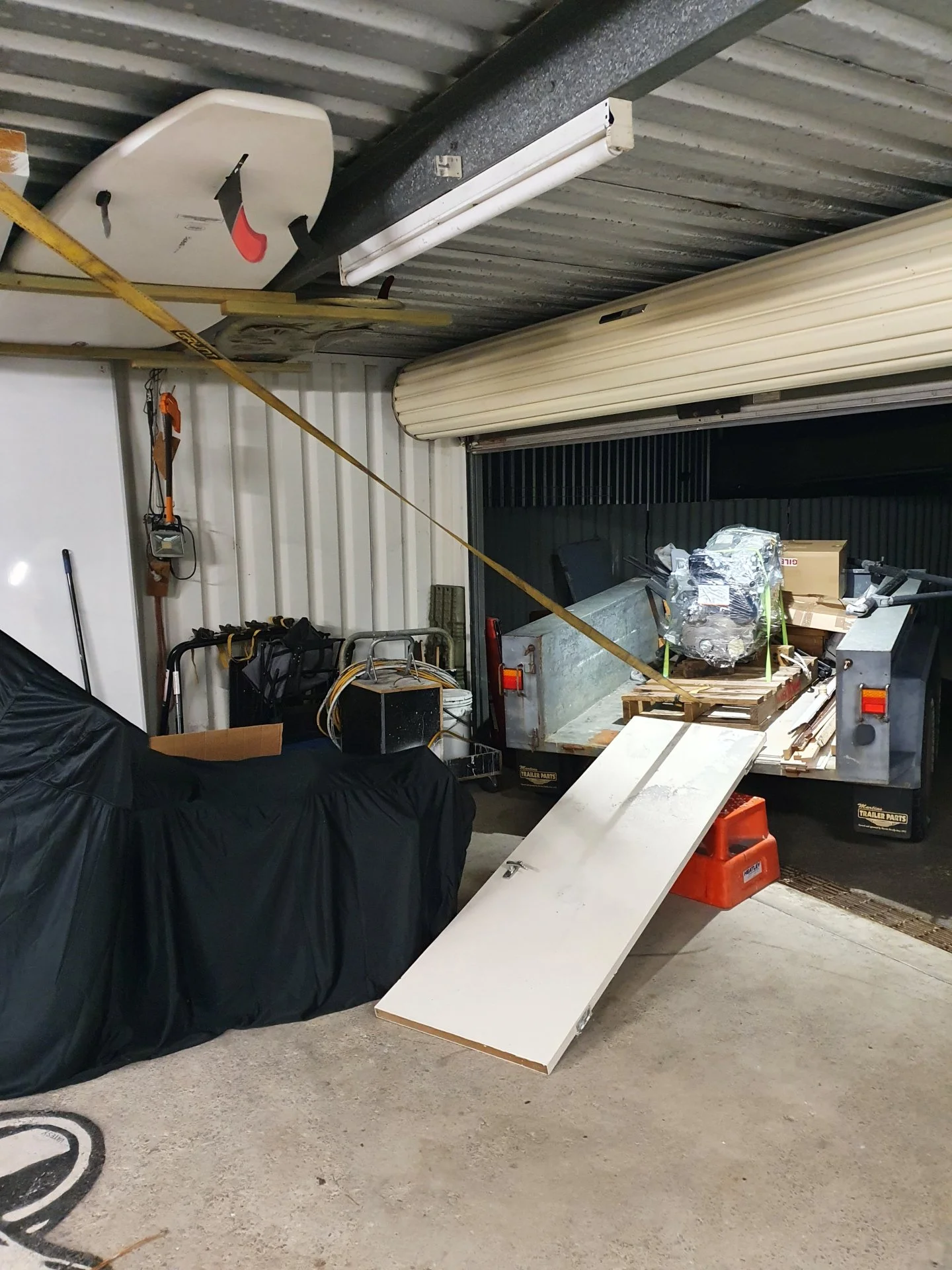

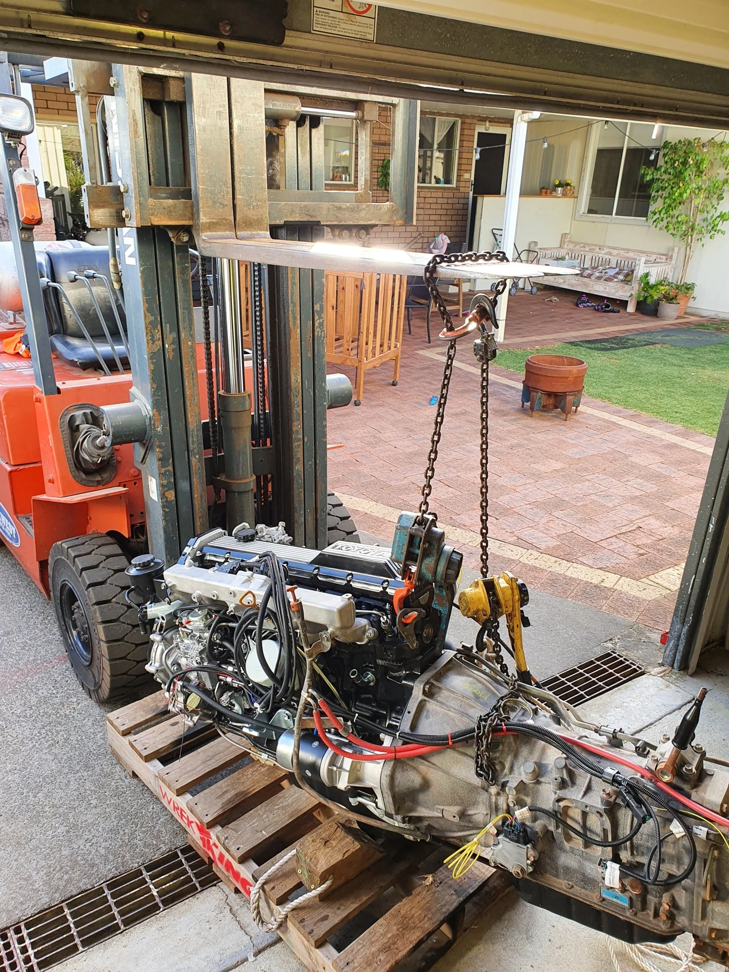

So finally have the new engine, which got delivered last week. life has been a bit busy lately so forgot to come and update you all on the progress. We also got the old 1FZ out and sold (actually sold it weeks ago prior to pulling it) so now I need to mate the trans and engine and get it back in. Then onto to dealing with plumbing and wiring conundrums...
so things have been a bit hectic lately, but we finally got the engine and trans in the car. the missus and I took on another foster bub recently (that makes 4) this little bub is only 9moths old so i'm having some shed/daycare sessions on the tools. shes a quick learner! plus I bought a harley and have been flat out with work, and trying to find a new job where I don't have to work nights. also had my best mates wedding on the weekend, so didnt get much done with a slow head on sunday!

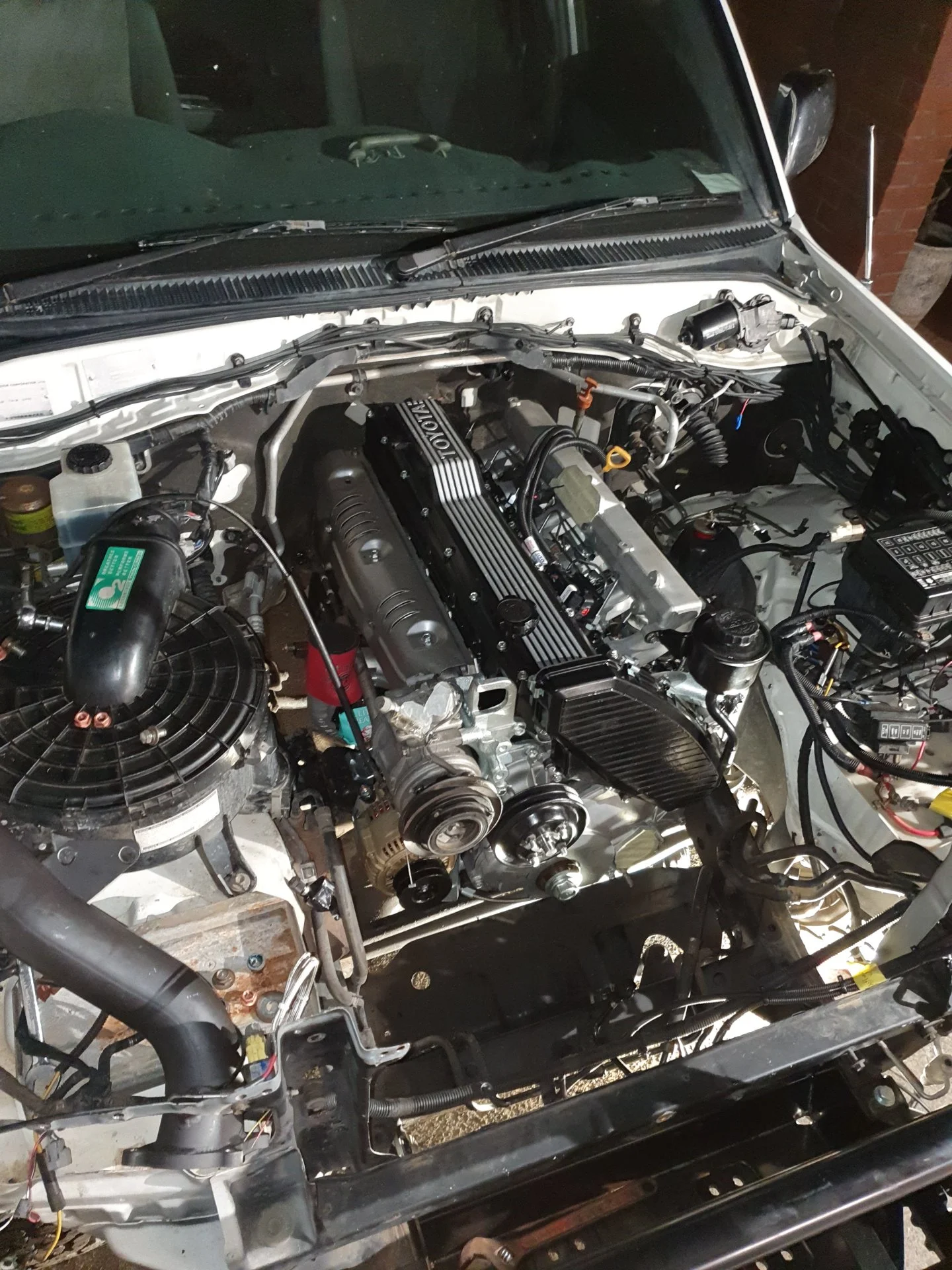

now I have a million and one problems to solve. here's a couple more pics, with more coming soon

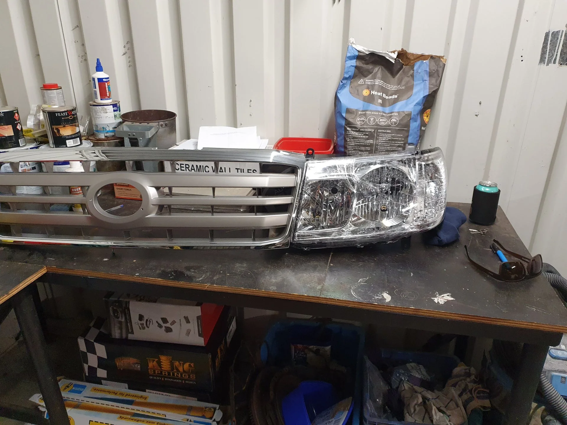

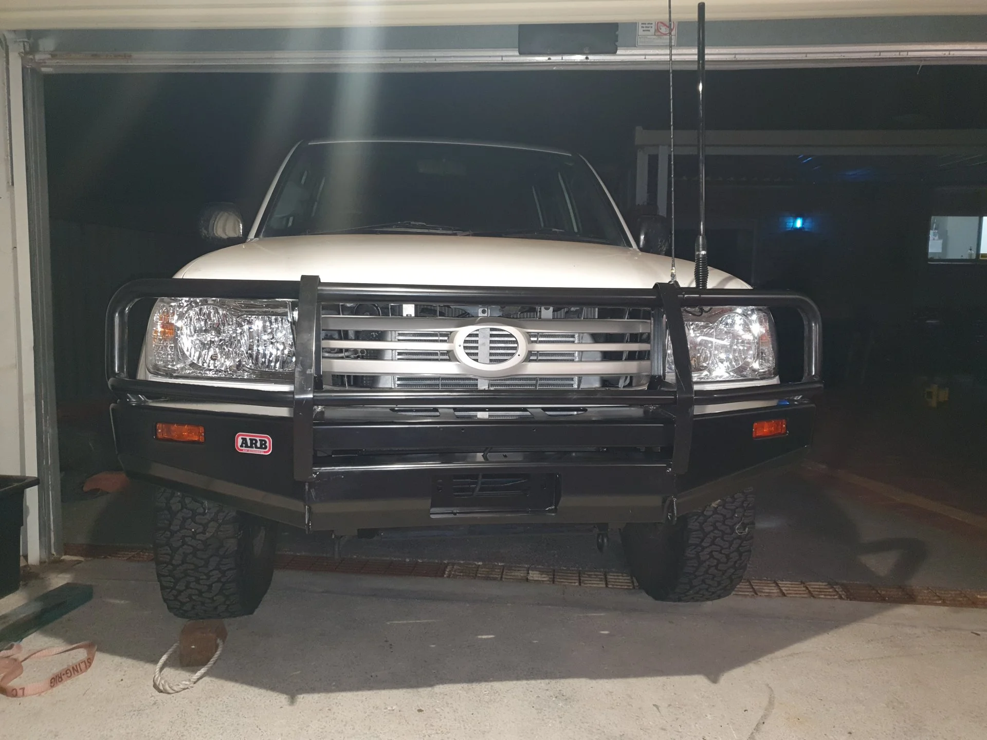

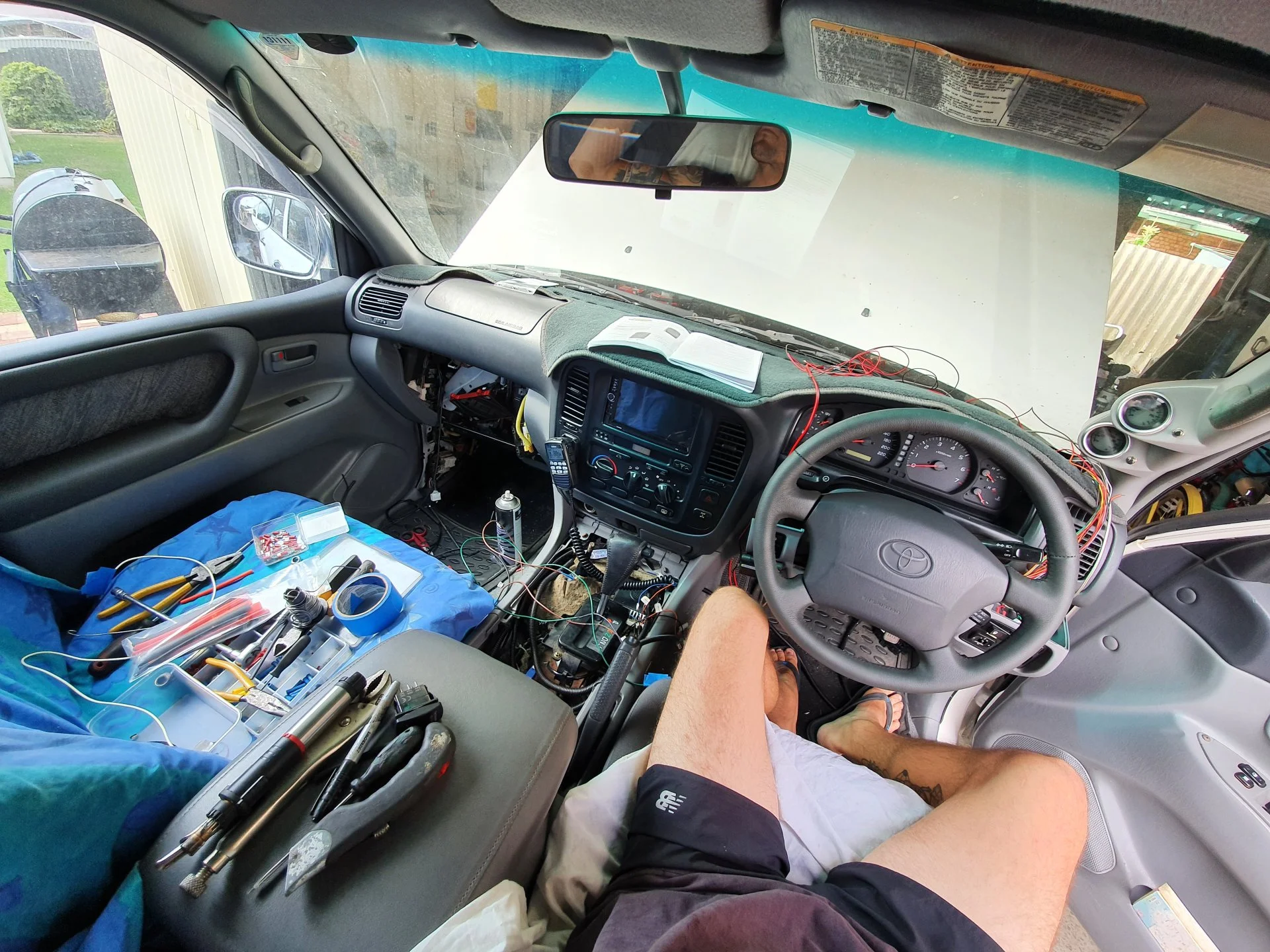

sorry been quiet lately, been doing some moonlit sessions in the shed to get this thing going for xmas, not looking good at the moment stuck on wiring issues. anyways here the the new front end on, and onto the wiring conundrums!
