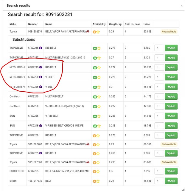

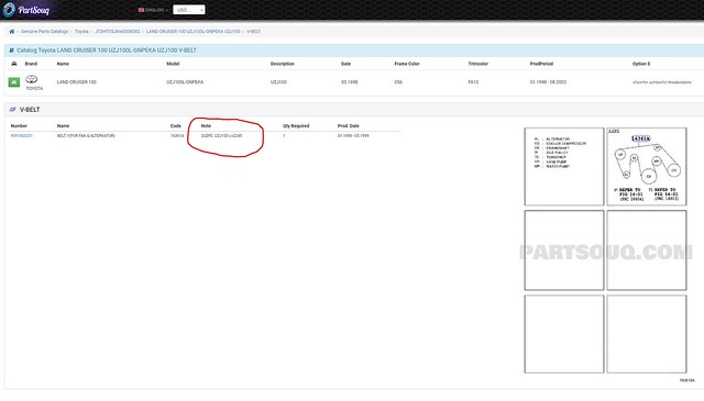

So after talking with Ryan who did my tb/wp service yesterday the serpentine belt is looking a bit on the weathered side. Not something that needs to be replaced immediately but since I will be ordering some stuff in the near future that he also found needs replacing (fan bracket, fan shroud) I might as well throw this in there as well
Now comes the question... looking on Partsouq.com it comes up with three (3) different Mitsuboshi belts as being proper replacements. Talking with him last night about it, basically it comes down to the length of the belt. I was trying to find lengths to see which was the correct for the 1998 LC but cannot seem to figure it out.
Can someone confirm which is proper?
Mitsuboshi
6PK2245, or
6PK2250, or
6PK2255
I am assuming that the last four numbers (22xx) are the length in millimeters, which if I am correct based on the description from Partsouq it calls out the length as L=2245
VBelt confirmation by Greg Fisicaro, on Flickr
VBelt confirmation 2 by Greg Fisicaro, on Flickr
You're correct that the last 4 digits of the part numbers indicate the metric length, the first characters indicate rib count and configuration. The domestic aftermarket brands ( Dayco, Gates, etc.) are showing an 885 standard length as being correct for your application. That would be 88.5" (true measurement of 88.58") which translates to 2,249.932 millimeters, this is closer to the "2250" options. IIRC there were different options for the diameter of the tensioner pulley between some models or part production dates from Toyota, either 90 or 102mm. This may be why you are seeing belt options that have minute differences in length, I honestly suspect either option will work. FWIW, I put a 6PK2245 Contitech on my 05 LX470 in conjunction with a new OE tensioner assembly and had no issues.
From what Ryan was telling me there was slight variations in length for the different 2UZ vehicles... So he thought that the Sequoia used a slightly longer one because of a different pulley on one of the accessories (alt, AC compressor, PS pump) and then there were slight variations between the ones used for the 4Runner vs. Tundra/LC/Sequoia but he was not sure which was which.
I ran the OE number (9091602231) from your Parts OUQ screenshot in Toyota's SimplePart site and came up with some info. The aforementioned number was superseded by 9091602586 and in the above link if you scroll down a bit, it is indicated that 2245mm is the length:
