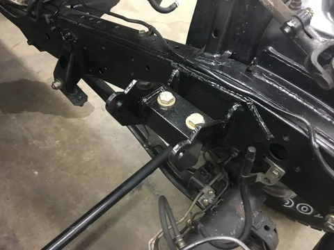

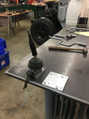

image.webp image.webp image.webp image.webp image.webp Progress is recomencing on the swap! I had to take some time off to add a 20x30 addition onto my shop.
Splitting the motor mounts and making them bolt together is a good idea. Will get you a little more clearance getting in and out with the motor/trans. I have basically same type (but one piece) and it takes some contortions to get everything over the mounts when installing motor/trans/Tcase as a unit. Looking good.
