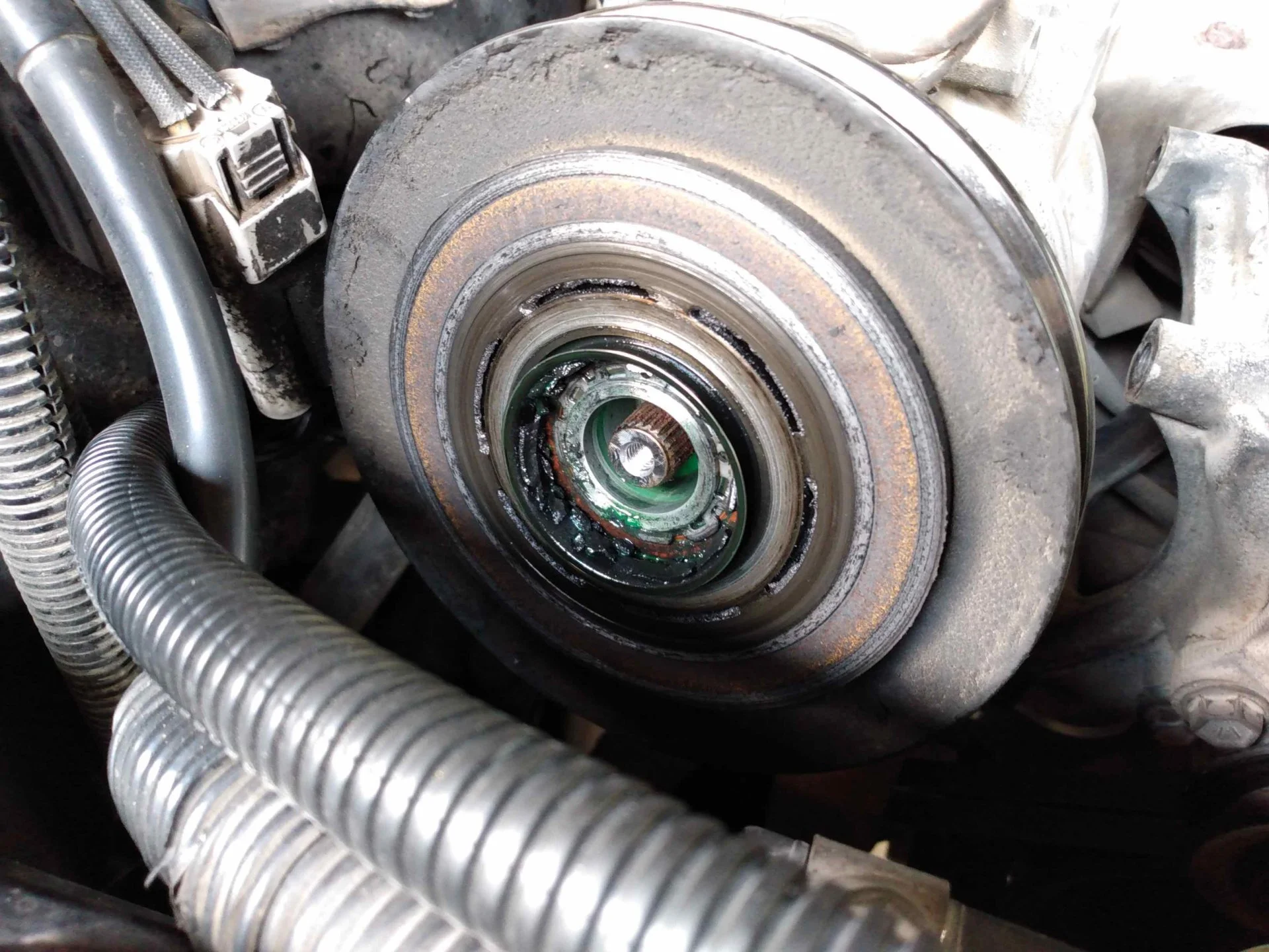

Well, the plot thickens. I got the A/C compressor clutch replacement kit in (includes a new clutch pressure plate, assortment of shims, two snap rings, the pulley wheel with bearings, and a new stator/coil) and went to replace the clutch related components. Once I removed the pressure plate I knew something more involved was up... I found fluorescent green compressor oil in the shaft area (I'm pretty sure the green "goo" is compressor oil, right?).
I'm guessing that means that I have a shaft seal leak? Does anyone know if replacing the shaft seal requires you to de-gas the system (i..e remove the R-12) and separate the A/C compressor unit from the vehicle? Looking at the FSM it looks like you need to remove the A/C compressor unit from the vehicle and start digging down into the unit to replace the various seals. Is this an easy task, or is it better left to the experts?
Below is a picture of what the compressor looks like with the pressure plate removed. You can see the fluorescent green compressor oil near the shaft. The A/C compressor still works well, but like my original post states, I think that the clutch/compressor must be on its way out.
I would highly recommend just replacing the entire unit. Good money after bad here IMO....return the clutch and buy an entire new unit for ~$250. Take it into a shop and have them evacuate the system, replace it yourself (buy a new o-ring kit for $20 and replace all o-rings you encounter), rent a vacuum pump and gauges from an auto parts store and fill it back up yourself. Takes ~4 hours total. Pretty easy to do. If you come by my place when you hit Utah we can do it here....hell it seems like I have a compressor sitting around even because I replaced mine thinking it needed done but it didn't (that wasn't my problem).

However, like my post #7 states, I noticed green compressor oil on the shaft when I was attempting to replace the clutch; this green compressor oil is indicative of shaft seal leak. Like @jellis suggests, at some point in the future I will just need to replace the entire compressor, as it is cheaper and easier than trying to repair bits and pieces of these compressors if they need much more than a new clutch, for example. Thanks to all who helped out.
