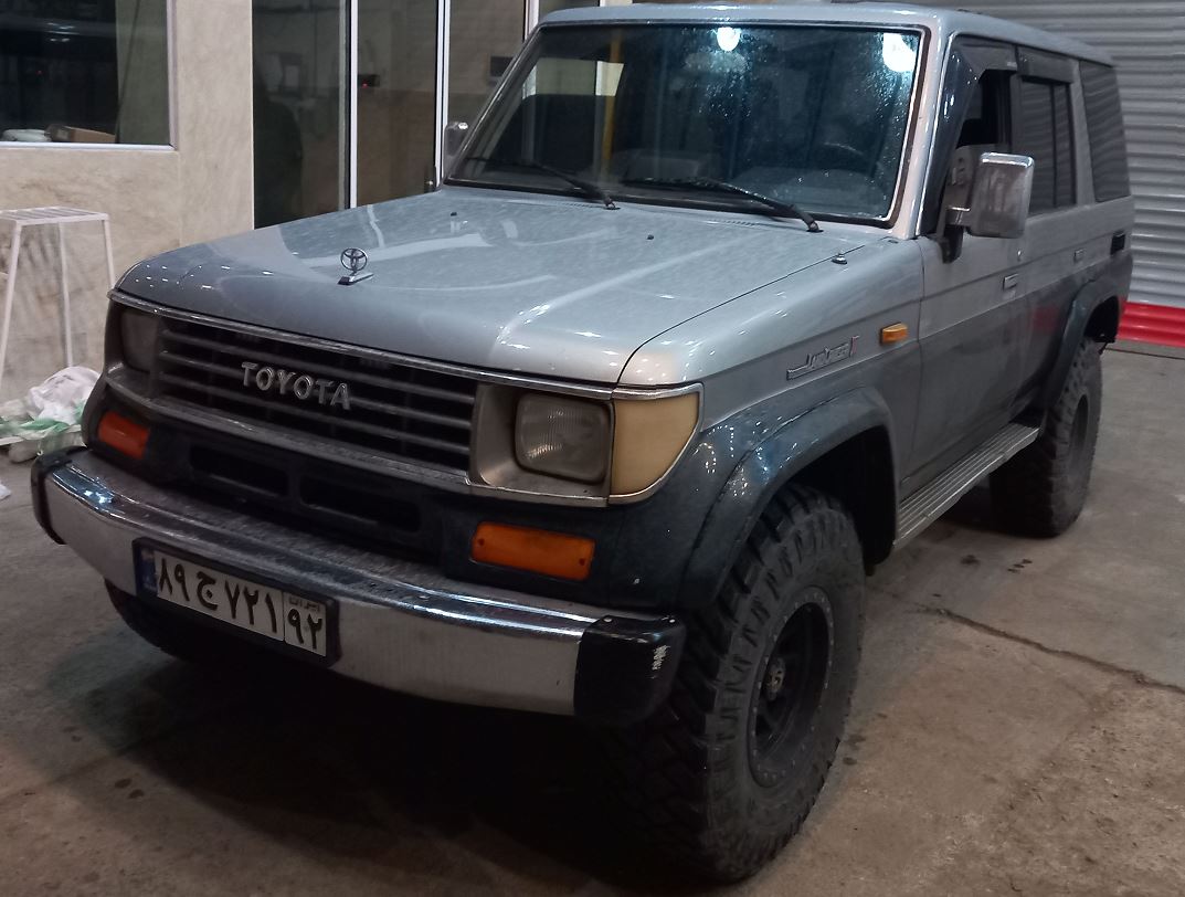

howdy lads
happy to be here and new to the forums
here is a picture of my rj77 that i recently got
poor thing is anything but stock as it went through owners during its life
originally with the 22R previous owners have replaced it with a 3RZ
while the car needs a lot of work i look forward to the day its somewhat complete

Cool! I always thought a 3RZ would not be too bad in one of these. Would enjoy seeing some engine bay pictures of that motor in there!
Have fun with it. Body looks solid.

that's what I was thinking. a popular swap here for the pre tacoma Toyota trucks/4Runners

haha thanks lad:)
the solid body was my main motivation for buying the old girl and engine left good impression on me even if it was a 4cyl (sorry for lack of pictures i will add some later)
i have seen other rj77 owners here turbo charge their 3RZ around here so there is that option if lack of power is felt
btw yours also looks very good, the red is very pretty

thats the previous owners plate before i changed the ownership to myself
