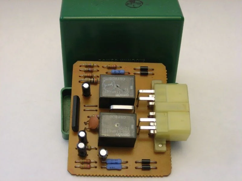

Which window is having the problem?
If it’s driver’s door, another common culprit is the green auto down relay box - the relays crap out. There is a comprehensive thread on replacing them. Takes a soldering station, two $5 relays, and 30 minutes of time.
