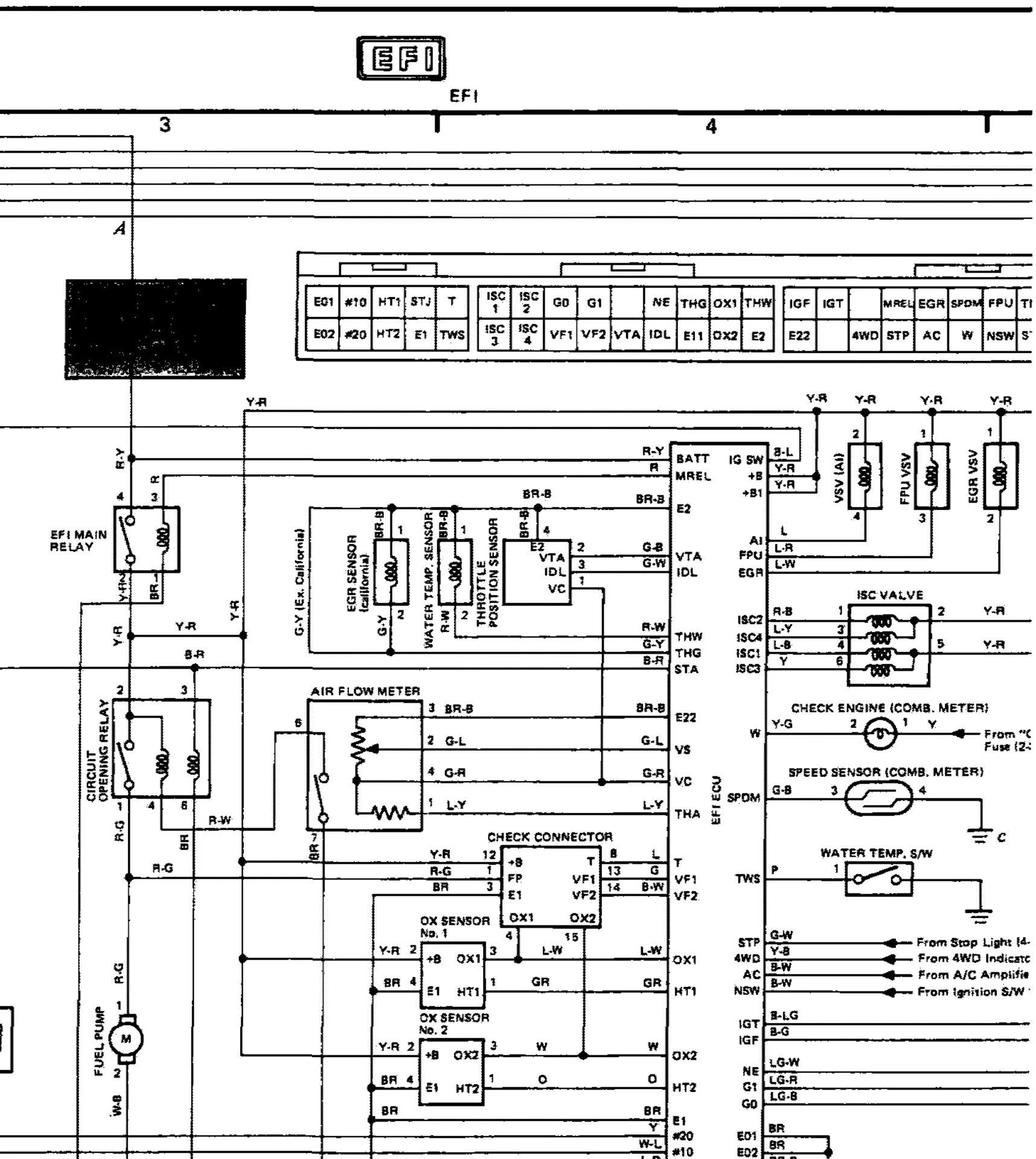

EFI Relay come to mind as something to check. Located on passenger inner fender next to air cleaner.
Connect +B and Fp terminals in diagnostic port to bypass ECU and relay. That will tell you if those are the culprits.

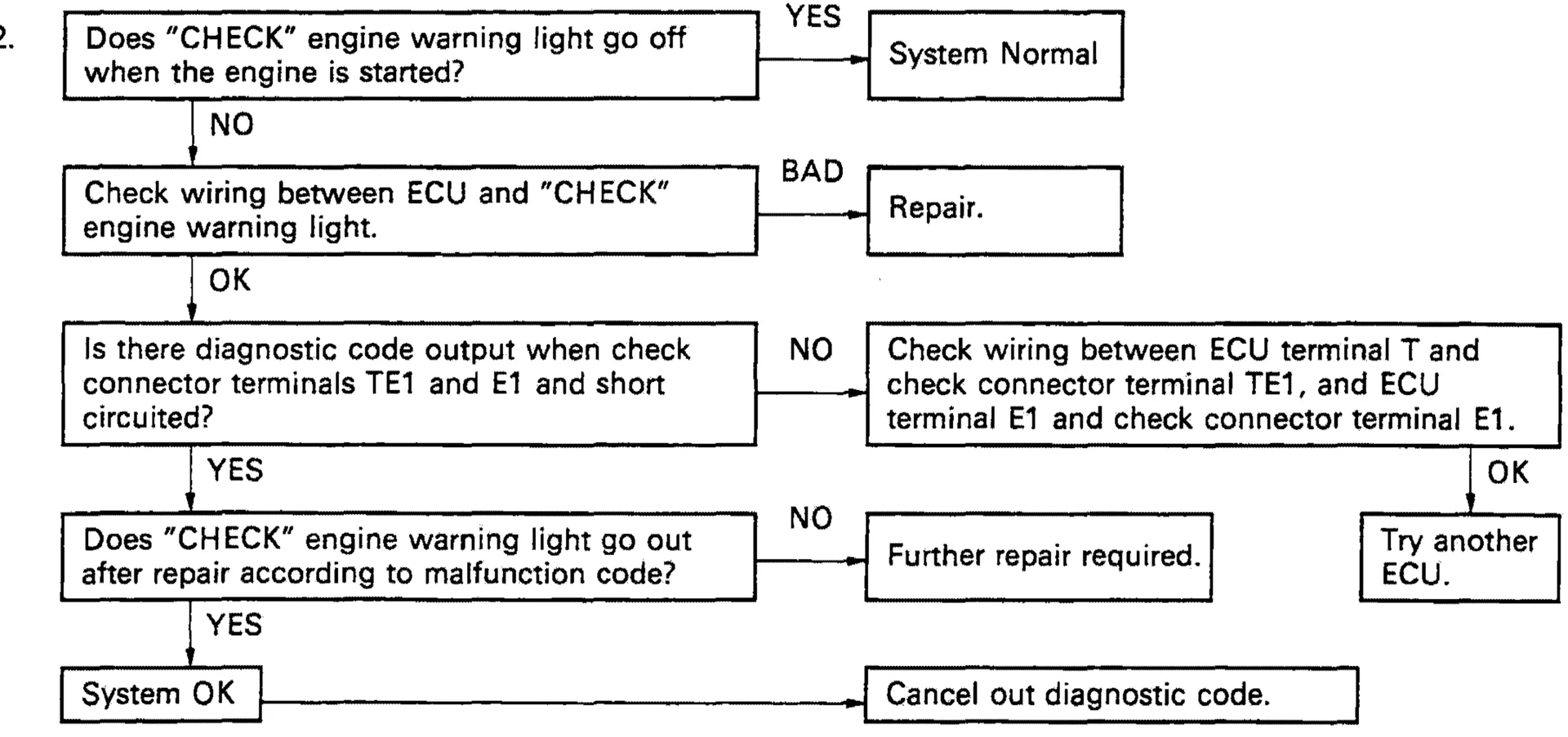

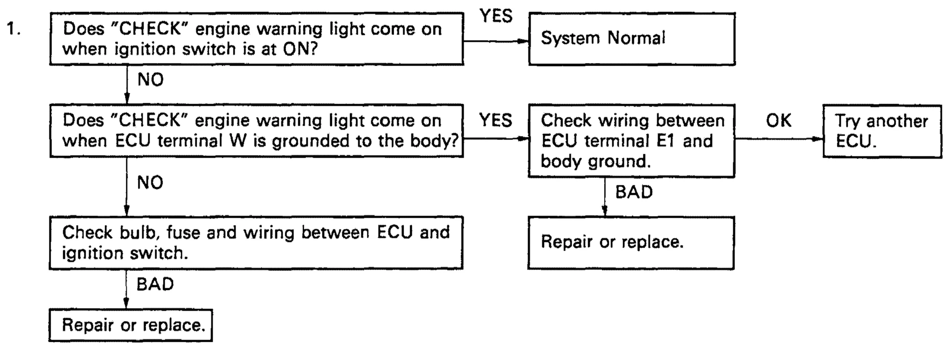

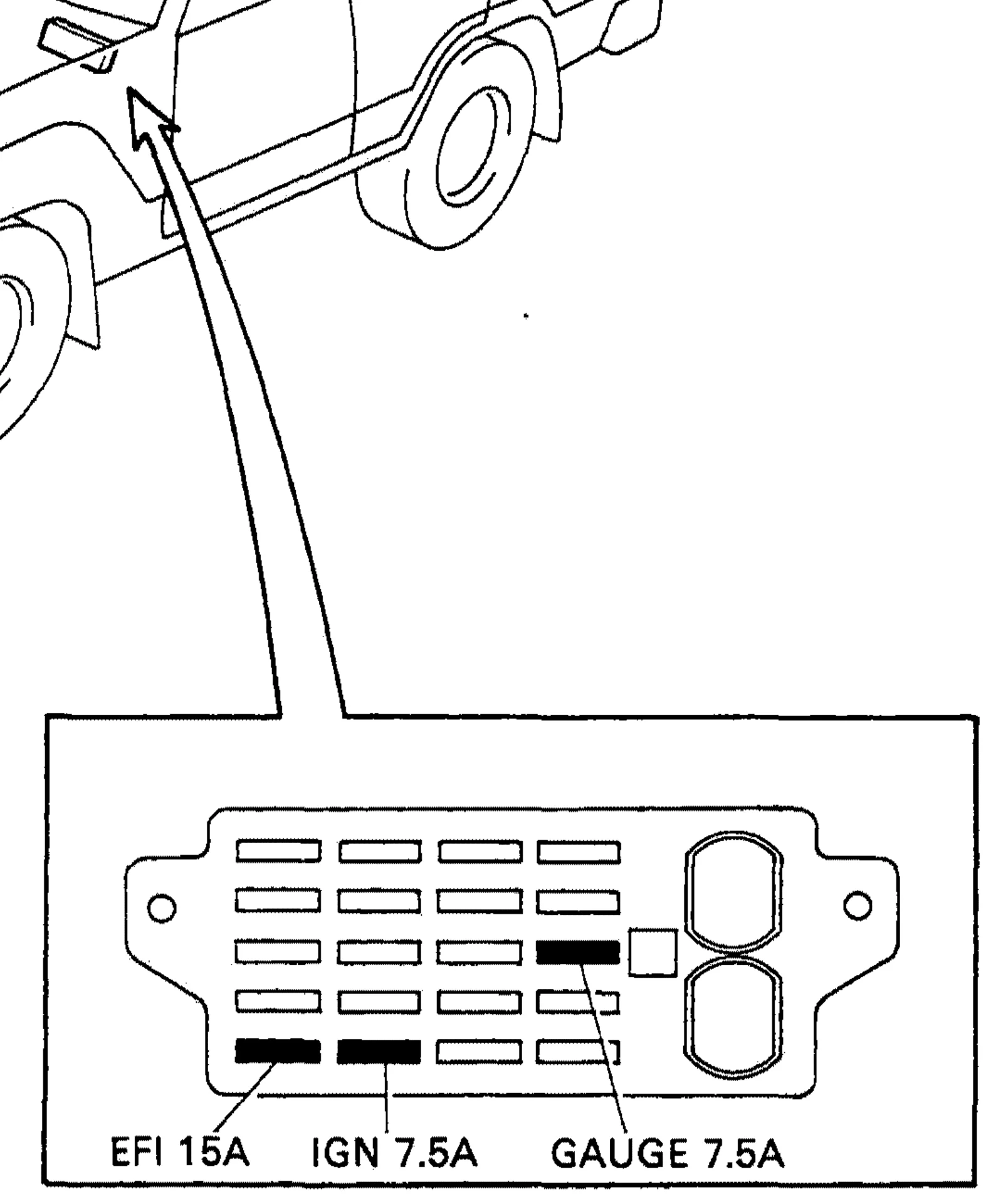

EFI Fuse is something to check. 15 amp at bot left of your fuse block. The FSM has an entire section dedicated to troubleshooting what you are doing with step by step checks.
1955318
Download and start reading the FSM:
1955320
1955321
1955322
