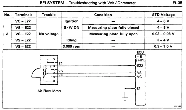

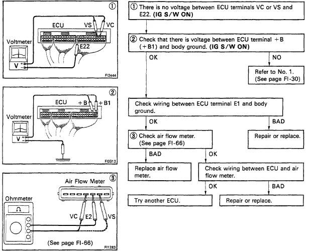

Have you tested your MAF per the FSM?
Do you have a copy of the manual? You are diving into diagnosis that could save you a lot of money instead of buying another one.
message me your email address and I'll link you to the one on my dropbox that you can download.
